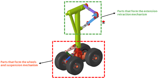

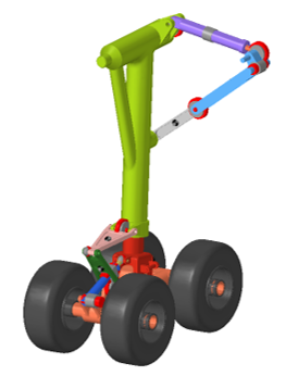

The loaded model will look as shown below. Review the model for its bodies and joints.
The model consists of linkages of the cylinder and piston that hold the wheel as well as linkages for the extension and retraction of the whole landing gear unit within the aircraft body. The model also contains a body defined for aircraft but without graphics. As a first step, you will add a graphic for the aircraft body part for visual representation.
Figure 2. Main Landing Gear Mechanism

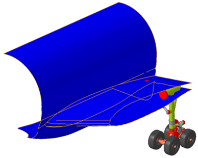

- From the File menu, select the .
- Select the option Import CAD or Finite Element Model Only. With this selection, only the graphics will be imported without creating any bodies.
- For Input File, select HyperMesh.
Click Input File
and select
Aircraft_Structure.hm as the input file.
- Click OK.
The H3D file is generated and the graphic is imported.
Figure 3. The Model after Importing a Graphic for the Aircraft Body

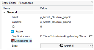

From the modeling window, go to the Graphics and select
the just-added graphic g_Aircraft_Structure_graphic.
The Entity Editor for the aircraft structure graphic is displayed.Note: If the Entity Editor is not visible, right-click on the entity in the browser and click Show Properties.
In the General section:

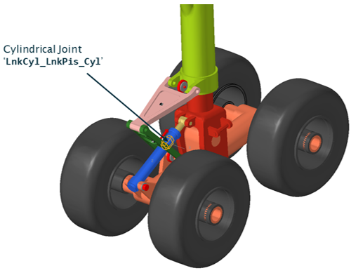

Similarly, add another motion and name it
Aligning_Motion. Resolve the Joint collector to the Cylindrical Joint LnkCyl_LnkPis_Cyl defined between the MLG Cyl and MLG Pis bodies (see the image below).Figure 8. Cylindrical Joint - LnkCyl_LnkPis_Cyl

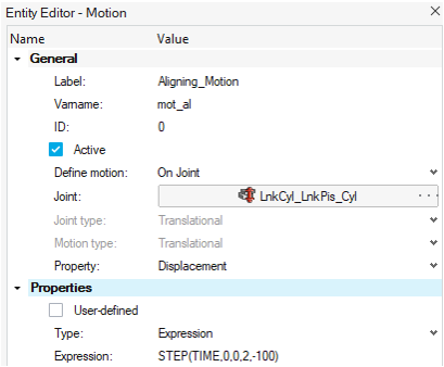

From the Properties section of the Entity Editor,
select Type as Expression. In the Expression field, enter
the expression
`STEP(TIME,0,0,2,-100)`.Figure 9. Aligning Motion Entity Editor

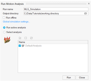

- Click on Default Analysis in the Model Browser and specify End Time as
10seconds. - From the Run Motion Analysis dialog, specify the Run name
as MLG_Simulation and the Output
directory. Click Run.
Figure 11. Run Analysis

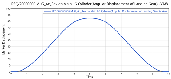

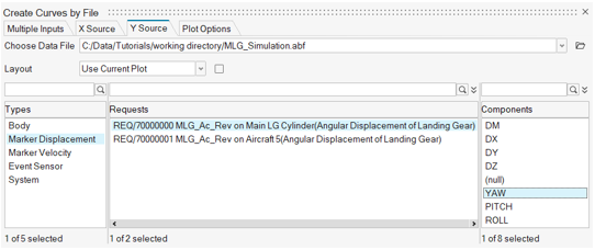

- Once the solution is complete, click Plot on the Run Status dialog, to launch HyperGraph. The Create Curves by File dialog is automatically displayed.
- Select Marker Displacement > REQ/70000000 MLG_Ac_Rev on Main LG
Cylinder(Angular Displacement of Landing Gear) > YAW for
Y Source.
Figure 12. Plot Angular Displacement of Landing Gear
Figure 13. Angular Displacement of Landing Gear Plot

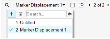

- From the top right corner, click Add a Page to open a new
page in HyperGraph.
Figure 14. Add a New Page
- Click Open Plot

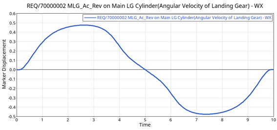

. - Select Marker Velocity > REQ/70000002 MLG_Ac_Rev on Main LG
Cylinder(Angular Velocity of Landing Gear) > WX for Y
Source.
Figure 15. Angular Velocity of Landing Gear Plot
