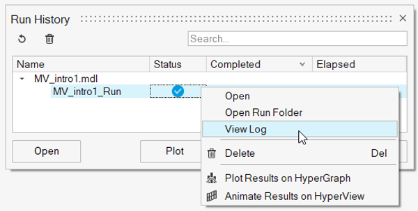

From the Ribbon bar, select Analyze and click on the
Run History satellite next to the Run icon from the
Solution group.
Figure 1. Run History Satellite Icon
Note: The ‘Run History’ maintains the history of all runs per model. Model and results for the previous runs can be accessed through this tool.Expand the entry for the current model, right-click on the Run name MV_intro1_Run and click View Log.Figure 2. View Solver Log

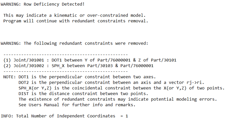

The solver log gets loaded in the text editor. Observe that there are two redundant constraints identified in the model.Figure 3. Solver Log Showing Two Redundant Constraints
Each joint imposes a set of constraints or removes one or more degrees of freedom of the bodies based on their type. More details on the number of degrees of freedom removed by each joint type is available in the Joints topic. The current configuration of joints combined are such that there are more constraints than the total number of degrees of freedom in the model. MotionSolve is designed to detect redundant constraints and automatically remove them so that a unique solution can be found, and the simulation can proceed. However, such a simulation may:- Provide undesired or unexpected results.
- Mechanism lockups or simulation failures.
The recommended best practice is for you to review the model and remove the redundant constraints on your own. In the next steps, we will try to change the joint configurations to ensure that no redundant constraints are present.

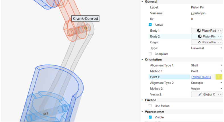

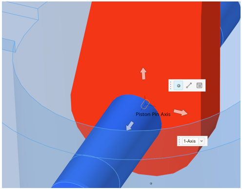

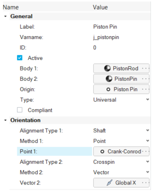

Change the joint Piston Pin using the Entity Editor.
- Select the joint in the Model Browser.
- Change the Type to Universal.
- Under Orientation, change Alignment Type 1 to Shaft.
- Change Method 1 to Point.
- Activate Point 1 collector (below Method 1) and pick the Crank-Conrod point from the modeling window.
Figure 4. Changing Piston Pin to Universal Joint
The Entity Editor after the change should be as shown in the below figure:Figure 5. Entity Editor of Piston Pin After Changes

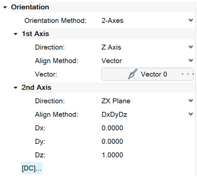

Add a Bushing.

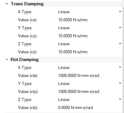

Modify bushing properties using the Entity Editor.
Set the Trans Damping and Rot
Damping properties.
Set Value (cx, cy, cz) under Trans Damping to
10 N-sec/mm. -
Set Value (ctx, cty) under Rot Damping to
1000 N-mm-sec/rad.
Figure 10. Damping Properties of Bushing

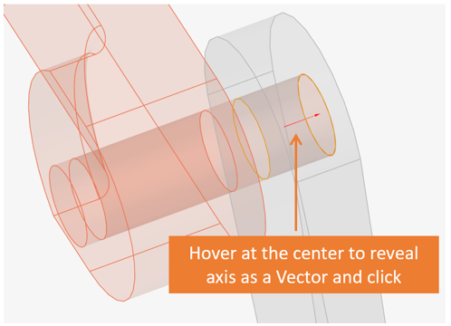

Change the cylindrical Crank-Conrod joint to a Compliant
joint.

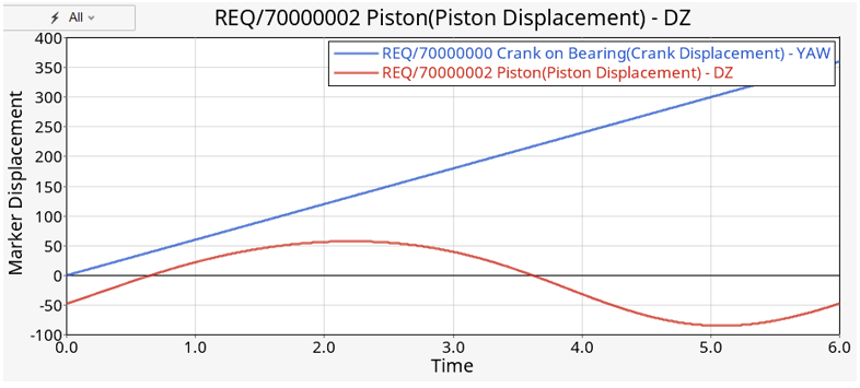

Run Model and Review Outputs
- Run the model using the Run icon.

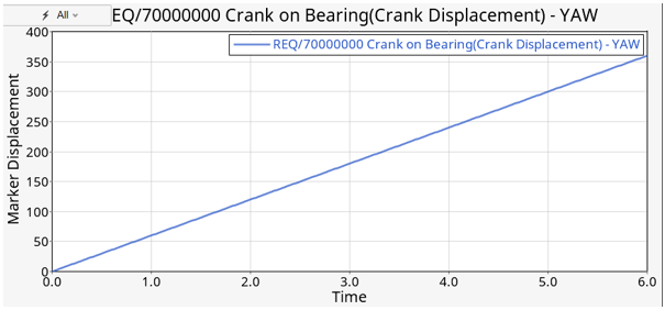

- Once the run is complete, click Plot in the Run Status dialog.
In the HyperGraph page, Create Curve by Files
dialog (Y Source Tab), select the following:
- Types: Marker Displacement
- Requests: Crank on Bearing (Crank Displacement)
- Components: YAW
Figure 15. Crank Displacement Output
Note: YAW is the component that holds rotational displacement about Z axis. The graph shows crank displacement changing from 0 to 360 degrees in 6 seconds. -
Similarly, plot the piston displacement using the following choices:
- Requests: Piston (Piston Displacement)
- Components: DZ
Figure 16. Piston Displacement Output
