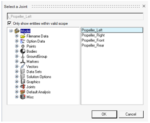

Click on the ellipsis
next to the Joint collector to access the advanced
selections dialog. Select Propeller_Left and click
OK.
Figure 2. Select a Joint Dialog

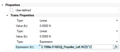

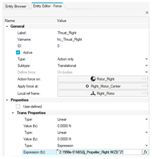

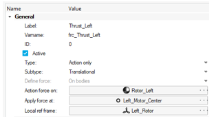

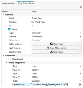

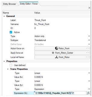

To represent the wind effect and thrust of the quadrotor, a set of forces and moments must be defined.
The wind disturbance is represented as a combination of torques in the X and Y axle applied at the vehicle center.
The thrust of each propeller is represented as a Z force following this equation:
Where,
= Thrust force
= Thrust factor (Defined considering the propeller geometry, air density, m and spin area. For this analysis Tf= 2.1998e-5).
= Propeller Angular velocity
Create the wind disturbance force.
Create the thrust force.

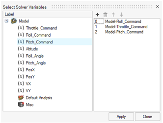

- The individual plant input solver variables were already defined with the propellers motion in Specify the Velocity of the Propellers. They are Throttle_Command, Roll_Command and Pitch_Command.

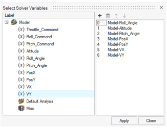

Next, you will define the individual plant output values, which are Altitude,
Roll Angle, Pitch Angle, X position, Y position, X velocity and Y
velocity.

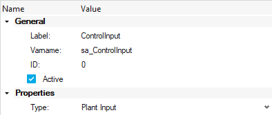

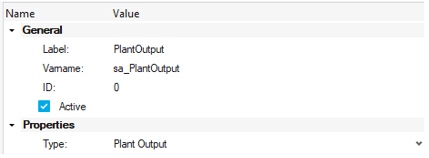

Create two solver arrays, ControlInput and PlantOutput, to communicate with
Twin Activate.

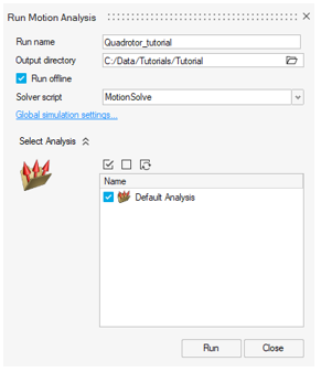

Run the MBS Model in MotionSolve for Verification
From the Analyze ribbon, click on Analysis settings
next to Run, to open the Run
Motion Analysis dialog.
- Select the Run offline option.
- Rename the Run name input to Quadrotor_tutorial.
- Select an Output directory folder, where the results will be save and click on the Run button.
Figure 23. Run Motion Analysis Window
Click Results to animate the simulation results and
confirm that the model works as intended before continuing to the next
step.

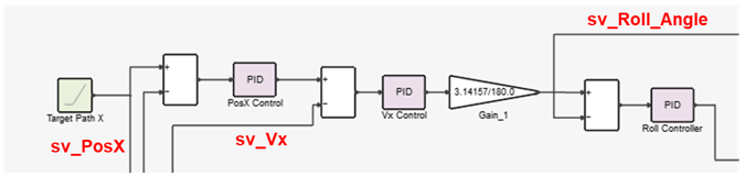

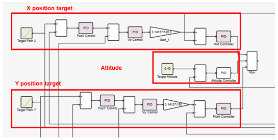

The system has 3 sections of control: Altitude of the quadrotor, X position and Y position. The X and Y position control is defined by a target path, for this model it is a slope of 0.025.
Figure 24. System’s Three Control Sections
These three sections of controls defined by seven PIDs are the plant input for the MBS model. In MotionView, it's defined as Roll_Command, Throttle_Command and Pitch_Command.
The plant output, Roll_Angle, Altitude, Pitch_Angle, PosX, PosY, VX, and VY, are input for the PID controls.
For example, in the X position target control, you will see three inputs which come from the plant output (PosX, VX, and Roll Angle).Figure 25. X Position Target Control Section

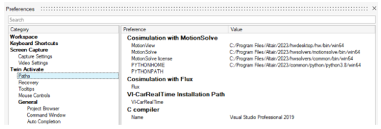

To enable co-simulation between Twin Activate and
MotionSolve, from Twin Activate, select . In the dialog that is displayed, define the MotionSolve and MotionView
license paths.
Figure 26. Twin Activate Preferences

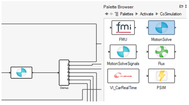

From the Palette Browser, select , and drag-and-drop the MotionSolve
block into the current diagram and connect the blocks.
Figure 27. MotionSolve Block Inclusion

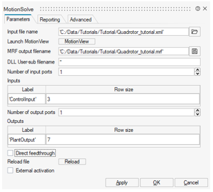

From the diagram, double-click the MotionSolve block. From the dialog that
is displayed, define the following block properties:
The following parameters are populated automatically after you load the input model, *.mdl or *.xml:
- Inputs Row Size: The value 3 indicates that three signals are supplied from Twin Activate to the MotionSolve model. These signals correspond to the solver array PlantInput, with variables Roll_Command, Throttle_Command and Pitch_Command.
- Outputs Row Size: The value 7 indicates that the MotionSolve model is sending out seven signals
from one port, which is why the Demux block is added to separate the
signals. The signals correspond to the solver array PlantOutput with
variables Roll_Angle, Altitude, Pitch_Angle, PosX, PosY, VX and VY.
Figure 28. MotionSolve Loaded Model’s Parameters Ribbon
Figure 29. MotionSolve Loaded Model’s Advanced Ribbon

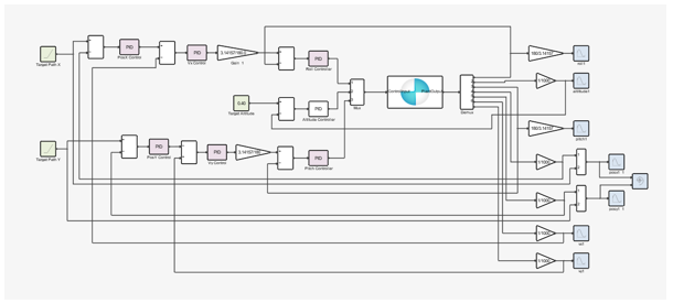

Click and drag to connect the output of the block Mux to
Control Input of the MS Plant. Similarly, connect the Plant Output end of the MS
Plant to the input end of Dmux. All required blocks are
now present and connected in the modeling window.
Figure 30. Twin Activate Co-simulation Model Diagram

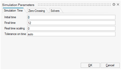

From the ribbon's Simulate tool group, select the Setup
tool. From the
Simulation Parameters dialog, in the Final Time field,
enter 12 so that your simulation runs for twelve
seconds.
Figure 31. Simulation Parameters
Note: Since Twin Activate is the main, or calling, solver in this co-simulation scenario, if the simulation end time in Twin Activate is different than the MotionSolve simulation end time, the MotionSolve simulation end time will be modified at run time to match the end time specified in the Twin Activate dialog above. -

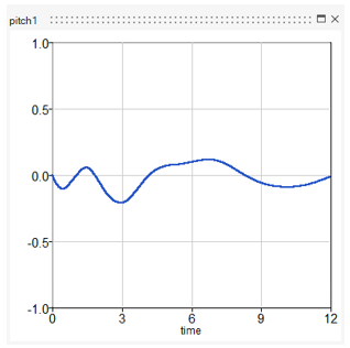

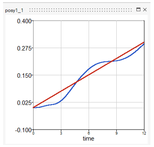

From the ribbon, click Run

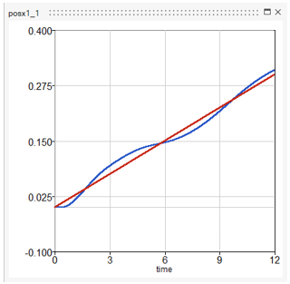

The Scope blocks in the model generate the following plots, which illustrate the altitude, roll, pitch, x position, y position, and the path.Figure 32. Altitude
Figure 33. Roll
Figure 34. Pitch
Figure 35. X Position
Figure 36. Y Position
Figure 37. X Velocity
Figure 38. Y Velocity
Figure 39. XY Path

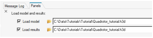

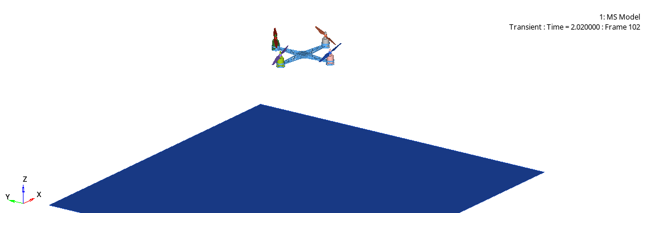

Launch HyperView and animate the
Quadrotor_tutorial.h3d file to see the quadrotor
behavior.
Figure 40. Load H3D File in HyperView
