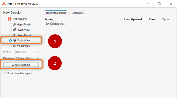

In Windows, click OR using the Altair ConnectMe app (if installed).
Once invoked, the launcher window appears as shown in the image below.
Figure 1. Launcher Window
- Select MotionView and create a new session.

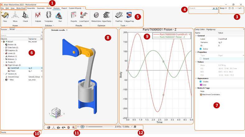

Figure 2. Interface Elements
MotionView is organized into these various areas:- The Title Bar displays the name of the session file as well as the active product version.
- The Menu Bar provides access to Ribbons, standard functions such as file management operations, system preferences, help, and configuring the visibility of various areas of the interface. You can also change the active product from the menu bar.
- The Pages and Windows can be changed to control the main display area. Each page can have up to 16 windows.
- The Search allows you to quickly find various tools and functionalities that are also available from the ribbons.
- The Ribbon allows you to quickly access tools and standard functions and is located along the top of MotionView. Click on an icon to open the related tool. Hovering over a group of icons may reveal additional tools.
- The Model Browser lists various entities of a model in a tree-based format. A context sensitive menu allows you to perform various actions like copy/paste, hide/show, and so on, on each node of the tree.
- The Entity Editor lists all the properties of the selected entity.
- The Modeling Window displays the model while it is being setup, as well as animates the same during a solver run (MotionSolve only) and results review. This also contains other interactive areas like the Guide Bar, Microdialog, Toolbelt, and Entity Selection Filter.
- The Client Window allows you to work with other clients like HyperGraph, HyperView, and so on, side by side.
- The Status Bar about the currently loaded model and lists the status of MotionView at any point of time like Ready, Importing Geometry, and so on.
- The View Controls allows you to control the view and display of the model in the modeling window.
- The Animation Controls allows you to review the animation of a model after a run.

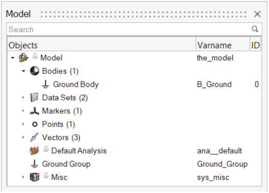

Observe the default contents of the model from the Model Browser.
Figure 3. Model Browser
Note: Each entity folder in Model Browser can be expanded or collapsed to see its content and has a count of entities contained in the same within the () parenthesis. For example, there is a Ground Body by default in the Bodies folder. Ground Body does not move during a simulation. -

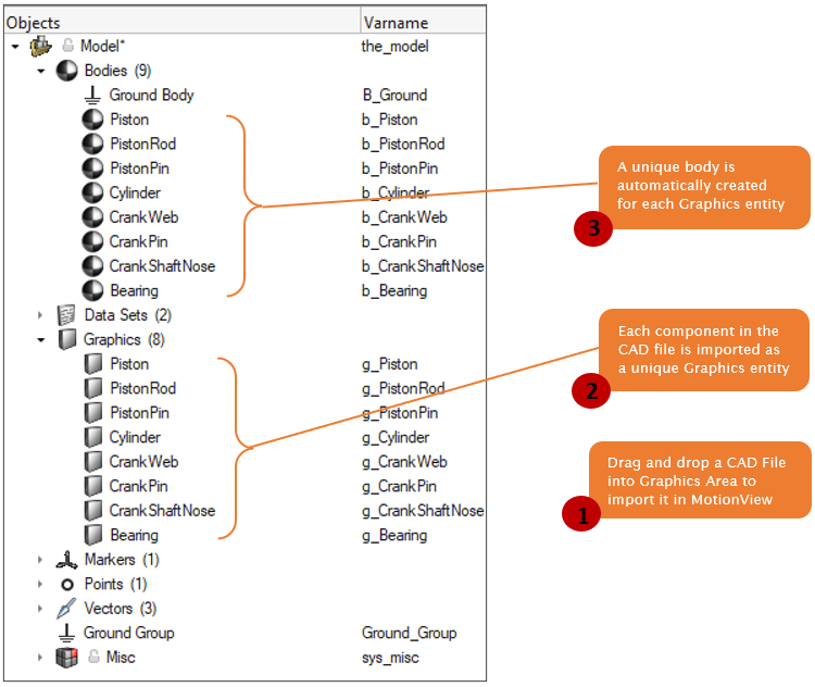

Observe the Model Browser. It shows eight Bodies (other than Ground Body) and eight Graphics entities. When a geometry is imported, each CAD component is represented with a Body entity and a corresponding Graphic entity of type CADGraphics.- A Body entity represents mass and inertia.
- A Graphic entity is a geometrical object used for visualization and while solving a contact problem.

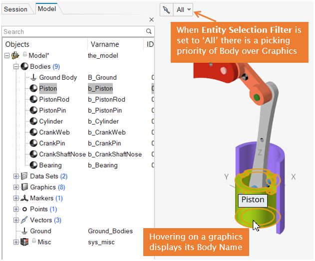

In the modeling window hover on the
Piston (component in green in the image below). The
object is highlighted along with the object label appearing in a bubble text.
Click on the object and notice that the body gets selected.
Figure 5. Picking from the Modeling Window

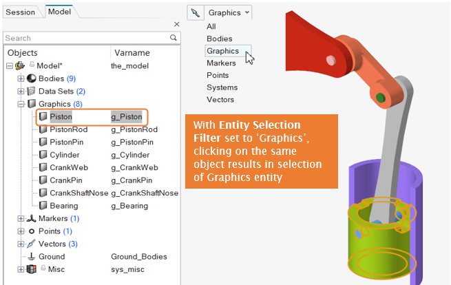

Change the Entity Selection filter (available on the top
left of the modeling window) from
All to Graphics and again
click the same “Piston” object on the screen.
Figure 6. Using Entity Selection Filter
Note: This time the Graphics entity has been selected (indicated in the Model Browser). - Double-click the empty space in the modeling window to deselect everything.
- Revert the Entity Selection filter to All.

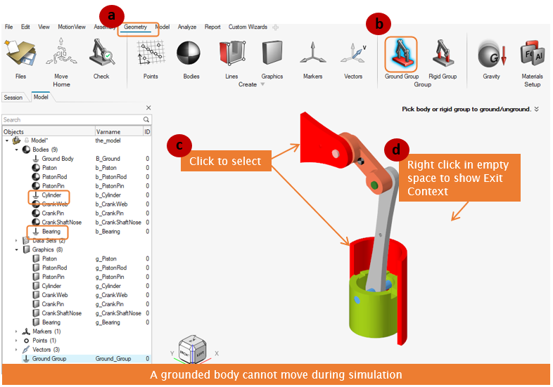

Ground the Bearing and Cylinder bodies.
Figure 7. Grounding Bodies from Ground Group Context
Note:- Using a Ground Context can be useful when there are multiple bodies to be grounded or un-grounded.
- A body can also be grounded using the Ground option in the right-click context menu of the body.
- Observe the Ground Group in the Model Browser. Selecting this group highlights all the bodies that have been grounded.
- When a body is grounded, the entities that have the grounded body as a parent are moved to the Ground Body during solution.

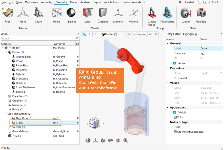

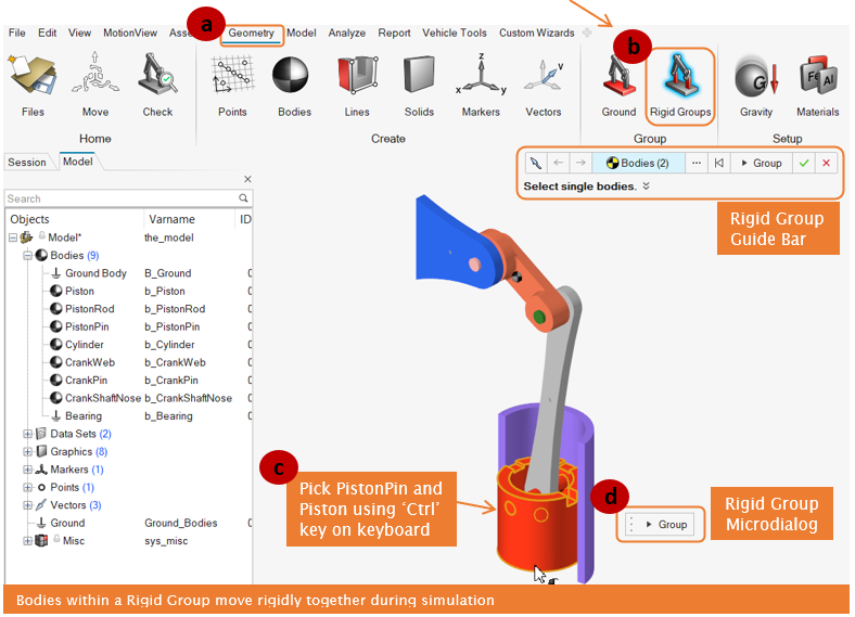

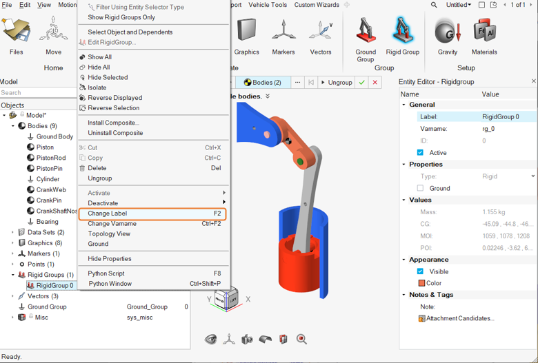

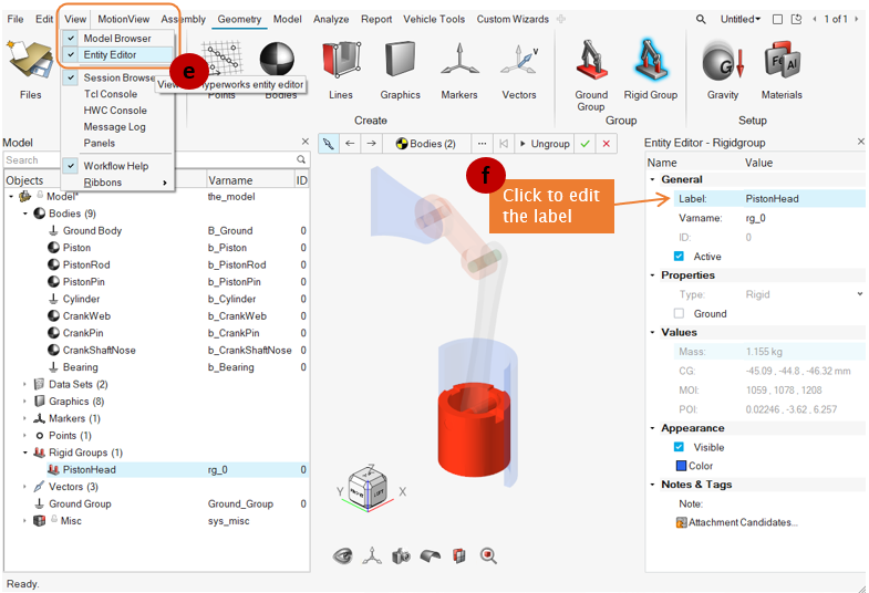

Set up the PistonHead Rigid Group.
A Rigid Group is a collection of bodies that are assumed to be rigidly connected with each other. The concept is like Ground Group, except that a Rigid Group is collectively represented and treated as one rigid body during solution.
Set up another RigidGroup containing the following three bodies:
CrankWeb, CrankPin, and
CrankShaftNose. Rename the
RigidGroup to ‘Crank’.
Note: Refer to the previous step - Step 2(2) for detailed instructions.
Figure 11. Creating Crank RigidGroup
Exit the Rigid Group context by clicking
Finish Editing twice.
OR
Right-click in the modeling window to select the green check mark
to exit the RigidGroup context. -

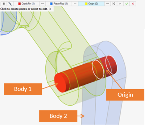

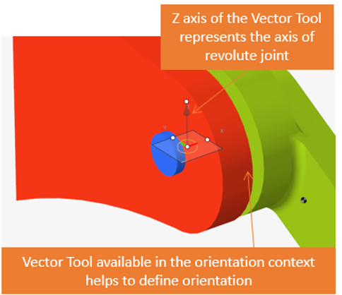

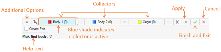

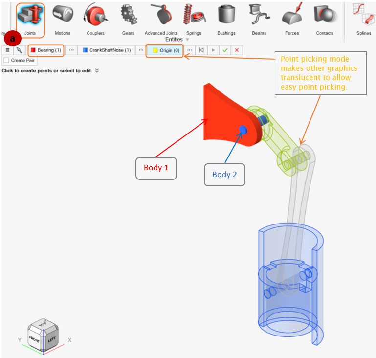

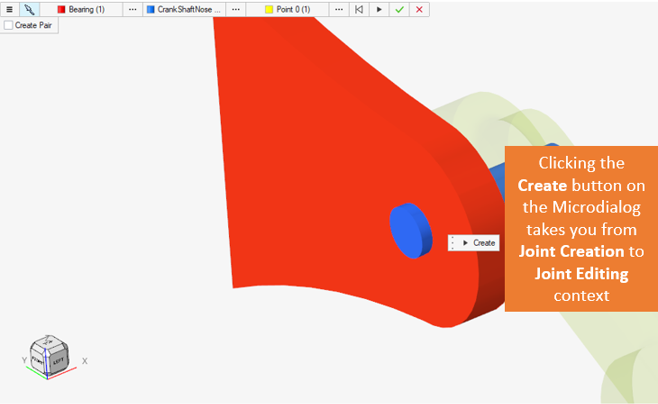

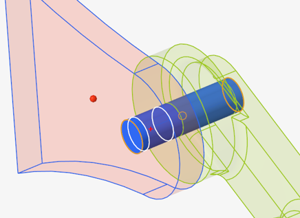

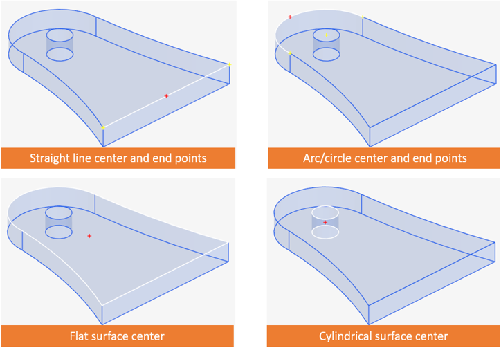

Create a revolute joint between Bearing and Crank.

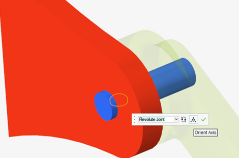

Create a revolute joint with CrankPin as Body 1,
PistonRod as Body 2, and the inner surface center of
Crank Boss as Origin of the joint. Choose
Global X as orientation direction for the
joint.
Figure 21. Revolute Joint between CrankPin and PistonRod

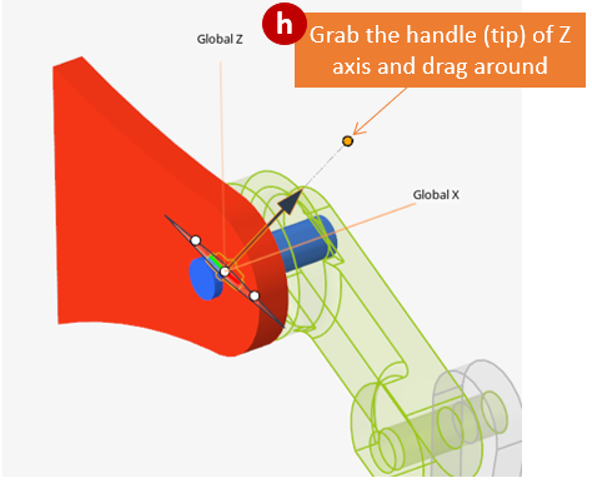

Note: Follow the same procedure for orientation as in the previous joint. -

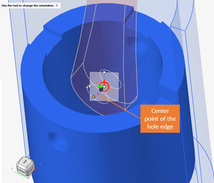

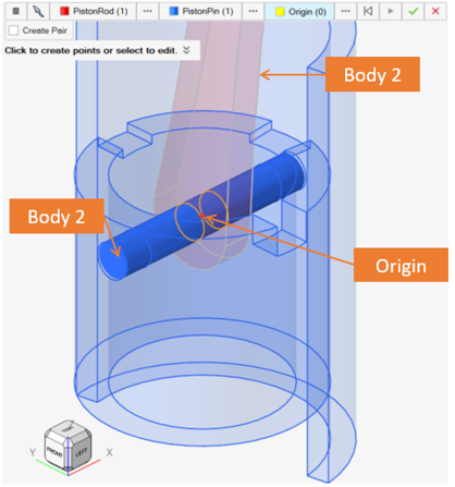

Create another revolute joint with PistonRod as Body 1,
PistonPin as Body 2, and the surface center of the
PistonRod hole as Origin of the joint.
Figure 22. Revolute Joint between PistonRod and PistonPin

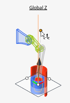

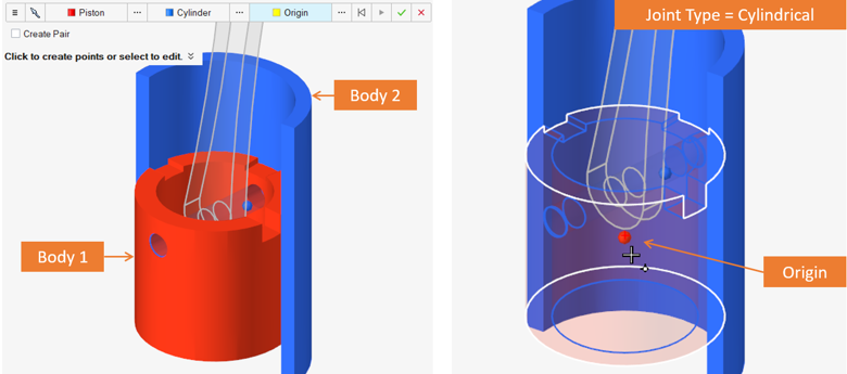

Create a cylindrical joint with Piston as Body 1, Cylinder as Body 2, and the
outer surface center of the Piston as Origin of the joint. Choose Global Z as
orientation direction for the joint.
Figure 24. Cylindrical Joint between Piston and Cylinder
Figure 25. Orientation Axis for the Cylindrical Joint

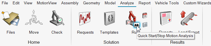

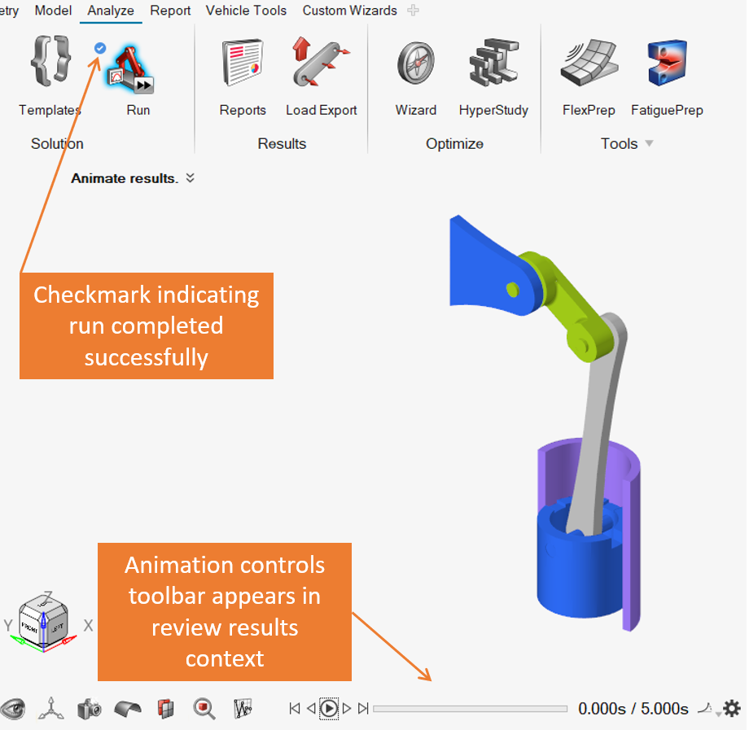

Run a transient analysis for 1 second.
From the Ribbon Bar, select Analyze and click on the
Quick Start/Stop Motion Analysis button from the
Solution group.
Figure 26. Perform a Quick Run
Note: MotionView performs a model check and then submits a run to MotionSolve. The motion of the model can be viewed in the MotionView window as the solution progresses. There are no forces defined in the model, still the parts move as they fall under default gravity.The Run Status dialog opens showing the status of the current run in progress.Note: Once the run is finished, a blue check mark appears near the Run icon in the ribbon indicating that run has been completed successfully and a result is available with the model. After the run, the mode is set automatically into Results Review Context indicated by the blue highlight on the Run icon.Figure 27. Review Run Results Context

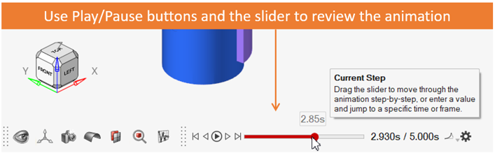

Use the Play/Pause button or drag the slider to review a
specific animation time frame.
Figure 28. Animation Controls
Note: Animated post-processing features in the MotionView client are limited. -

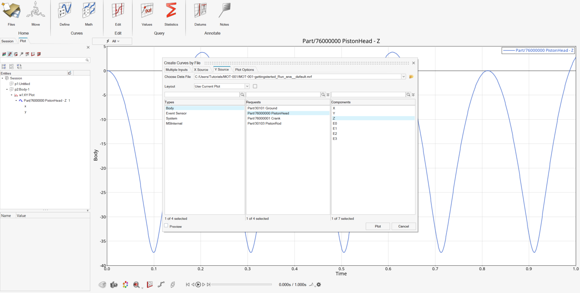

Create a plot.
- Click on the Plot button available on the Run status dialog (or right-click on the run entry and select “Plot Results on HyperGraph” from the context menu).
A new page with HyperGraph client is added to the session and Create Curves by File dialog appears. The MotionSolve result file (*.mrf) is pre-selected. -
Plot a curve that represents displacement of a Piston along the Cylinder.
- Select Body from the list of Types.
- Select the Part/76000000 PistonHead from the list of Requests.
- Select Z from the list of Components.
- Click Plot and then Cancel.
Figure 29. Plot a Curve in HyperGraph

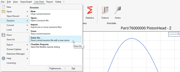

From the Menu Bar, click .
Figure 30. Saving a Session
- Select the working directory and save the session file as MV_Getting_Started.mvw.

to Point. Use the edge center point of
Pistonrod hole as shown below. A new point
