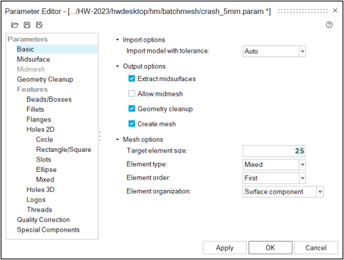

From the Basic tab of the Parameter Editor dialog,
navigate to the Mesh options section, set Target element size to
2.5, and click Apply.
Figure 3.

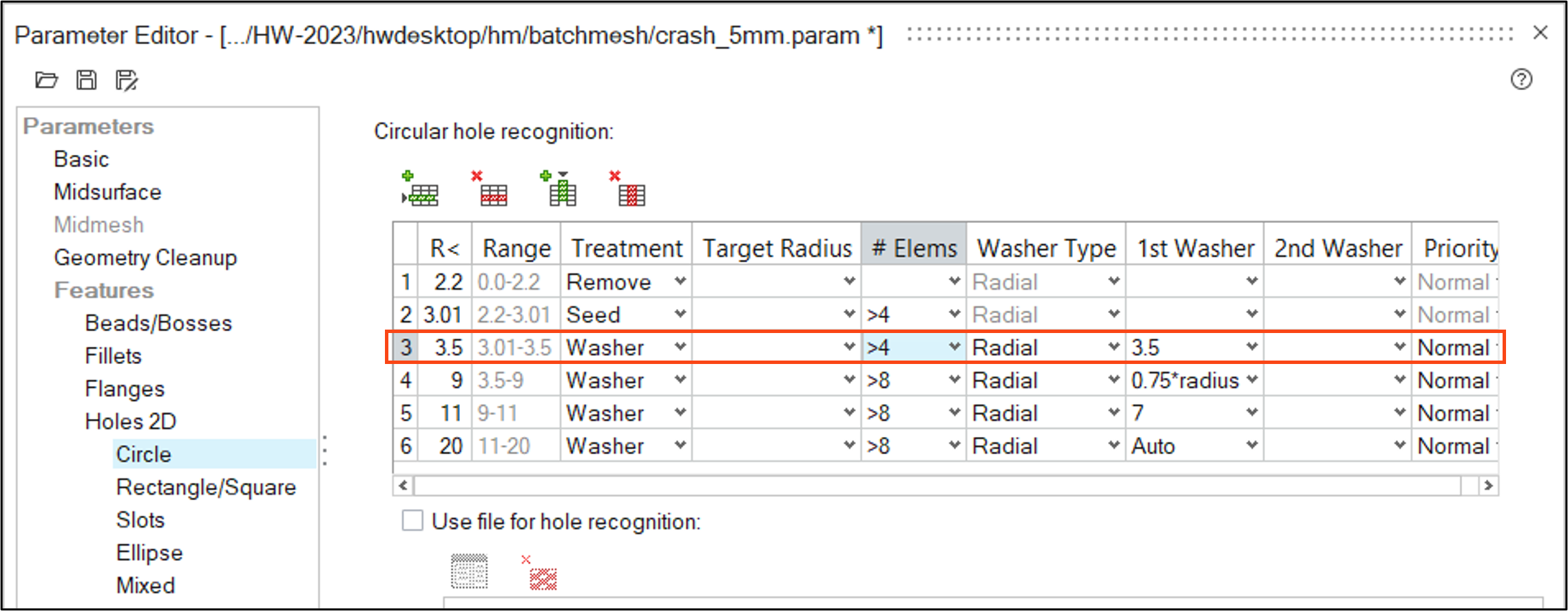

From the tab of the Parameter Editor dialog, set #
Elems to >4 as shown in Figure 4.
Figure 4.
Tip: Before changing the settings, use the Measure tool to measure the radius of the hole. -

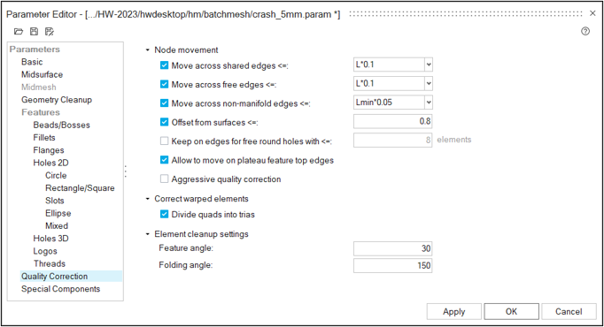

From the Quality Correction tab of the Parameter Editor
dialog, configure the Quality Correction settings.
- From the Node movement section, verify that the Move across shared edges <= check box is selected and that it is set to L*0.1.
- Verify that the Move across free edges <= check box is selected and set it to L*0.1.
- Select the Move across non-manifold edges <= check box and set it to Lmin*0.05.
- From the Element cleanup settings section, change Feature angle to 30.
Figure 5.

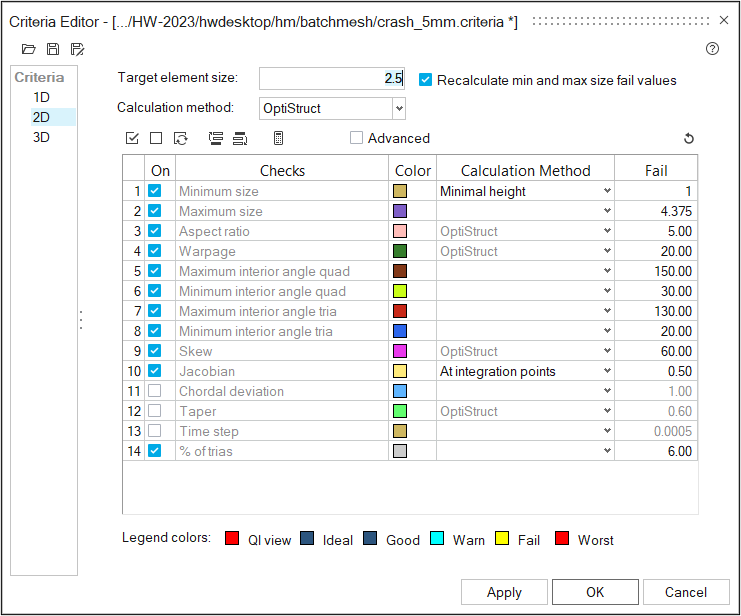

From the 2D tab of the Criteria Editor dialog, change
Target element size to 2.5 and click OK to apply and close the dialog.
Figure 7.
Note: With the Recalculate min and max size fail values check box selected, failed values will automatically be updated based on Target element size.

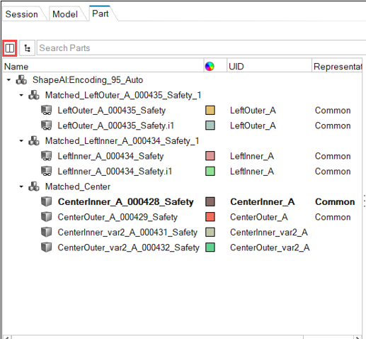

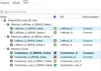

- From the Assembly ribbon, select the Parts tool to open the Part Browser.
From the Part Browser, click
to
enable Part Set View and check the assembly structure.
Figure 12.

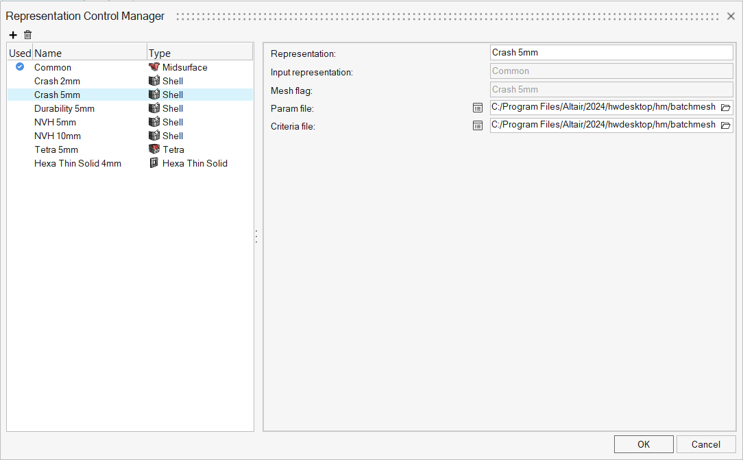

From the Assembly ribbon, click the
Controls tool to open the Representation
Control Manager dialog.
Figure 13.
From the Crash 5mm tab of the Representation Control
Manager dialog, review the Input representation field.
Figure 14.
Tip: Click
to open the Criteria or Parameter Editor. - Click OK to confirm and close the dialog.

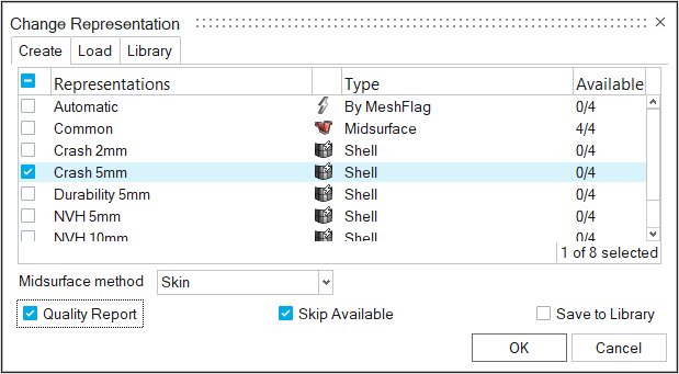

- From the modeling window, right-click and select from the context menu.
From the Create tab of the Change Representation dialog,
select the Crash 5mm representation.
Figure 16.
Note: To create Shell representation(s) if the Common representation is not available, select a method to be used for extracting from the CAD representation. The default method is Skin. -
Clear the Save to Library check box and click
OK.

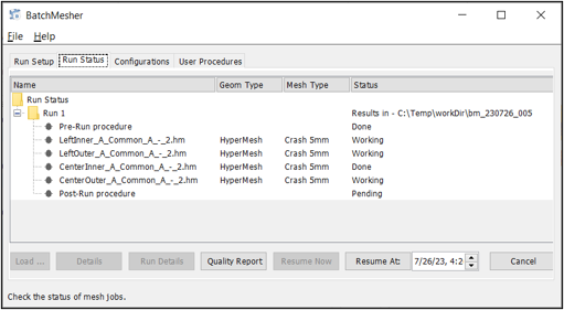

Note: Select the Quality Report check box if you want to access to quality report at the end of the BatchMeshing process.The BatchMesher window appears. All representations are sent to BatchMesher for processing in parallel.
Figure 17.
- From the BatchMesher dialog, check the status of the job.
When the job finishes, click Yes from the

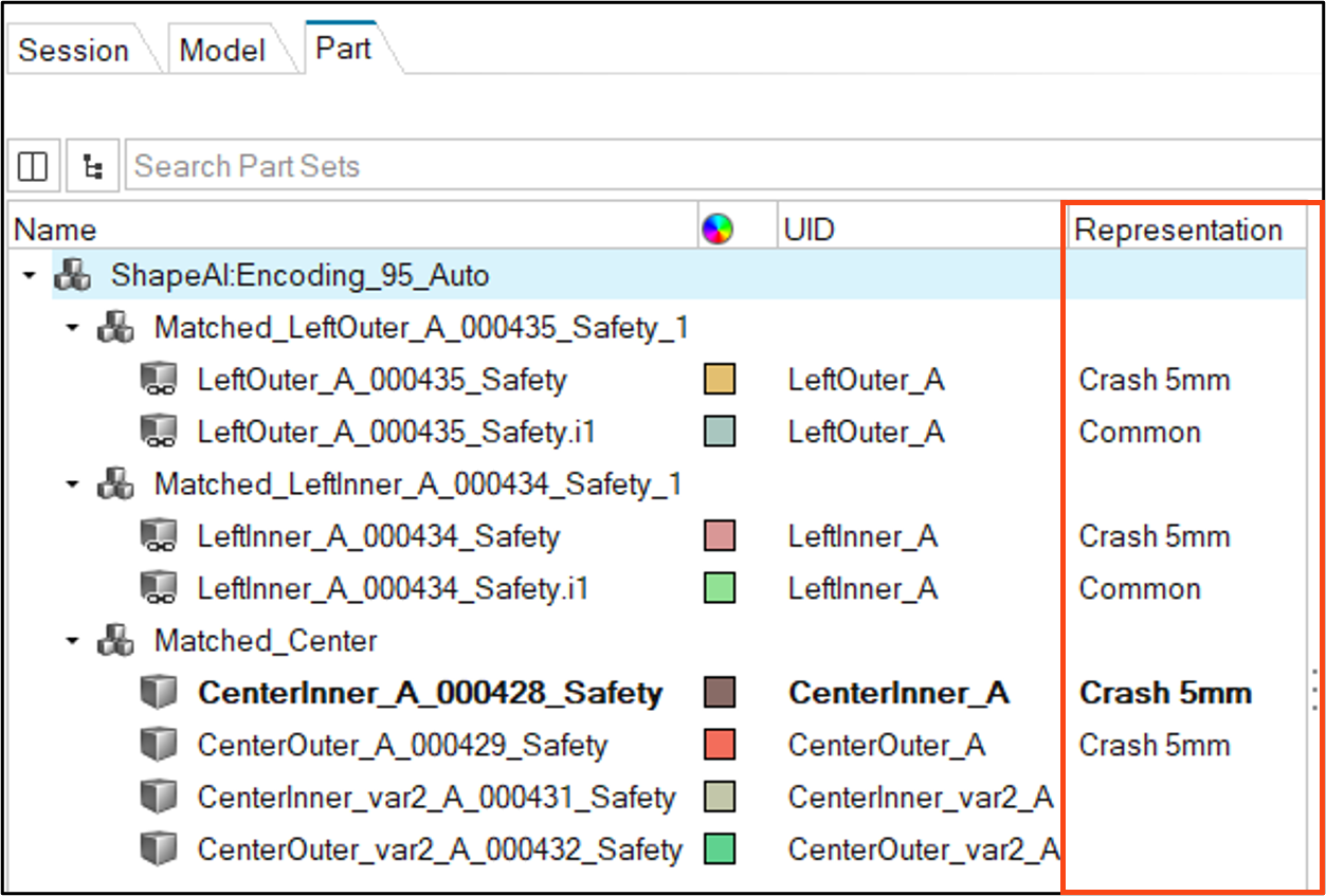

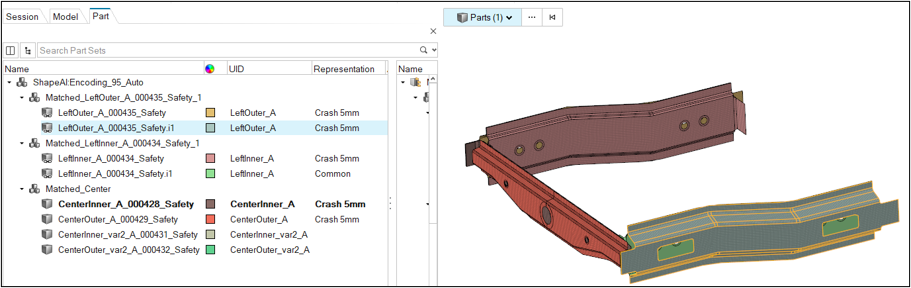

From the Part Browser, review the Crash 5mm representation
under the Representation column.
Figure 18.

- From the Part Browser, select the LeftOuter_A_000435_Safety part under .
- Right-click and select from the context menu.
From the Instance Sync dialog, select All
Loaded.
The Crash 5mm representation will appear for the symmetric part.
Figure 19.

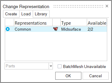

From the Change Representation dialog, select the
Common representation and click OK.

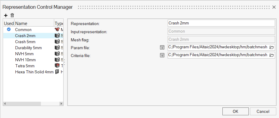

Control Manager.
Figure 21.
From the Representation Control Manager dialog, review the
Crash 2mm control and the Input representation field.
Figure 22.
Tip: Click
