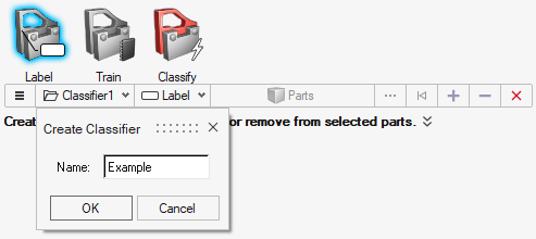

Create a Classifier
From the Assembly ribbon, click the tool (see Create or Update Classifiers and Labels
for more information on this tool).
From the guide bar, select the
Classifier drop-down menu and select
Create New to create a new classifier.
A new folder, named after the classifier, is created in the following directory: C:\<user_profile>\Documents\Altair\Altair_AI\Classify. All files related to the classifier are stored in this folder.

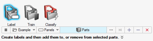

Create Labels and Assign to Parts
- Click Ctrl+O to open the yaris.hm model.
From the
guide bar, select the Label
drop-down menu to create a new label named Panels.

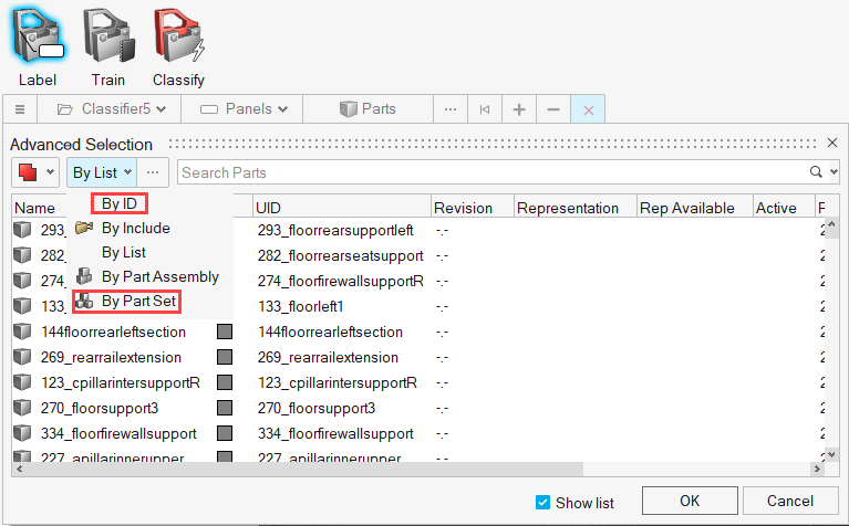

From the guide bar, click Parts Advanced
Selection,
, to select the following parts to be labeled using
one of the following methods:
- By ID (copy and paste the following part IDs: 206, 212, 310, 312, 352, 386, 388, 402, 412, 484, 508, 518, 644, 650, 652, 660, 696, 702, 710)
- By Part Set: Select the Panels part set.
Figure 4.
After selecting the parts, from the guide bar, click
to
label them as Panels.
After assigning labels to parts, a legend is displayed and colors the part based on the labels. The legend indicates the number of parts from the current model that have been labeled.If you have labeled additional parts by mistake, select them and click

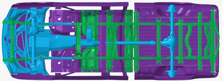

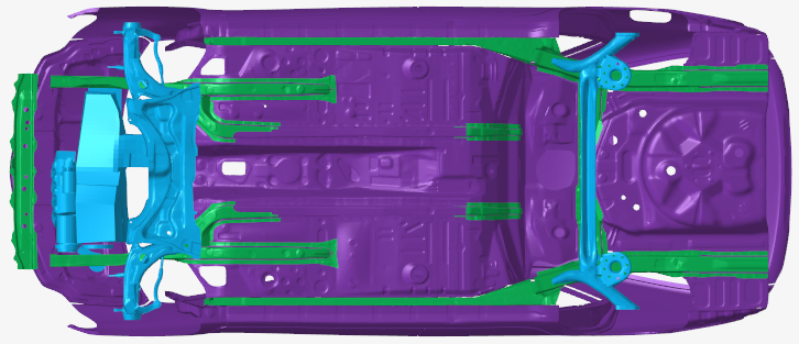

to remove the label. - Repeat steps 2-4 to create two new labels named Extrusions (part IDs: 128, 334, 338, 404, 418, 420, 422, 454, 466, 470, 488, 492, 504, 506, 562, 600, 604, 630, 640, 712; part set: Extrusions) and Castings (part IDs: 142, 144, 146, 158, 672, 676, 750, 752, 756, 780, 800, 806, 808, 832, 836, 1000, 1006, 1008, 1016, 1018, 1020; part set: Castings).
Hide all the parts in the model. Right-click on a label’s name in the legend
and select Show All to view the labeled parts only.

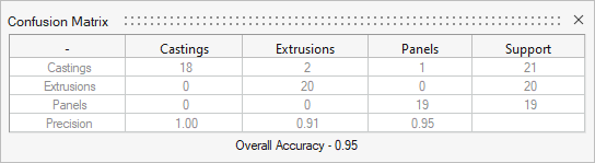

After training, the Confusion Matrix is displayed:
Figure 9.
Notice that the Overall Accuracy value is equal to 0.95.
The model predicted there to be 22 extrusions. The 20 parts labeled as extrusions were predicted correctly, but the model additionally labeled two parts as extrusions which were labeled as castings. Therefore, the precision for extrusions is 91%. To understand more about “Precision”, “Support” and “Overall Accuracy”, see Train a Machine Learning Model.Note: The training results you will get might be slightly different from the ones presented in this tutorial. Training can be affected by the order that parts are labeled, which is not always the same (even if you select them in the same order before clicking

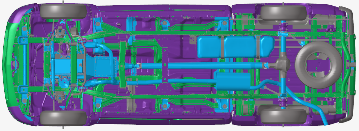

- Open the F250.hm model.
From the
guide bar:
- From the Label drop-down menu, select the Panels label and assign it to the parts with the following IDs: 302, 320, 404, 454, 466, 470, 476, 772, 828, 896, 940, 1006, 1008, 1026, 1030, 1058, 1060, 1204, 1206.
- From the Label drop-down menu, select the Extrusions label and assign it to the parts with the following IDs: 298, 430, 500, 502, 504, 576, 580, 586, 588, 598, 602, 604, 614, 618, 622, 624, 630, 1004, 1010, 1012, 1014, 1022, 1242, 1244.
- From the Label drop-down menu, select the Castings label and assign it to the parts with the following IDs: 380, 428, 638, 640, 642, 650, 652, 688, 718, 720, 722, 760, 764, 766, 864, 886, 1002, 1134, 1182, 1598.

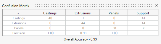

After the classifier has been trained, a new Confusion Matrix is
displayed:
Figure 13.
Notice that the Overall Accuracy value is now equal to 0.99.Note: The training results you’ll get might be slightly different from the ones presented in this tutorial. Training can be affected by the order that parts are labeled, which is not always the same (even if you select them in the same order before clicking

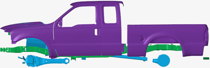

Click Classify to classify the selected parts. The parts
are color-coded based on the predicted labels. Part sets are created for review
and traceability after exiting the Classify tool.

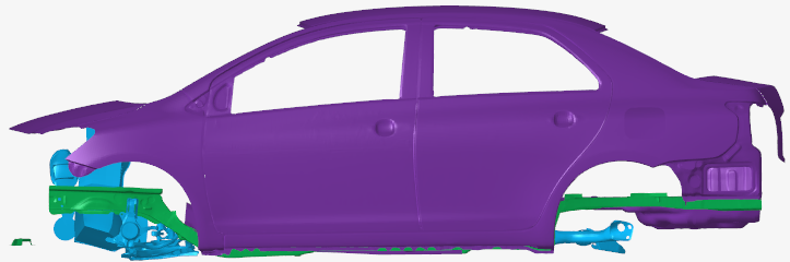

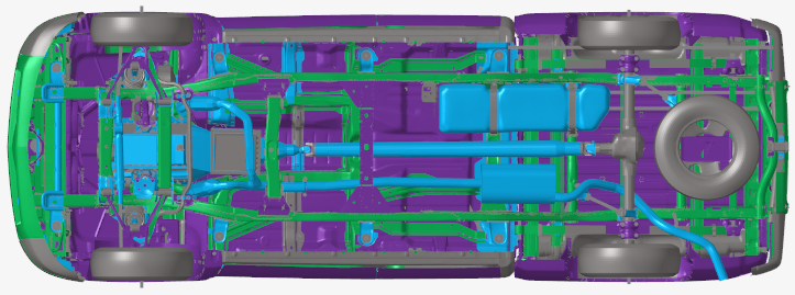

Figure 16.
Figure 17.
Change the Certainty Ratio value to
0.6 and perform a new classification run:
Figure 18.
Notice how the Certainty Ratio value affects the classification results (the number of parts under each label). (See Certainty Ratio, Unclear Predictions, and Unrecognized Parts for more information on this feature).
