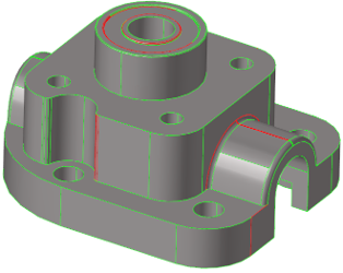

From the 2D ribbon, select the tool.
The model is displayed with its edges highlighted in green (closed edges) and red (free edges).Figure 3.
Note: The edges highlighted in red represent free edges, while those highlighted in green represent closed edges. -

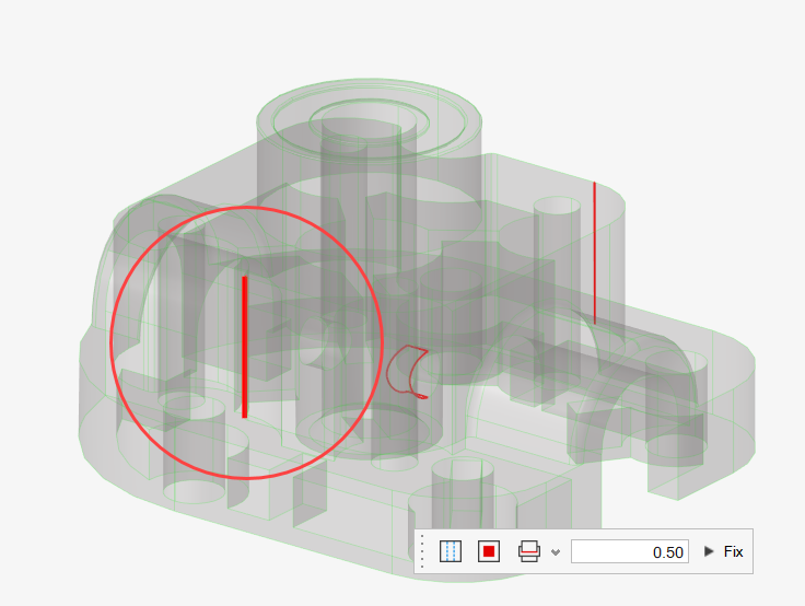

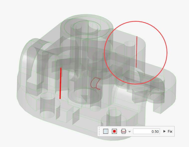

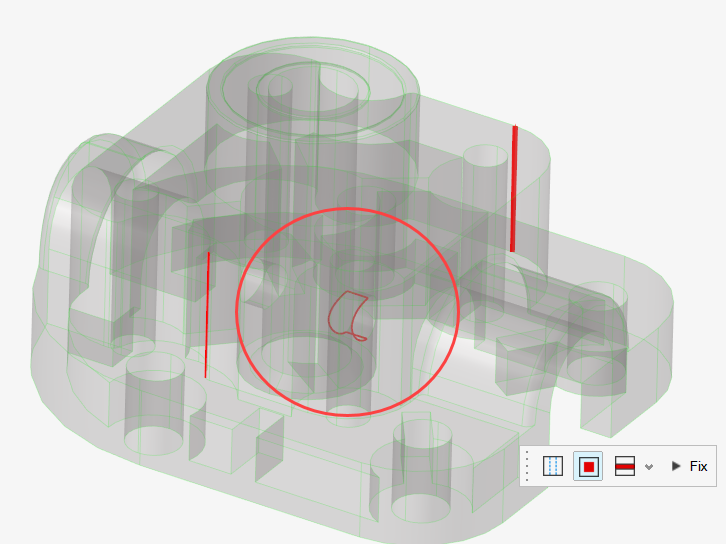

The legend now shows that there are three Free edges remaining.Figure 4.
Figure 5.
From the guide bar, click
and
to navigate between the remaining free edges.
From the microdialog, click
and click on the edge shown in Figure 6 to patch it.
Figure 6.
and select
Set the Tolerance to 0.5 and click on the next
highlighted free edge shown in Figure 7 to fix it.

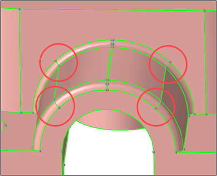

Click on the last highlighted free edge shown in Figure 8 to stitch it.
Figure 8.

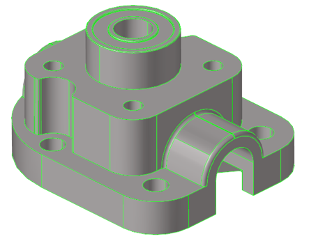

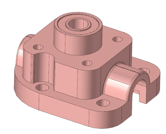

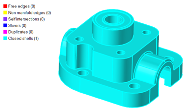

All edges are now highlighted in green.Figure 9.

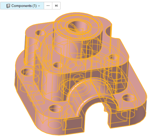

Figure 10.
to create
the solid geometry.
Figure 11.

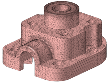

Mesh.

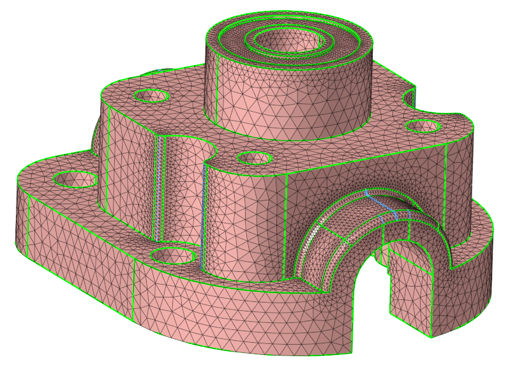

Figure 13.
- From the view controls toolbar, click to set the geometry to wireframe mode.
Review the tetra mesh to identify areas for improvement.
Tip: From the view controls toolbar, click to display shaded geometry with surface edges to assist in identifying areas in need of improvement.
You can also click
to only
display Elements. This can also be helpful in reviewing the tetra mesh
to identify areas of improvement.Figure 14.
As seen in Figure 14, some areas of the tetra mesh still need fine-tuning.

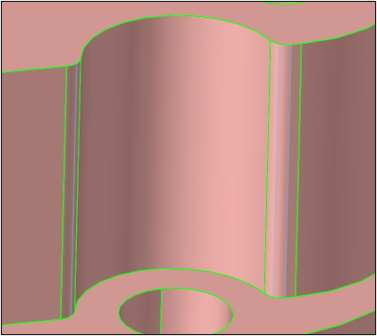

From the Topology ribbon, select the tool.
Figure 17.
- Set Minimum to 0.001 and Maximum to 1 to identify only the fillet around the top hole.
- On the guide bar, click Find.
- On the guide bar, click Remove All.

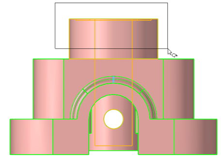

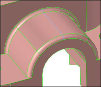

Split the fillets as shown in Figure 18 by clicking and
dragging on the surface of the model.
Figure 18.
- Repeat for the other side.
Suppress tool from the Stitch tool group.
Figure 19.
Suppress the edges as shown in Figure 20 by clicking on
them.

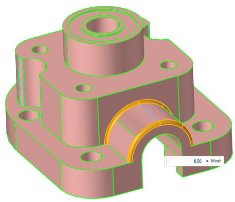

Select the surfaces shown in Figure 25.
Figure 25.
- Set Element size to 0.5.
- Set Element type to R-Trias.
- Set Element order to First.
- From the guide bar, click Mesh.

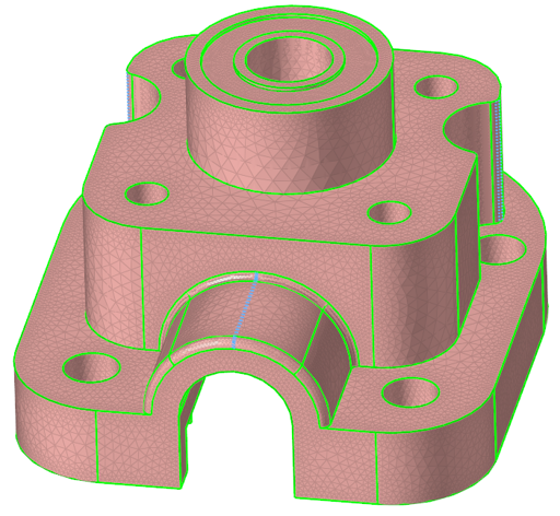

From the 2D ribbon, use the tool to adjust the density if necessary.
Figure 26.
Figure 27.
- Close the tool and examine the shell mesh just created.
- Repeat on the other side of the model.

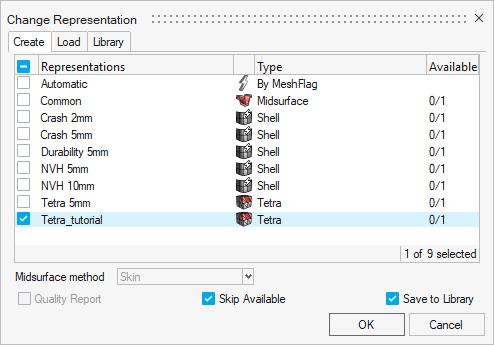

From the Part Browser, right-click the engine
mount and select from the context menu.
The Change Representation dialog opens.
Select the Tetra_tutorial representation control and
click OK.

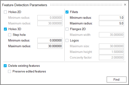

In the Feature Detection Parameters dialog, define
parameters.

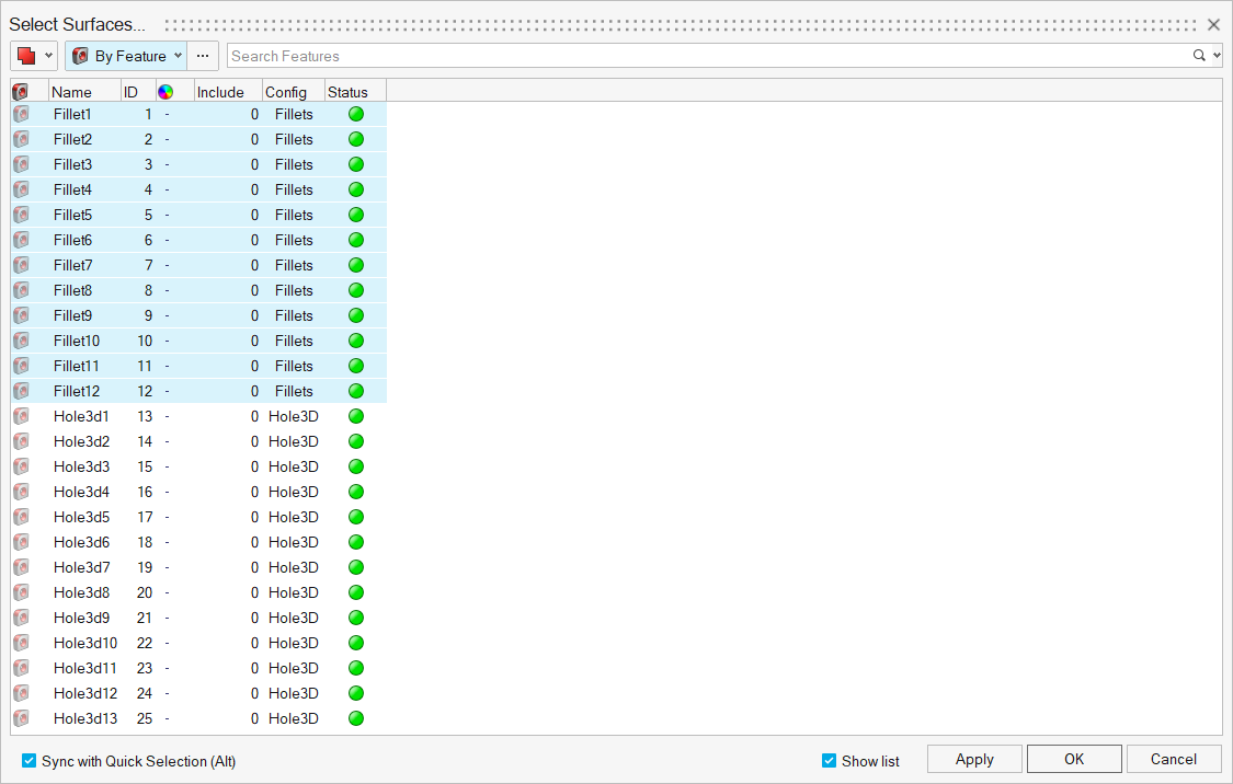

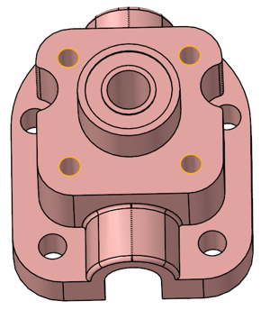

- Select only the Holes 3D and Fillets boxes, as shown in Figure 36.
- Set the Minimum Radius for Fillets to 1 and Maximum Radius to 5
- Click Find.
Figure 36.

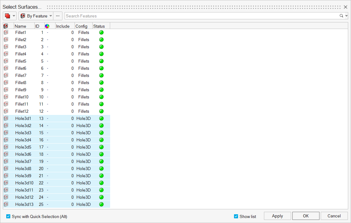

From the View Controls toolbar, click
and select Features.
- Review the selected features and close the Feature Manager dialog.

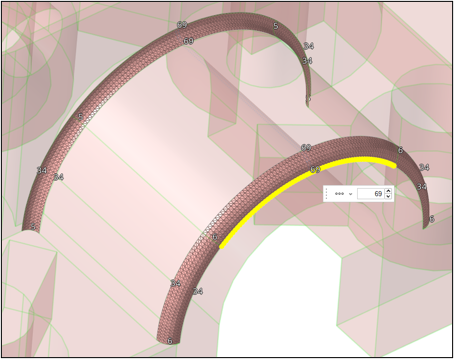

- From the Mesh Controls Browser, right-click on Feature and select Mesh.

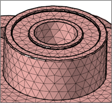

Review the surface mesh that was created.
Figure 42.

Create a volume mesh control.
- From the Mesh Controls Browser, right-click on Surface Mesh and select Mesh.
- From the Mesh Controls Browser, right-click on Volume Mesh and select Mesh.
Delete the previously created shell mesh (CTRIA3) and review the mesh.
Figure 45.
