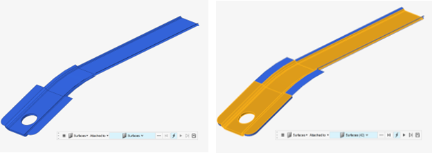

Attached To Function
The Attached to function finds entities that are attached or connected to the selected FE or geometry entities.
For example, finding surfaces that are attached to the selected surfaces.

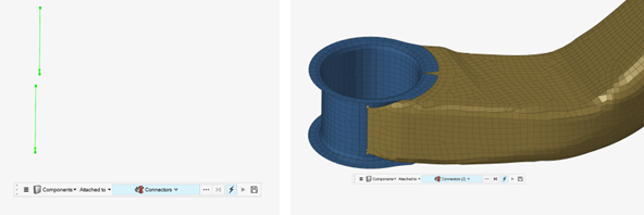

The Attached to function can also be used to find entities that are not the same as the input entity. For example, Figure 2 shows components attached to the selected connectors are found.

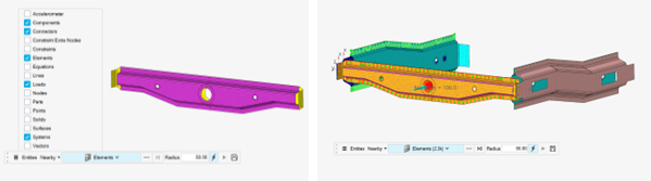

Nearby Function
The Nearby function finds entities that are near the selected entities, within a specified distance that can be modified in the Radius input field.
The default radius value is 10. Click Entities to display and select from the output entity list.
In the example shown in Figure 3, all the FE, along with the connectors, loads, and systems that are within a search radius of 50 of the selected elements are found.

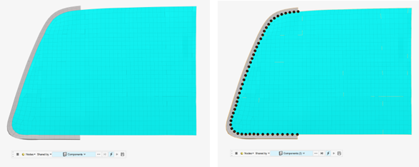

Shared By Function
The Shared by function finds entities that are shared by two or more selected entities.
