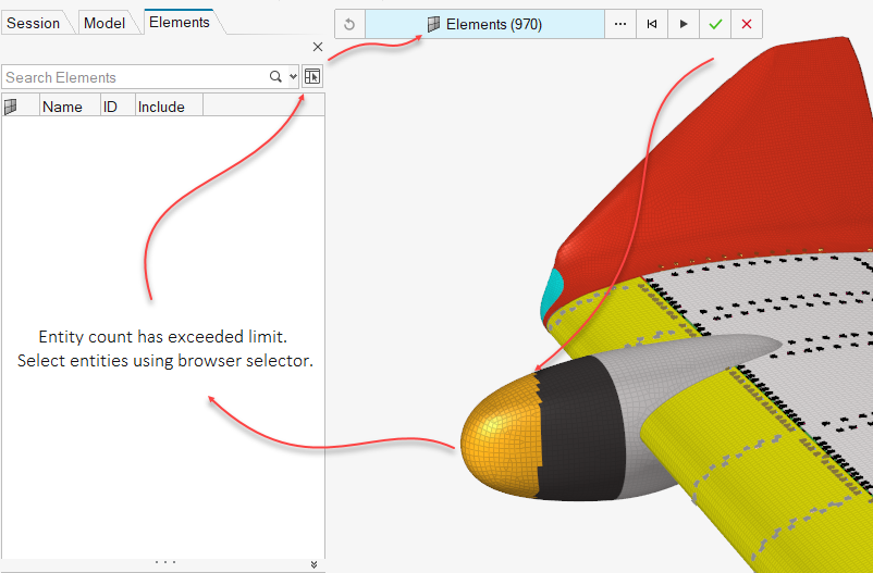

Populate Entity View with Selected Content
Pick required entities, including Nodes and Elements, to be shown in the respective browser and further review and edit data with attribute columns.
Click
in the entity view to invoke a selection context.
Select entities of interest using any selection method, such as picking directly from
the graphics, advance selections, and so on. Click
on the
guide bar to populate the browser with your selection and
keep the context open or click
to populate the browser and close the context.
The "Select entities" icon remains highlighted to indicate that the browser is showing subset of the available content.
Click
again to append or replace the browser contents with
another selection.
The existing contents in the browser are auto-selected to easily append to the
current selection. To completely replace the contents, click
on the guide bar and make a new selection.
Click
to
reset the browser to show all contents (for named entities) or to clear the browser
(for unnamed entities).
Like in regular browsers views, attribute columns and advanced filtering can be used for fast and efficient review and editing of the selected contents.
