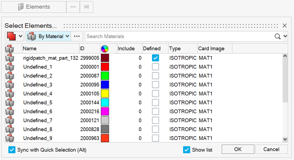

- By Material
- Select entities by material.

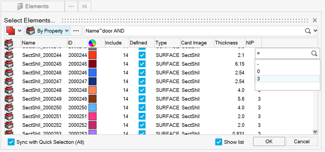

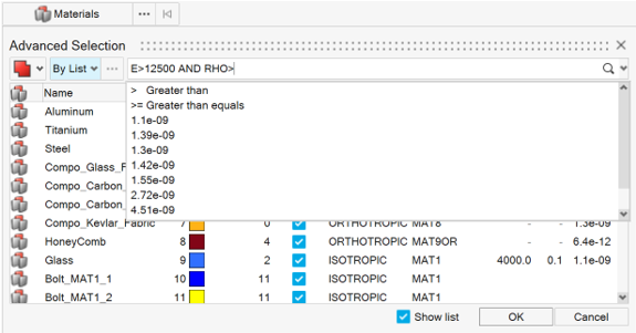

Add attribute columns to the Advanced Selection dialog by right-clicking on the column headers and selecting More. A dialog containing a list of the available attributes for the specific entity type is shown, from which the column's visibility can be controlled. Once a column is added to a particular entity-based selection method, it is available across all the entity selectors that refer to that selection method.
Column Filtering and Search
Search and filtering attribute column data in the selection dialog.
Define search filters inside the selection view to identify entities based on known attributes. Quickly search by directly typing the entity name or ID in the search bar or perform an advanced search by interactively building the search string using the column data. Click on the text field of the search bar to access a dynamic suggestion list that assists in building an advanced search string.
Click the filter icon on the column header to apply a quick filter directly to the columns.
Refer to the browser documentation for more information on search and filtering.
