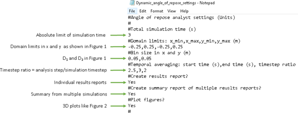

Dynamic_angle_of_repose_analyst_v3.pyscript. - Modify the EDEM test deck to match the experimental setup.
The post-processing script utilizes the EDEMpy library to locate all EDEM decks in the folder containing the script and sub folders. Finally, it generates reports and figures with all the relevant data.
Dynamic_angle_of_repose_settings.txt file, as shown in Figure

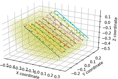

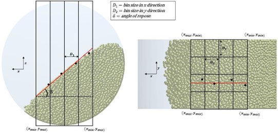

3. For desirable results, set the bin size to 10 particle diameters and limit the
analysis domain to the region where the Angle of Repose is approximately stable as
shown in Figure 1. Set the Start and End time for temporal averaging to the same
value to produce instantaneous results only.

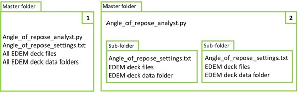

Dynamic_angle_of_repose_analyst_v3.py script:- Arrange the files as shown in Figure 4.
- Open a blank or existing EDEM simulation file, and go to .
- Go to and then select the
Dynamic_angle_of_repose_analyst_v3.pyscript.Reports and graphs will be generated in the master folder. Individual reports contain all the relevant data and the summary report will contain only time-averaged results. Only complete simulations with the corresponding settings files will be post-processed. Otherwise the script will produce error messages as shown in Figure 5, and then move to the next simulation in the folder tree.Note: All simulation files must have unique folder names and simulation names. If the simulation names are identical, the results report will be overwritten.Figure 5. Possible error messages
