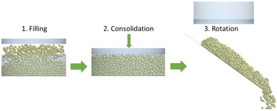

The test consists of consolidating a bulk solid sample on a flat plate under a specified weight and then rotating the plate at a constant rotational velocity until the sample slides off as shown in Figure 1. The angle at which the unconfined sample begins to slip, termed as 'initial slip angle', and the angle at which all of the material is sliding on the wall, termed as the 'final slip angle', are used to characterize the bulk solid-equipment interaction for cohesive solids. These measurements are suitable to use as a benchmark for the calibration of Particle-Geometry interaction in EDEM simulations for cohesive bulk solids.

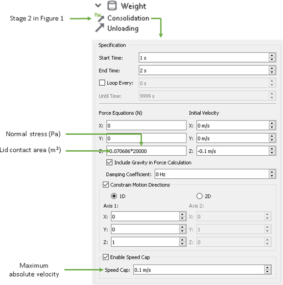

- Run the simulation till the end.The consolidation stage of the test shown in Figure 1 is modeled using EDEM kinematics controllers as shown in Figure 2. You can modify the applied stress by changing the vertical force magnitude in the controller.

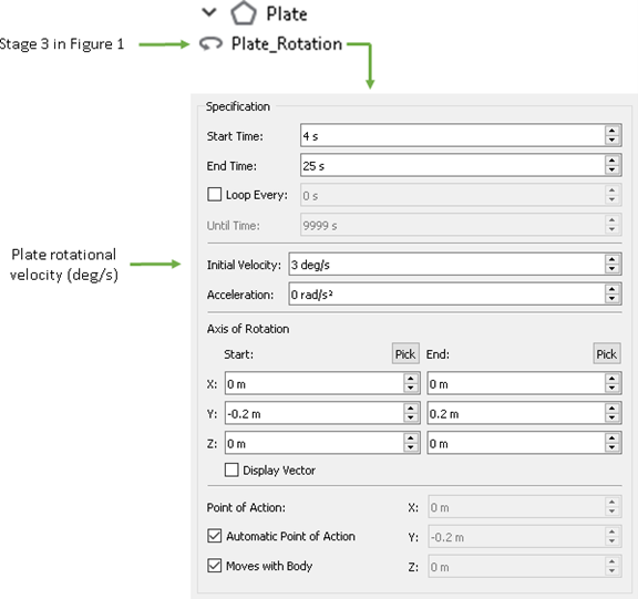

The plate rotation is modeled using a constant rotational velocity kinematic as shown in Figure 3. The physical test is performed at a low rotational velocity of 2-3 deg/s to avoid inertial effects on the results. It is recommended to adopt a similar approach in the EDEM simulations.

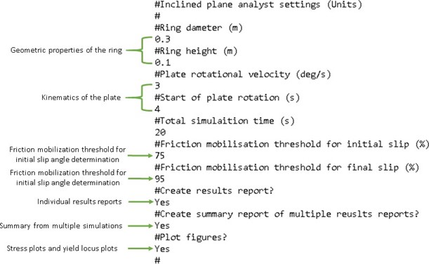

The analysis settings for the script are defined in the
UCT_analyst_settings.txt file, as shown in Figure 3.
IPT_analyst_settings.txt file, as shown in Figure 4. The
determination of the initial and final slip angles is done on the basis of the
degree of Particle-Geometry friction mobilization quantified by the percentage of
particle in contact with the sliding plates. Reasonable values for the initial and
final slip thresholds are 75% and 95% respectively. In cases when a significant
amount of material adheres permanently to the plate, the final slip threshold may
need to be decreased or ignored.

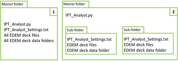

You can post-process multiple simulation decks with the script by arranging the files into one of the two configurations as shown in Figure 4. The second configuration is recommended, as it allows for individual settings files for each EDEM deck, and therefore post-processing of different types of tests can be done simultaneously. In the first configuration, a single settings file is read for post-processing all decks.
IPT_analyst_v3.py script:- Arrange the files as shown in Figure 5.

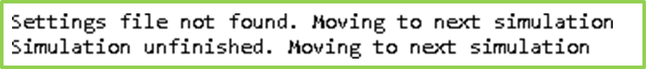

IPT_analyst_v3.pyscript.Reports and graphs will be generated in the master folder. Individual reports will contain all the relevant data and the summary report will contain only time-averaged results.Note: Only complete simulations with corresponding settings files will be post-processed. Otherwise the script will produce error messages as shown in Figure 6 and move to the next simulation in the folder tree.Figure 6. Possible error messages
