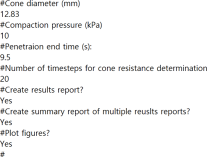

The analysis settings for the script are defined in the
CPT_Analyst.txt file, as shown in Figure 3. The settings files
for all standard tests are provided along with the EDEM
decks. If you have used a custom test procedure, the timings must be adjusted
accordingly. If you have omitted a stage from a custom simulation, the relevant
times can be set to zero, but the format of the file must remain the same.

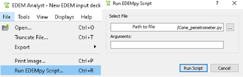

Cone_penetrometer.py script:- Arrange the files as shown in Figure 2.
- Open the EDEM deck file.
- go to .
- Go to and then select the
Cone_penetrometer.pyscript. - Execute the script as shown in Figure 4.
Figure 4. Executing the Cone Penetrometer Analyst EDEMpy script

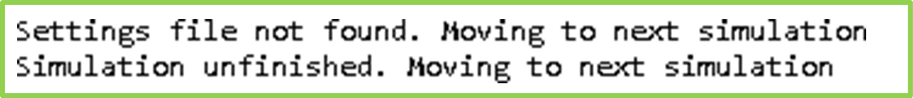

Only complete simulations with corresponding settings files will be post-processed. Otherwise the script will produce error messages as shown in Figure 5 and move to the next simulation in the folder tree.Note: All simulation files must have unique folder names and simulation names. If the simulation names are identical, the results report will be overwritten.Figure 5. Possible error messages
