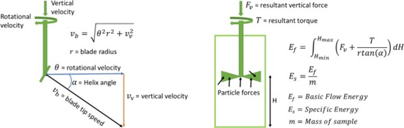

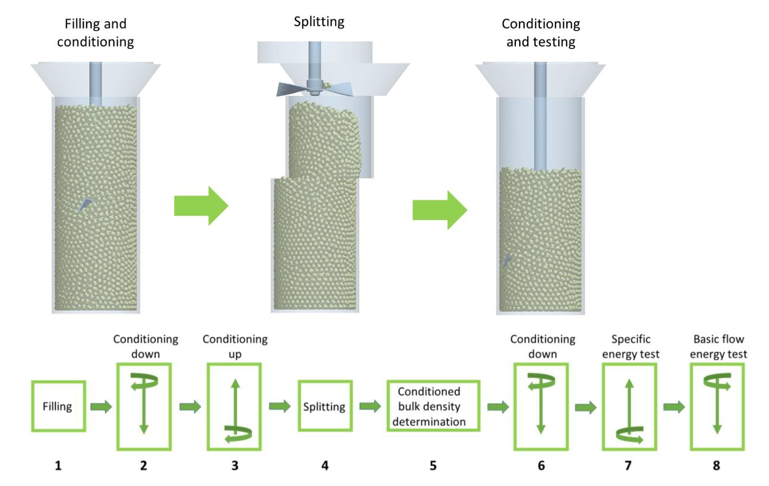

The FT4 Basic Flow Energy test consists of force and torque measurements on an impeller blade moving through a cylindrical bed of granular material. The test is performed at different magnitudes of helical velocity of the blade, also known as 'blade tip speed' as shown in Figure 1. The work done by the impeller blade is calculated from the force and torque measurements and is used as an indication of the flowability of the material. The standard test procedure at a given blade tip speed is shown in Figure 2.
The relatively high velocities of the blade and the helical motion of the impeller through the sample lead to a complex state of stress and a dynamic flow regime. These conditions may approximate the ones induced in dynamic systems such as high shear granulators and mixers. The results are less relevant for systems in the quasi-static flow regime.

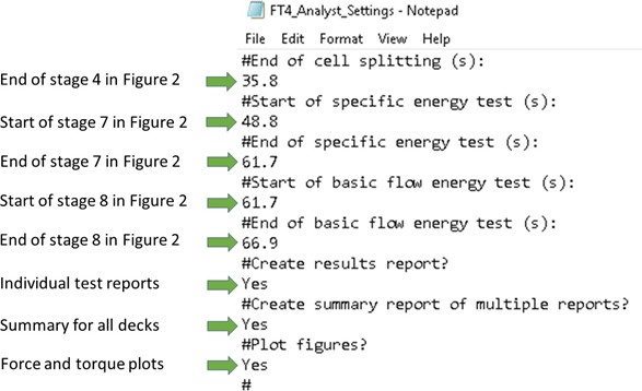

The analysis settings for the script are defined in the
FT4_Analyst_Settings.txt file, as shown in Figure 3. The
settings files for all standard tests are provided along with the EDEM decks. If you have used a custom test procedure, the
timings must be adjusted accordingly. If you have omitted a stage from a custom
simulation, the relevant times can be set to zero, but the format of the file remain
the same.
