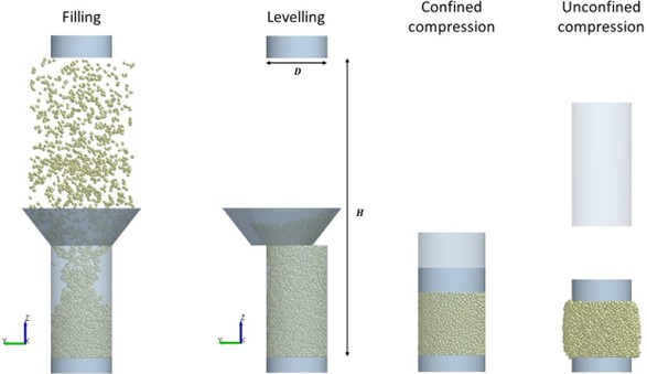

During the test, a powder sample confined in a rigid cylinder undergoes uniaxial compression under a known vertical stress and is subsequently crushed in the unconfined state as shown in Figure 1. The physical responses of interest are the initial packing state, the stress-strain response during confined compression, and unconfined compression strength.

- Run the simulation till the end.The stages of the test described in Figure 1 are modeled using EDEM kinematics controllers as shown in Figure 2.

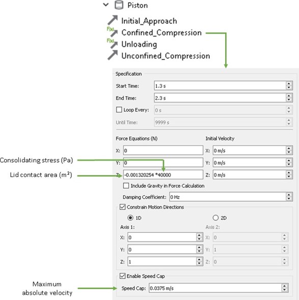

Figure 2. Uniaxial compression test piston kinematics
Uniaxial compression tests produce measurements in the quasi-static flow regime where the macro-mechanical behavior of granular materials is independent of the strain rate . Therefore, the compression rate in the provided EDEM deck is accelerated to leverage computational efficiency. If the particle properties or the applied normal stresses in the model change significantly, the compression rate may need to be adjusted to ensure the quasi-static flow regime is maintained. This can be achieved by changing the piston vertical velocity as shown in Figure 2.

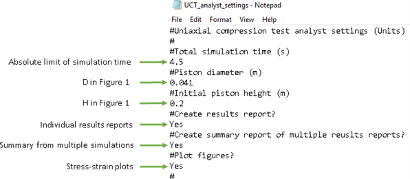

UCT_analyst_settings.txt file, as shown in Figure 3.

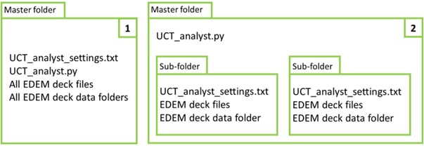

- Arrange the files as shown in Figure 4.
