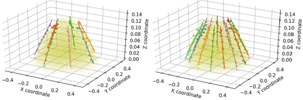

The Angle of Repose is determined by defining a radial array of bins, identifying the highest particle in each bin and conducting a least-squares linear fit to the coordinates of the center of mass of these particles as shown in Figure 1. You can take multiple measurements as shown in Figure 3. Record the average value, standard deviation, and Coefficient of Variance along with the raw data for each measurement.

The domain limits must be conservatively selected on the basis of the steepest conical pile in the calibration exercise and can then be applied for all other cases. The bin size must be set between 3-4 average particle diameters as shown in Figure 1. Select the number of radial measurements so that there is no overlap between bins. Typically, eight measurements ensure that this condition is met while producing a sufficiently accurate averaged value for the Angle of Repose. The analysis can be applied to any simulated conical granular pile, only if the pile is produced near the origin of the simulation coordinate system.
