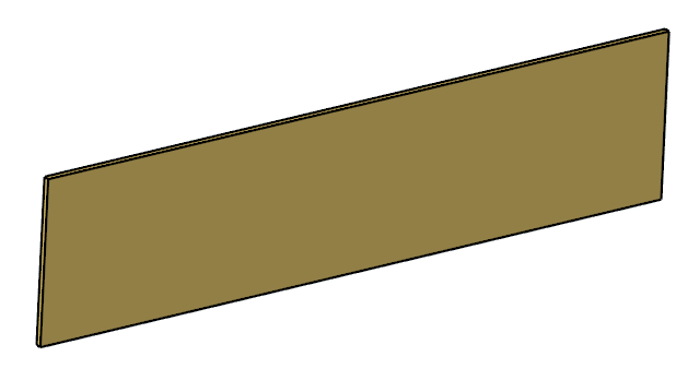

Import the Geometry
- From the menu bar, click .
- In the Import File dialog, browse to your working directory then select ACU-T4000_dambreak2D.x_t and click Open.
In the Geometry Import Options dialog, leave all the
default options unchanged then click Import.
Figure 3.
Figure 4.

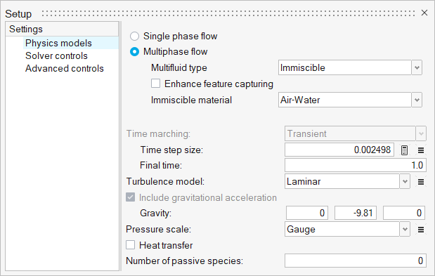

Under the Physics models setting:
- Activate the Multiphase flow radio button.
- Set the Multifluid type to Immiscible and the Immiscible material to Air-Water
- Set the Time step size to 0.002498 and the Final time to 1.0
- Select Laminar as the Turbulence model.
- Set the gravity to -9.81 m/sec2 in the y direction.

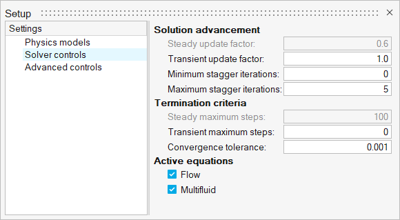

Click the Solver Controls setting and set the Maximum
stagger iterations to 5.
Figure 9.

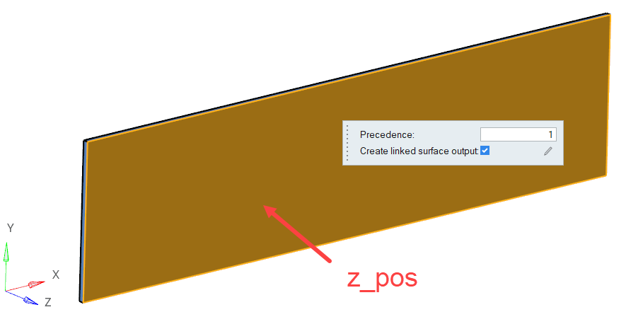

- In the Boundaries legend, double-click on Symmetry, rename it to z_pos and press Enter.
On the guide bar, click
to execute the command and remain in the
tool.

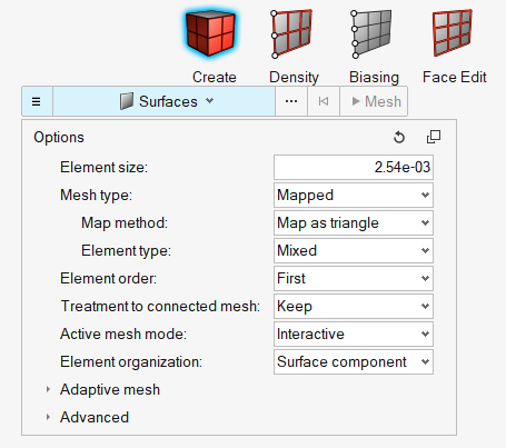

By default, the Create should be selected from the secondary ribbon. -
Click
on the guide bar to open the options menu, then make the following
changes:
- Set the Element size to 0.00254.
- Set the Mesh type to Mapped.
- Set the Map method to Map as triangle.
Figure 14.
- On the guide bar, change the entity selector to Solids then select the solid in the modeling window.
- Click Mesh in either the microdialog or on the guide bar to generate the surface mesh.
- Once the surface mesh is created, press Esc to exit out of the tool.

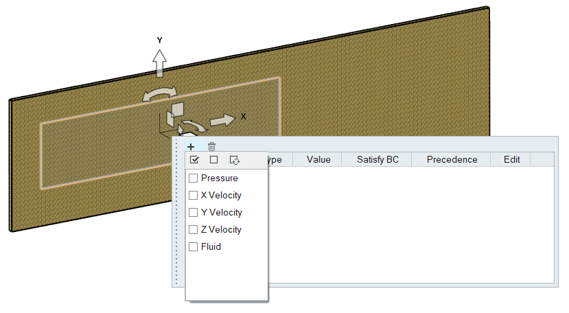

Define the Nodal Initial Conditions
From the Solution ribbon, Zones tool group, click the Box
tool.
Figure 19.
Hover the cursor over the dam geometry. When the zone is aligned with the
surfaces of the model, double-click on the geometry.
An initialization zone with arbitrary dimensions should be visible on the model.
Figure 20.

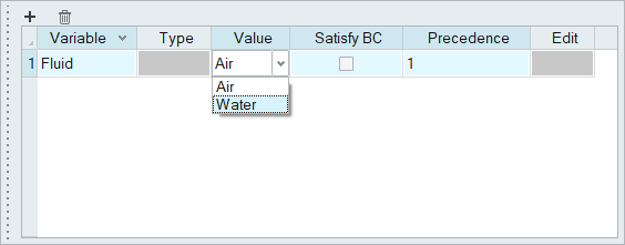

In the microdialog, select Fluid
then click in empty space in the dialog. Change the Value field to
Water.
Figure 21.

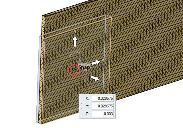

Note: If you do not see the microdialog for entering the dimensions, move the NIC variable microdialog. -
Click the center of the manipulator on the model, as shown in the figure below,
then enter the following coordinates for the center: 0.028575,
0.028575, 0.003.
Figure 23.
This will ensure that the fluid domain is initialized with a water column at the corner of the dam.

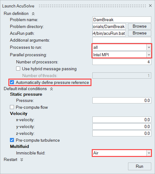

The Launch AcuSolve dialog opens. - Set the Parallel processing option to Intel MPI.
- Verify that the Automatically define pressure reference option is active.
- Expand the Default initial conditions tab and deactivate the Pre-compute flow option.
- Set all the velocity components to 0 and set the Immiscible fluid to Air (if not already set).
Leave the remaining options as default and click
Run to launch AcuSolve.

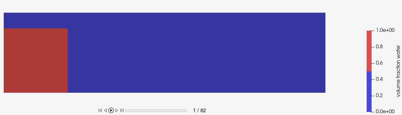

Click the Top face on the View Cube to align the
model.
Figure 26.
- Right-click on the z_pos boundary in the Post Browser and select Edit.
- In the display properties microdialog, set the display to volume fraction water.
Activate the Legend toggle and click
to refresh the range.
Click
, set the Colormap style to
Filled, the Number of colors to
2, and the Colormap Name to Rainbow
Desaturated.
Figure 27.
Click
on the guide bar.
Click
at the bottom of the modeling window to view a live animation of the flow.
Figure 28.
