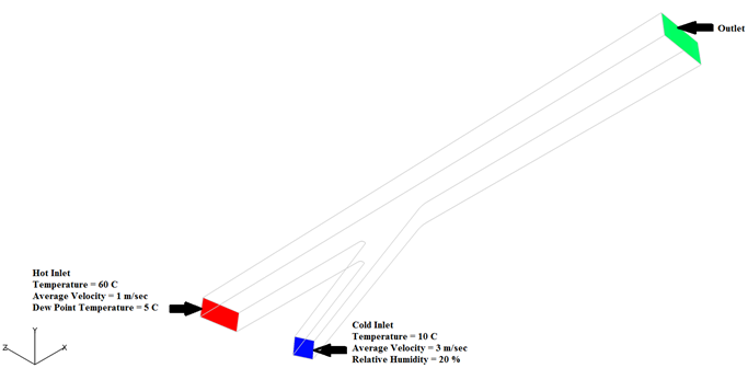

The problem to be addressed in this tutorial is shown schematically in Figure 1. As an example, a pipe junction problem is attached here to show the capability of the Humidity modelling in AcuSolve. In this problem, there are two inlets with different flow, thermal, and humidity conditions. As the flow proceeds downstream of the pipe, two pipes merge into a single pipe to create a single outlet and a distinct profile of temperature and humidity is attained. The geometry is symmetric about the XZ midplane of the pipe, as shown in the figure.

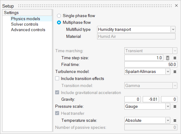

The Setup dialog opens. -
Under the Physics models setting:
- Select the Multiphase flow radio button.
- Set the Multifluid type to Humidity transport.
- Set the Time step size to 1 s and the Final time to 50 s.
- Set the Turbulence model to Spalart-Allmaras.
- Set the Gravity to (0,-9.81,0).
Set the Pressure scale to Gauge and click
. In the microdialog, set the Absolute pressure offset to 101325 Pa
then press Esc.

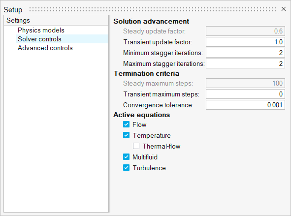

- Click the Solver controls setting.
Set both the Minimum and Maximum stagger iterations to
2.
Figure 6.

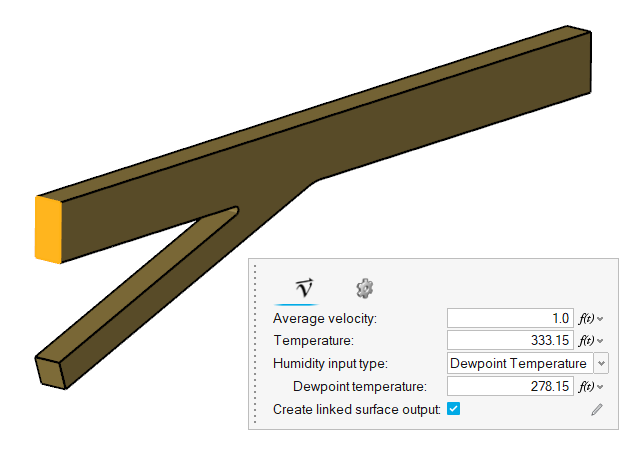

From the Flow ribbon, Profiled
tool group, click the Profiled Inlet tool.
Figure 7.
- Select the surface highlighted in the figure below.
In the microdialog:
- Set the Average velocity to 1 m/sec.
- Set the Temperature to 333.15 K.
- Set the Humidity input type to Dewpoint Temperature.
- Set the Dewpoint temperature to 278.15 K.
Figure 8.
- In the Boundaries legend, double-click on Inlet, change the name to Hot_inlet, then press Enter.
On the guide bar, click
to execute the command and remain in the
tool.

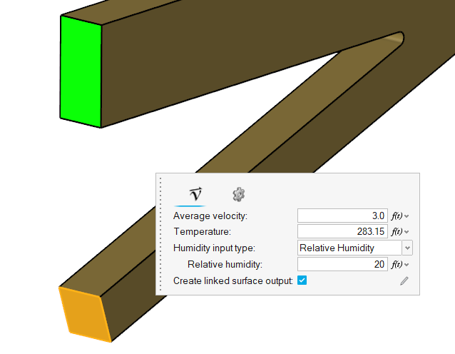

In the microdialog:
- Set the Average velocity to 3 m/sec.
- Set the Temperature to 283.15 K.
- Set the Humidity input type to Relative Humidity.
- Set the Relative humidity to 20.
Figure 9.
- In the Boundaries legend, double-click on Inlet, change the name to Cold_inlet, then press Enter.
to execute

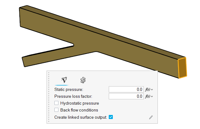

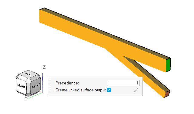

Click the Outlet tool.
Figure 10.
Select the surface highlighted in the figure below then click
on the
guide bar.

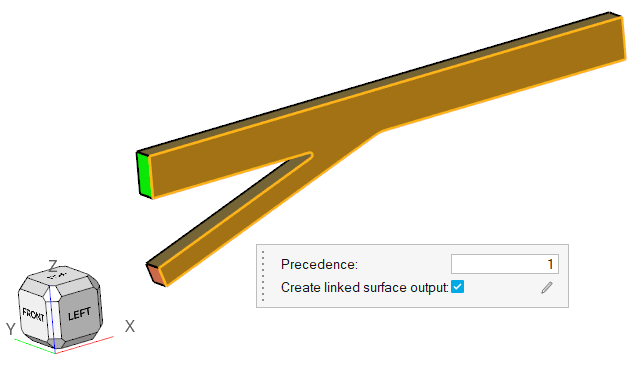

From the Solution ribbon, click the Part tool.
Figure 15.
- Select the pipe solid.

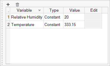

Set the initial values of Relative Humidity and Temperature to
20 and 333.15 K,
respectively

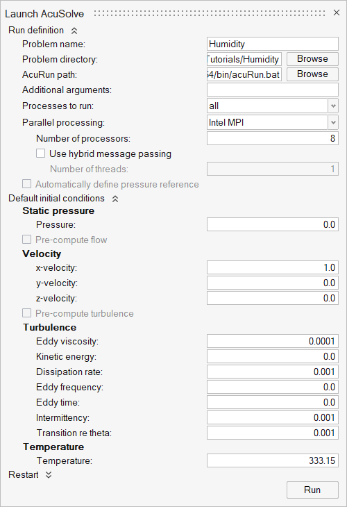

Run AcuSolve
Figure 17.
- Set the Parallel processing option to Intel MPI.
- Expand Default initial conditions.
- Set the Temperature to 333.15 K and the remaining fields as shown in the figure below.
Click Run to launch AcuSolve.

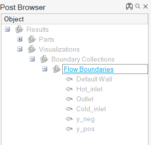

The solid and all the surfaces are loaded in the Post Browser.
In the Post Browser, click on the icon beside
Flow Boundaries to turn off the display of all the
surfaces.

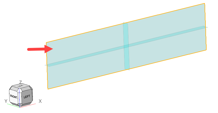

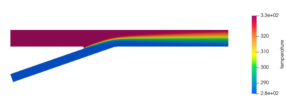

Click the Slice Planes tool.
Figure 20.
Select the x-z plane in the modeling window.
Figure 21.
In the slice plane microdialog, click
to
create the slice plane.

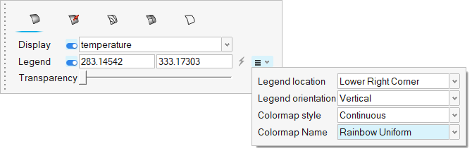

- In the display properties microdialog, set the display to temperature.
Click
then activate the Legend
toggle.
Click
and set the Colormap Name to Rainbow
Uniform.
Figure 22.
to
create the temperature contour plot.

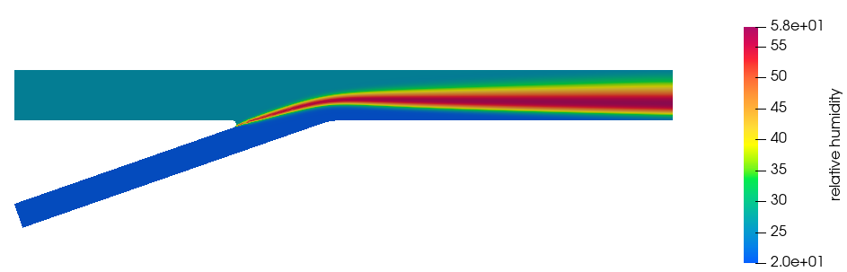

Figure 23.
Hide the temperature contour and repeat the steps 5-11 to create a similar
contour plot for relative humidity.

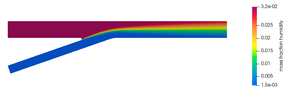

Hide the relative humidity contour and repeat the steps 5-11 to create a
similar contour plot for mass fraction humidity.
Figure 25.

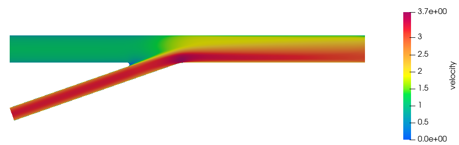

Hide the mass fraction humidity contour and repeat the steps 5-11 to create a
similar contour plot for velocity.
Figure 26.
