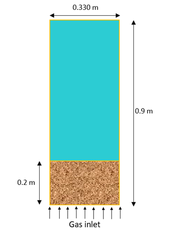

This tutorial provides the instructions for setting up and running a gas-solid fluidized bed simulation using the granular multiphase model. Prior to starting this tutorial, you should have already run through the introductory tutorial, ACU-T: 1000 Basic Flow Set Up, and have a basic understanding of HyperMesh CFD and AcuSolve. To run this simulation, you will need access to a licensed version of HyperMesh CFD and AcuSolve.
Problem Description
| Phase | Density (kg/m3) | Viscosity (Pa s) |
| Gas | 21.56 | 1.781e-05 |
| Particle | 910 | - |

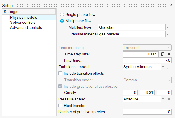

The Setup dialog opens. - Under the Physics models setting, select the Multiphase flow radio button.
- Change the Multifluid type to Granular.

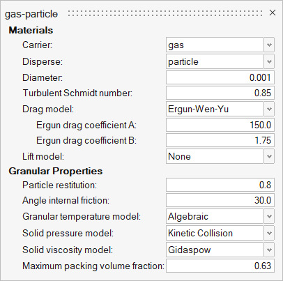

In the Material Library dialog, select Granular
Multiphase, switch to the My Material
tab, then click
to add a new material.
- In the microdialog, click on the top-left corner and change the name to gas-particle.
Set the Carrier field to gas and the Disperse field to
particle.
Note: The input file provided with the tutorial has a predefined gas and particle material models in it.
Set the diameter, drag model, and other granular parameters as shown in the
image below.

- In the Setup dialog, set the Granular Material to gas-particle.
- Set Time step size and Final time to 0.005 and 7, respectively. Select Spalart-Allmaras for the Turbulence model.
Set the gravity to 0, -9.81, 0 and the pressure scale to
Absolute.

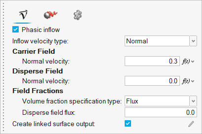

In the microdialog, enter the values shown in the figure below.
Figure 11.

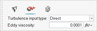

In the turbulence tab, set the turbulence input type to
Direct and set the eddy viscosity value to
0.0001.

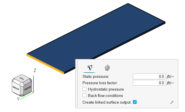

Click the Outlet tool.
Figure 13.
Select the face highlighted below and verify the settings in the
microdialog.

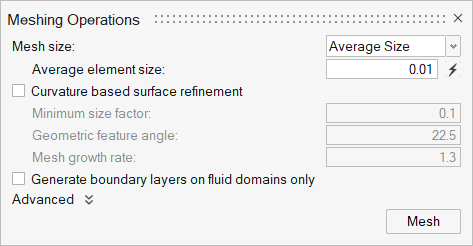

In the Meshing Operations dialog, check that the Average
Element size is set to 0.01.
Figure 18.
Click Mesh.

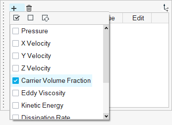

In the variable dialog, click
in the top-left corner and select
Carrier Volume Fraction.
Figure 22.
- Click on the white space in the dialog and set the value of the carrier volume fraction to 0.37.

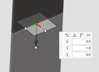

In the Vector tool, verify that the orientation of the tool is along the
negative y-axis then click XYZ.

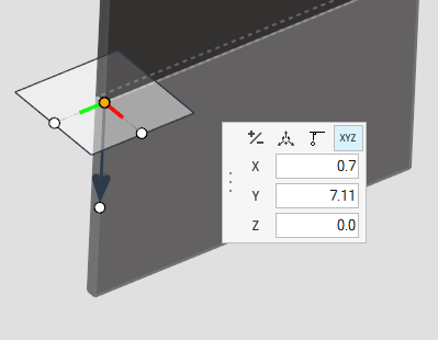

Enter the coordinates of the center of plane as shown in the figure
below.

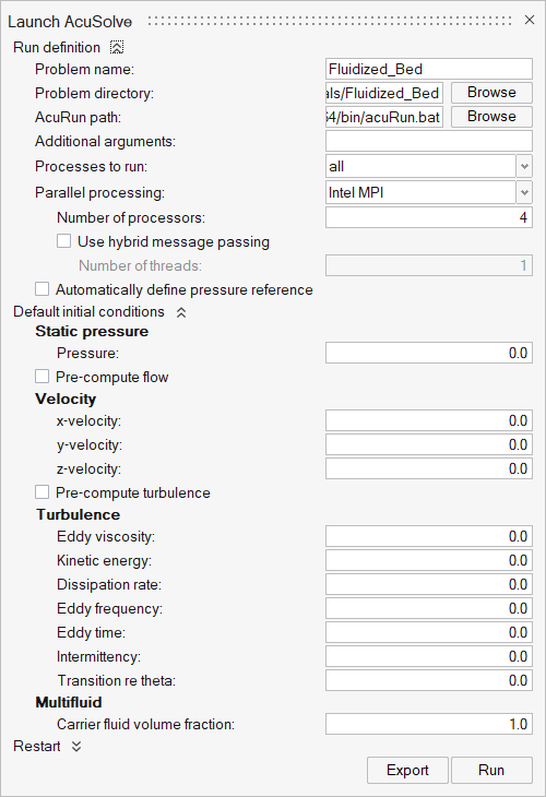

The Launch AcuSolve dialog opens. - Set the Parallel processing option to Intel MPI.
Expand Default initial conditions, uncheck
Pre-compute flow, and set the velocity values to
0. Uncheck Pre-compute
Turbulence.
Figure 26.
Click Run to launch AcuSolve.

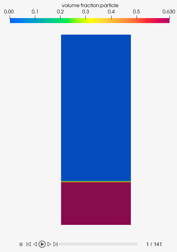

- In the modeling window, select the top slip surface.

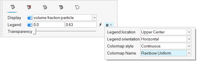

- In the microdialog, set the display variable to volume fraction:particle.
- Activate the Legend toggle and set the legend limits to 0 and 0.63, respectively (if not already set).
Click
and set the colormap properties as shown
below.
Figure 28.
Click
on the guide bar to create the volume fraction contour
plot.
Click the play icon at the bottom of the modeling window to play the animation.
