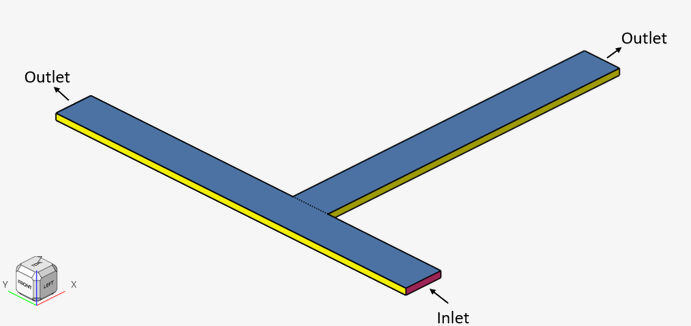

The problem to be addressed in this tutorial is shown schematically in Figure 1. An Air-Water mixture is entering a t-junction pipe through the inlet with a carrier (Water) volume fraction of 0.98. The diameter of the disperse field is 0.001 m. The velocity of the incoming carrier field (Water) is 1.5 m/s, while the velocity of the disperse field (Air) is set to 1.6 m/s. The simulation will be solved as a 2D-problem, therefore a slip condition is applied on the top and bottom surfaces.

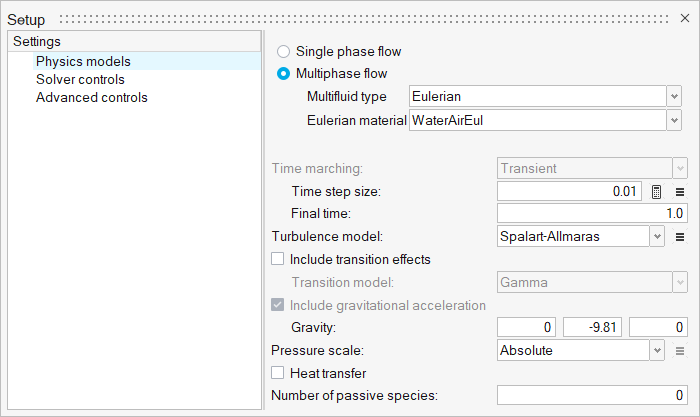

  2. Under the Physics models setting, select the Multiphase flow radio button.
  3. Change the Multifluid type to Eulerian.

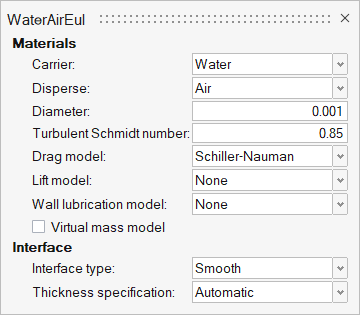

  5. In the Material Library dialog, select Eulerian Multiphase, switch to the My Material tab, then click to add a new material.
  6. In the microdialog, click on the top-left corner and change the name to WaterAirEul.
  7. Set the Carrier field to Water and the Disperse field to Air.
  8. Set the diameter, drag model, and other parameters as shown in the image below.
    Figure 5.

  10. In the Setup dialog, set the Eulerian Material to WaterAirEul.
  11. Set Time step size and Final time to 0.01 and 1, respectively. Select Spalart-Allmaras for the Turbulence model.
  12. Set the gravity to 0, -9.81, 0 and the pressure scale to Absolute.
    Figure 6.

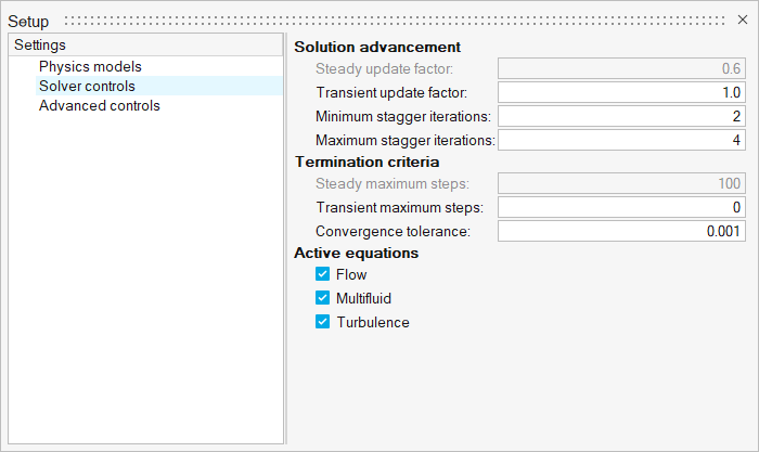

  13. Click the Solver controls setting and set the Minimum and Maximum stagger iterations to 2 and 4, respectively.
    Figure 7.

  2. Click the inlet face highlighted in the figure below.

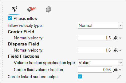

  3. In the microdialog, activate Phasic inflow and then change the inflow velocity type to Normal.
  4. Enter a value of 1.5 and 1.6 m/s for the Normal velocity of the Carrier Field and Disperse Field, respectively.
  5. Set the Volume fraction specification type to Value and set the Carrier fluid volume fraction to 0.98.
    Figure 11.

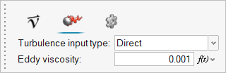

  6. Click the Turbulence tab in the microdialog. Set the Turbulence input type to Direct and the Eddy viscosity to 0.001.
    Figure 12.

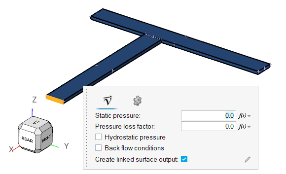

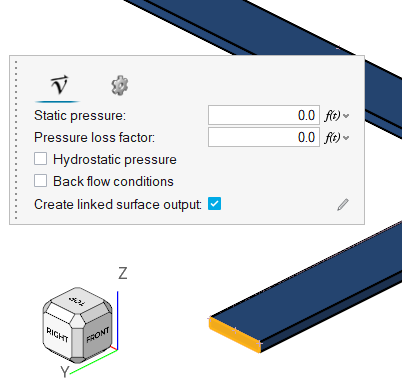

  8. Click the Outlet tool.
    Figure 13.
  9. Select the face highlighted below and verify the settings in the microdialog.
    Figure 14.
  10. On the guide bar, click to execute the command and remain in the tool.

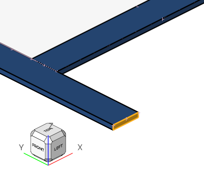

  11. With the Outlet tool still active, select the face highlighted below after rotating the model. Then click on the guide bar.
    Figure 15.

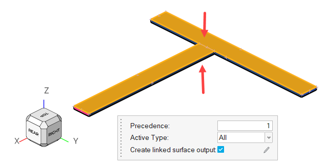

    Figure 16.
  13. Select the top and bottom faces highlighted below then click on the guide bar.
    Figure 17.

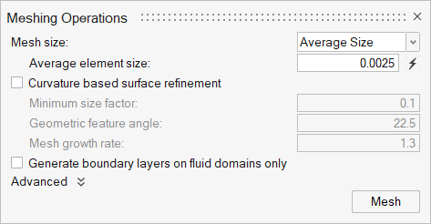

  2. In the Meshing Operations dialog, check that the Average Element size is set to 0.0025.
    Figure 19.
  3. Click Mesh.

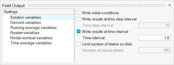

  1. From the Solution ribbon, click the Field tool.
    Figure 20.
    The Field Output dialog opens.
  2. Check the box for Write Initial Conditions.
  3. Set the time interval to 1.
    Figure 21.

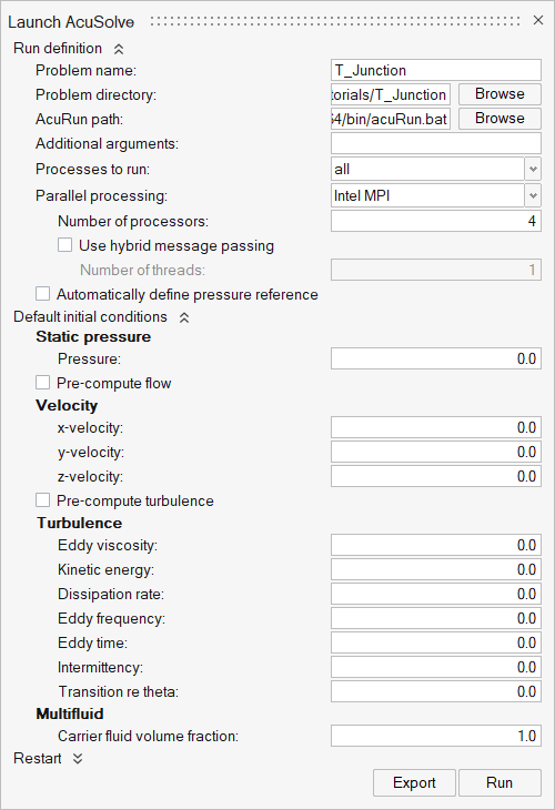

    The Launch AcuSolve dialog opens.
  2. Set the Parallel processing option to Intel MPI.
  3. Optional: Set the number of processors to 4 or 8 based on availability.
  4. Expand Default initial conditions, uncheck Pre-compute flow, and set the velocity values to 0. Uncheck Pre-compute Turbulence.
    Figure 23.
  5. Click Run to launch AcuSolve.

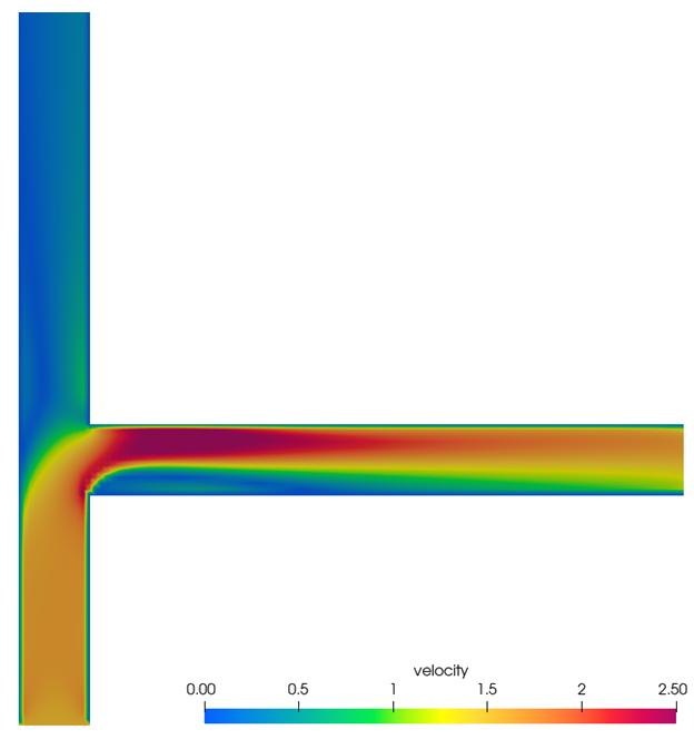

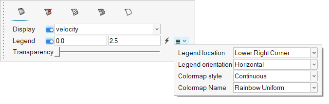

  4. In the modeling window, select the top slip surface.
  5. In the microdialog, set the display variable to velocity.
  6. Activate the Legend toggle and set the legend limits to 0 and 2.5, respectively.
  7. Click and set the colormap properties as shown below.
    Figure 25.
  8. Click on the guide bar to create the velocity contour plot.
    Figure 26.

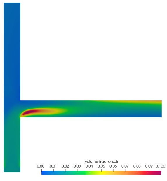

  10. In the microdialog, change the display variable to volume fraction: air and set the legend limits to 0 and 0.1.
  11. Click on the guide bar to create the volume fraction contour plot.
    Figure 27.
