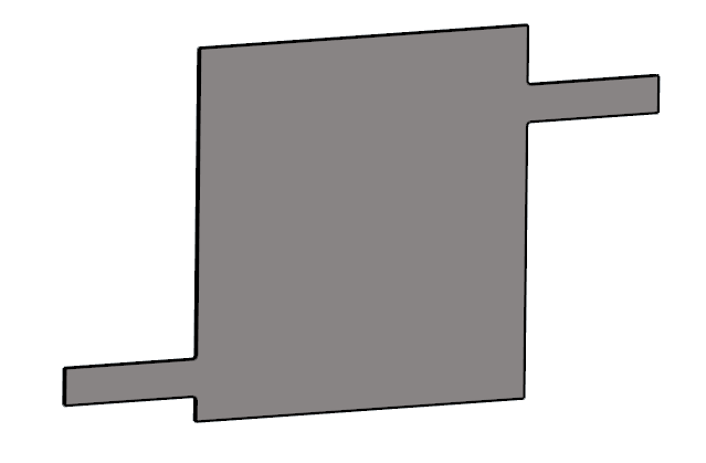

The problem to be solved is shown schematically in the figure below. It consists of a half-filled water tank at time t=0. Water is injected through the Inlet at t=0 and as the water fills in through the inlet, the water-air interface can be visualized in a transient simulation.

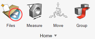

- From the Home tools, Files tool group, click the Save As tool.

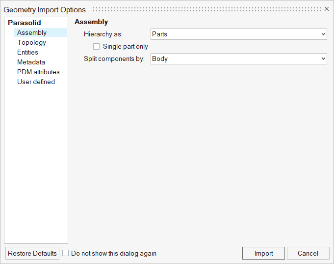

- In the Import File dialog, browse to your working directory then select ACU-T4001_tank2D.x_t and click Open.
In the Geometry Import Options dialog, leave all the
default options unchanged then click Import.

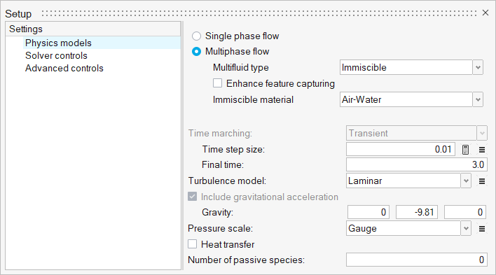

Under the Physics models setting:
- Activate the Multiphase flow radio button.
- Set the Multifluid type to Immiscible and the Immiscible material to Air-Water
- Set the Time step size to 0.01 and the Final time to 3.0
- Select Laminar as the Turbulence model.
- Set the gravity to -9.81 m/sec2 in the y direction.

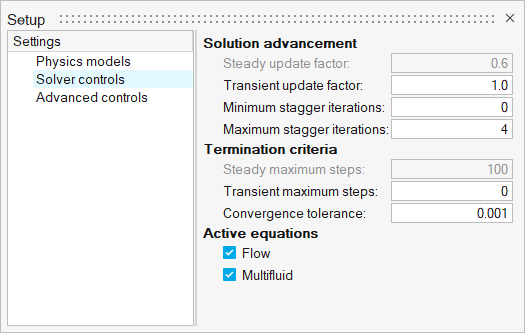

Click the Solver Controls setting and set the Maximum
stagger iterations to 4.
Figure 9.

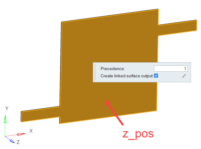

- In the Boundaries legend, double-click on Slip, rename it to z_pos and press Enter.
On the guide bar, click
to execute the command and remain in the
tool.

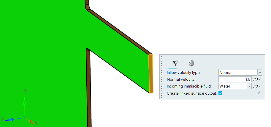

Select the inlet surface shown in the figure below.
Figure 14.
In the microdialog,
- Set the Inflow velocity type to Normal.
- Set the Normal velocity to 1.5 m/s.
- Select Water as the incoming immiscible fluid.
to execute

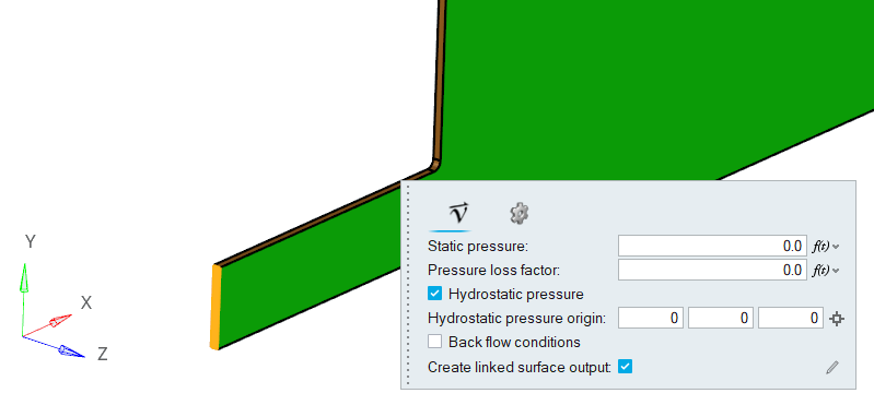

- In the microdialog, activate Hydrostatic pressure.
to execute

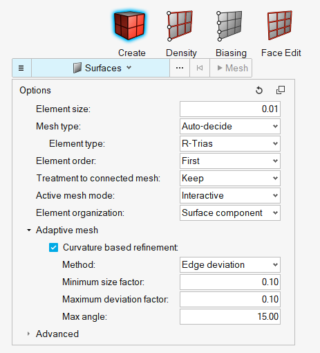

By default, the Create should be selected from the secondary ribbon. -
Click
on the guide bar to open the options menu, then make the following
changes:
Figure 18.
- On the guide bar, change the entity selector to Solids then select the solid in the modeling window.
- Click Mesh in either the microdialog or on the guide bar to generate the surface mesh.
- Once the surface mesh is created, press Esc to exit out of the tool.

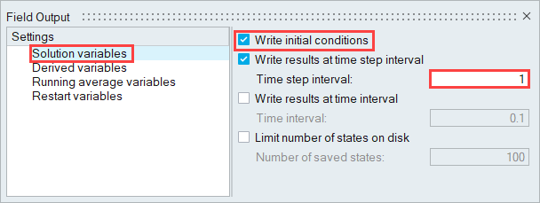

From the Solution ribbon, click the Field tool.
Figure 21.
The Field Output dialog opens. - Click the Solution variables setting.
- Activate the Write initial conditions option.
- Verify that the Write results at time step interval option is active.
Set the Time step interval to 1.
Figure 22.

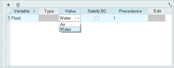

In the microdialog, click
in
the top-left corner, select Fluid, then click in empty
space in the dialog.
Change the Value field to Water.

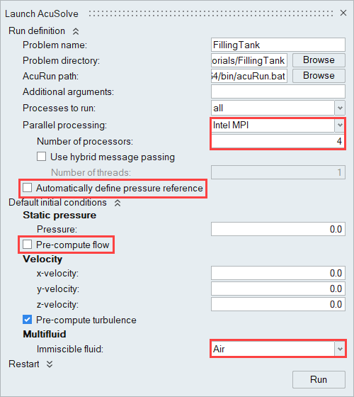

The Launch AcuSolve dialog opens. - Set the Parallel processing option to Intel MPI.
- Deactivate the Automatically define pressure reference option.
- Expand the Default initial conditions tab and deactivate the Pre-compute flow option.
- Set the x-velocity to 0.
- Set the Immiscible fluid to Air (if not already set).
Leave the remaining options as default and click
Run to launch AcuSolve.

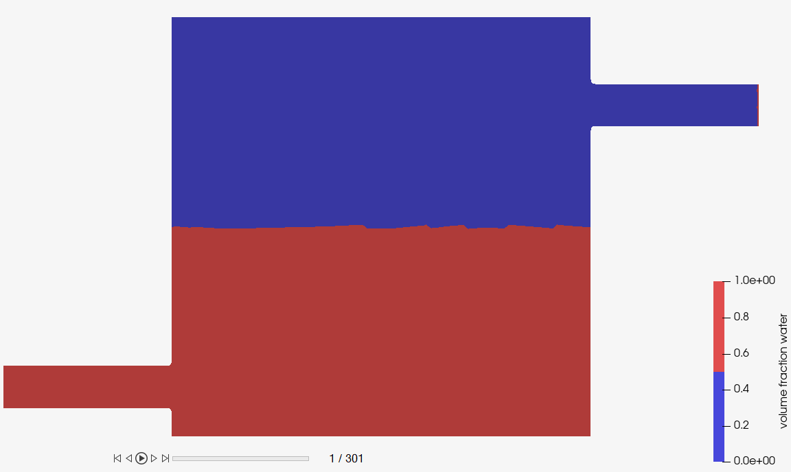

Post-Process the Results with HM-CFD Post
- Once the solution is completed, navigate to the Post ribbon.
- From the menu bar, click .
Select the AcuSolve log file in your problem
directory to load the results for post-processing.
The solid and all the surfaces are loaded in the Post Browser.
Click the Top face on the View Cube to align the
model.
Figure 30.
- Right-click on the z_pos boundary in the Post Browser and select Edit.

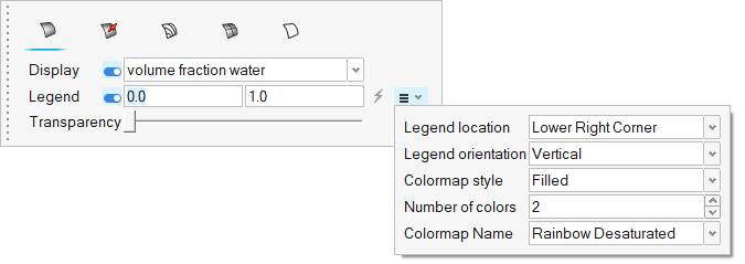

- In the display properties microdialog, set the display to volume fraction water.
Activate the Legend toggle and click
to refresh the range.
Click
, set the Colormap style to
Filled, the Number of colors to
2, and the Colormap Name to Rainbow
Desaturated.
Figure 31.
Click
on the guide bar.
Click
at the bottom of the modeling window to view a live animation of the flow.
Figure 32.
Save the animation.
