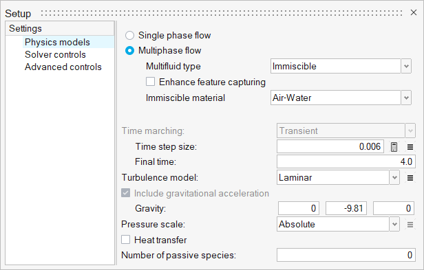

The Setup dialog opens. -
Under the Physics models setting:
- Activate the Multiphase flow radio button.
- Set the Multifluid type to Immiscible and the Immiscible material to Air-Water
- Set the Time step size to 0.006 and the Final time to 4.0
- Select Laminar as the Turbulence model.
- Set the gravity to -9.81 m/sec2 in the y direction.
- Select Absolute for the Pressure scale.
Figure 5.

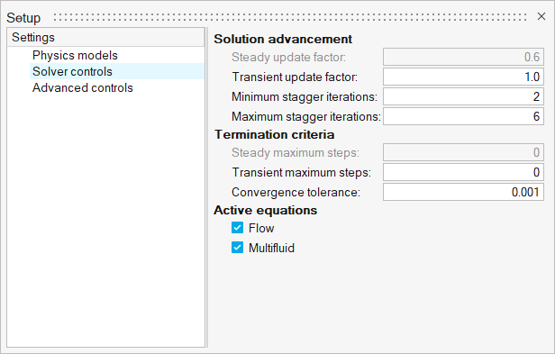

Click the Solver Controls setting.
- Set the Minimum stagger iterations to 2.
- Set the Maximum stagger iterations to 6.
Figure 6.

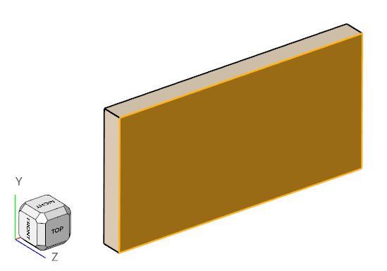

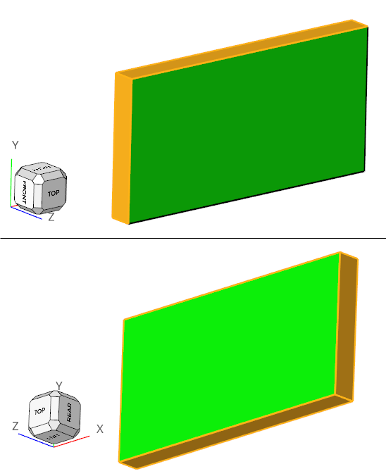

Click the Slip tool.
Figure 12.
Select the right most face on the positive z-axis, as shown in the figure
below.
Figure 13.
- In the Boundaries legend, double-click on Slip, rename it to z_pos, then press Enter.
On the guide bar, click
to execute the command and remain in the
tool.
- Rotate the model and select the opposite face.
- In the Boundaries legend, rename Slip to z_neg.

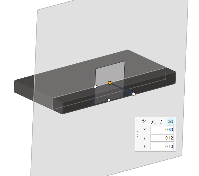

From the Solution ribbon, click the
Plane tool.
Figure 14.
- Select the solid body.
- Click Plane on the guide bar.
- Click any point on the model to initially position the plane.
Click
in the microdialog and
manually set the plane axis to Y.
Figure 15.
Click
and set the coordinates to (0.60, 0.12,
0.10).
Figure 16.
- Press Esc two times.

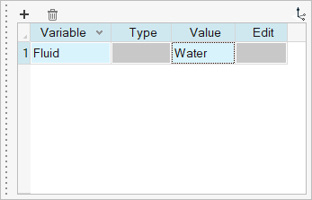

Click
to add a variable then select Fluid from the
list.
Make sure that the Value is set to Water then press
Esc again.
Figure 17.

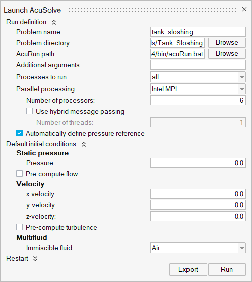

Run AcuSolve
Figure 20.
The Launch AcuSolve dialog opens. - Set the Parallel processing option to Intel MPI.
- Expand the Default initial conditions tab and deactivate the Pre-compute flow and Pre-compute turbulence options.
- Set the x-velocity to 0.
Leave the remaining options as default and click
Run to launch AcuSolve.

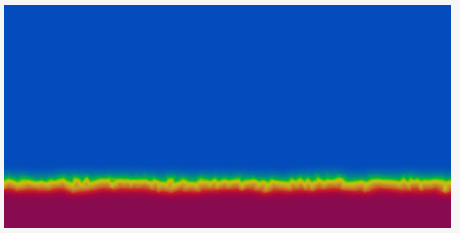

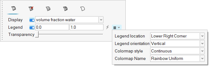

- Right-click on the z_pos boundary in the Post Browser and select Edit.
- In the display properties microdialog, set the display to volume fraction water.
Activate the Legend toggle and click
to refresh the range.
Click
, and set the Colormap Name to Rainbow
Uniform.
Figure 23.
