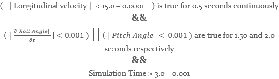

| COLUMN1 | String | REQUIRED <SIGNAL> Key word for the signal name. |
| COLUMN2 | Integer | REQUIRED <GROUP> Unique number for the group. Same group signals are OR-ed together whereas different group number signals are AND-ed together. |
| COLUMN3 | Bool | REQUIRED <ABS> Absolute value. If true absolute value of the signal is compared. |
| COLUMN4 | String | REQUIRED <OPERATOR>
| COLUMN5 | Real | REQUIRED <VALUE> Compare value |
| COLUMN6 | Real | REQUIRED <TOLERANCE> Comparison tolerance |
| COLUMN7 | Real | REQUIRED <WATCH TIME> All sensors are watched for this value of specified time as soon as the condition is true for the very first time. Sensor gets actuated when the condition is true continuously for watch time. |
$Example ADF end conditions block
(END_CONDITIONS)
{SIGNAL GROUP ABS OPERATOR VALUE TOLERANCE WATCH_TIME}
LONG_VEL 0 Y LT 15.0 0.001 0.50
ROLL_ANGLE 1 Y SS 0.0 0.0001 1.50
PITCH_ANGLE 1 Y ET 0.0 0.0001 2.0
TIME 2 N GT 3.0 0.001 0.00
