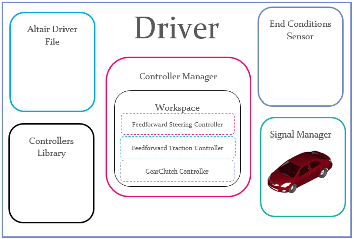

Architecturally, the Altair Driver is a cluster of signal manager, controller library, and controller manager.
| Controller | Logical unit of the driver computes outputs for given inputs. |
| Controller Library | Library of the available controllers. |
| Controller Manager | Parses through the Script, Altair Driver File (ADF). This manager does this
following:
| Signal Manager |
| End Condition Sensor | Monitors the end conditions and switches the maneuver when the end condition is true. |
