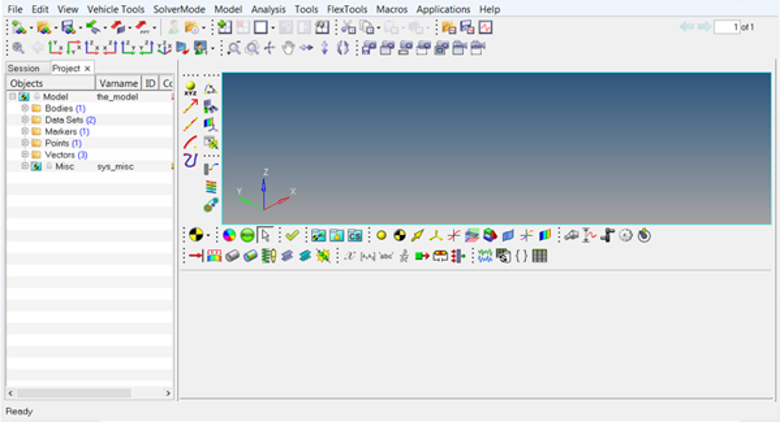

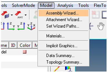

- Start MotionView from the installation folder.The MotionView window is displayed.
- Click .
The Car/Small truck - Model Type dialog opens.

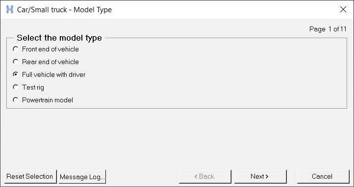

- Select the Full vehicle with driver option from the Model
Type dialog and click Next.

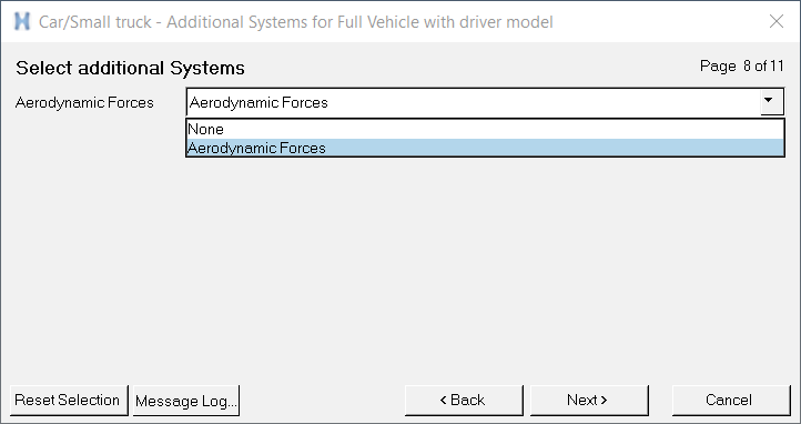

- Select the Aerodynamic Forces on the additional systems
page and complete the model selection.
Figure 4.

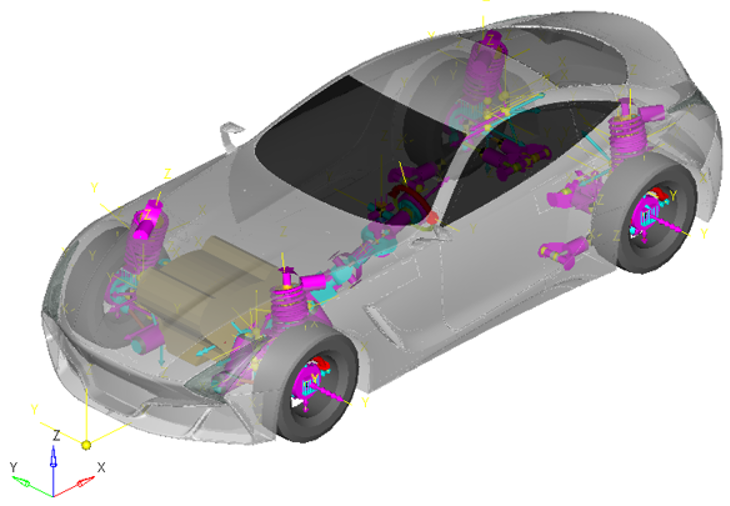

Note: Aerodynamic Forces is now included as a system. - The Full vehicle with driver model including the aerodynamic forces system build
through the Assembly Wizard is displayed in the graphics area.
Figure 5.

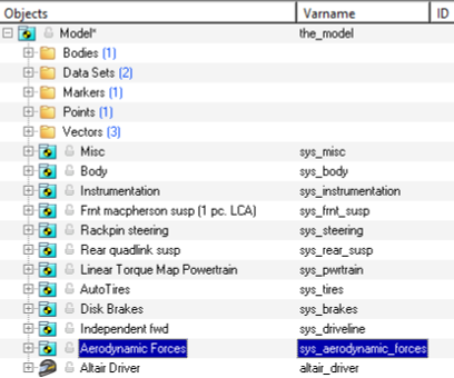

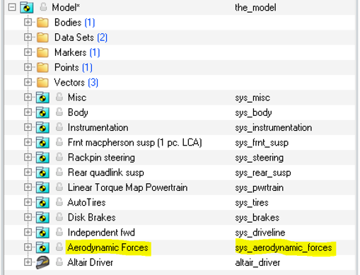

- The subsystems with the Aerodynamic Forces you have selected in the Assembly
Wizard to build the model are displayed in the browser.
Figure 6.
