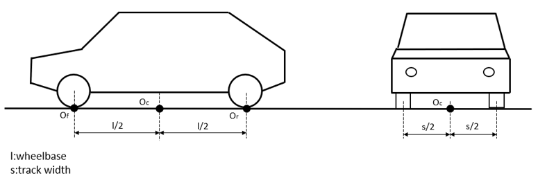

The following is an aerodynamics concept as proposed by Manfred Mitschke and Henning Wallentowitz 1.
The resultant aerodynamic force and torque is considered to act on a reference point Oc placed on the road surface at the center of the four wheels.

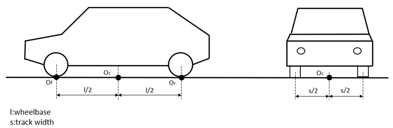

The vertical force Fa,z and the pitch torque Ma,y are replaced by two vertical forces acting at the center points of the suspensions Of and Or at ground level introducing cz,f and cz,r.
Fa,zf = cz,f(τL)*P(vr)
Fa,zr = cz,r(τL)*P(vr)The action forces are applied at reference point Oc placed on the road surface at the center of the four wheels and the center points of the suspensions Of and Or at ground level.
This aerodynamic system is the default setting in the Assembly Wizard for the Car and Truck Library.
