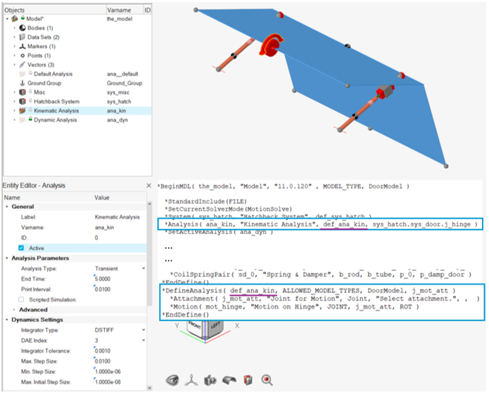

The following simple example model demonstrates the concept of an analysis. This model is available at ~hw_install/demos/mv_hv_hg/modeling/container_entities/system_analysis/door.mdl. The model has been arranged into a system called hatchback system, which in turn has two child systems; the door system and the damper system. The images below show a simplified model of a hatchback door of a car with the model MDL file shown alongside.
One analysis is a kinematic analysis, which is accomplished by adding a motion to the hinge joint in the door system.

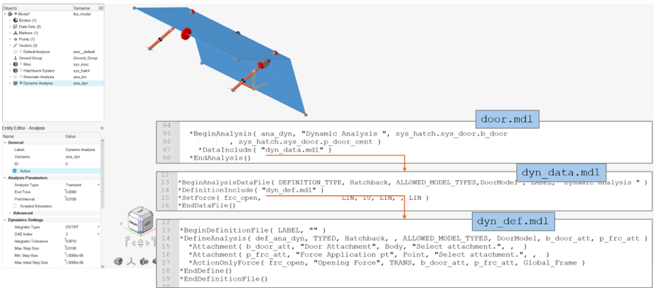

Another analysis is a dynamic analysis, which is accomplished by applying a force at the end of the door. These two events are exclusive. For example, the motion of the hinge joint is not applied when the force is applied and vice-versa.
- The entire model information is contained within a *BeginMDL - *EndMDL block in the door.mdl (model file).
- Apart from the two system instances and their definition block, the model
contains an *Analysis statement that instantiates the
kinematic analysis (ana_kin). This analysis instance
refers to the analysis definition (def_ana_kin) within
the *DefineAnalysis block in the model file.
- The door hinge joint from the door system is passed as an attachment to the analysis. A motion is defined that uses this attachment.
- The data related to the motion is within the *BeginContext
(ana_kin) block.
- The model file also contains a *BeginAnalysis block that
instantiates the dynamic analysis.
- This block refers to the data file (dyn_data.mdl) which in turn refers to the definition file (dyn_def.mdl).
- The door body and the center end point at the door are passed as attachments to this analysis. A force entity is defined that uses these attachments.
- The force data is contained in the data file.
- The MDL structure is similar to that of the assembly. The data is
contained within *BeginAnalysisDataFile. The
analysis definition block *DefineAnalysis in the
definition file is contained within
- The *SetActiveAnalysis statement controls which analysis is active.
