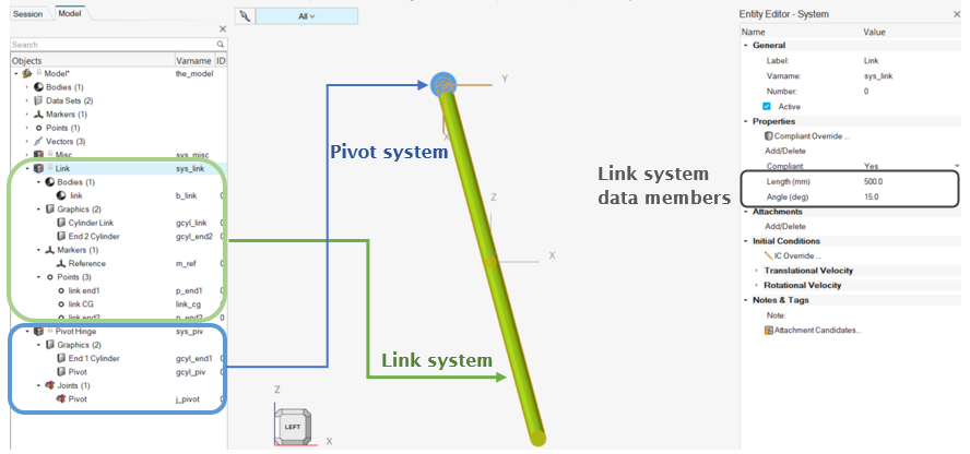

- Link Model
- The following image shows the system arrangement of the Link model.
Figure 8. Link Model
The model is arranged in two systems: Link system and Pivot system.
Link system consists of:- Data members Length and Angle (added using the Properties section in the Entity Editor).
- Point link end1 is an independent point.
- Marker Reference at point link end1. Its orientation is free.
- Point link end2 is defined in cylindrical coordinates in the Reference marker frame with the Length and Angle as parameters using the loc_cylindrical function. The point is located on the XY plane of the marker.
- Point link CG is a point between points link end1 and link end2.
- Body link.
- Graphic Cylinder Link for the body link defined between end points.
- Graphic End 2 Cylinder at link end 2.

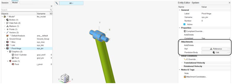

Pivot System

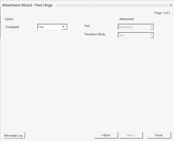

The purpose for the pivot system is to constrain the link to Ground Body at one of the ends. It is desired to provide more than one variation (hinge or ball) to the pivot system while assembling the link model using the wizard.- Pivot Hinge
- In this system, the link will be constrained using a
revolute joint at the Reference marker origin and
oriented along its Z axis. Since the link body and
Reference marker are in a different system (link), to
maintain modularity, these entities are input to the
pivot system as attachments.
Figure 9. Link Model - Pivot System (Hinge)
The system consists of:- Attachments – Ref (Marker) and Pendulum Body (Body).
- Joint Pivot – Revolute
joint between the attachment Pendulum
Body & Ground Body at
Ref marker’s origin along
Ref marker's Z axis.Note: Origin and alignment axis must be resolved using Advanced selection to refer to the attachment’s child attributes.
- Graphics for the joint – graphic’s body, origin and direction refer to the joint Pivot attributes.

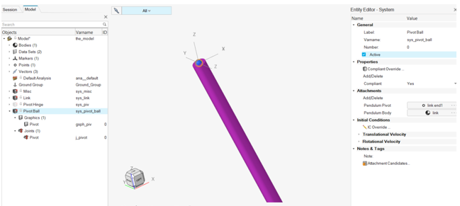

- Pivot Ball
- The pivot ball is similarly constructed as the hinge
system above, except the type of joint used is a Ball
joint instead of revolute. The system can either be
created in the same model or a separate model can be
created.
Figure 10. Link Model - Pivot System (Ball)

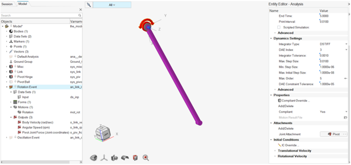

Analyses- Rotation Analysis
- Imposes a constant velocity motion on the revolute joint
of the Pivot Hinge. When building the wizard, this
analysis will only be available when the Pivot system is
of type Hinge.
Figure 11. Link Model - Rotation Analysis
The analysis contains:- Attachment Joint Attachment to apply motion.
- Dataset Input for speed of rotation.
- Form that links to the dataset (Form can be added by editing the MDL).

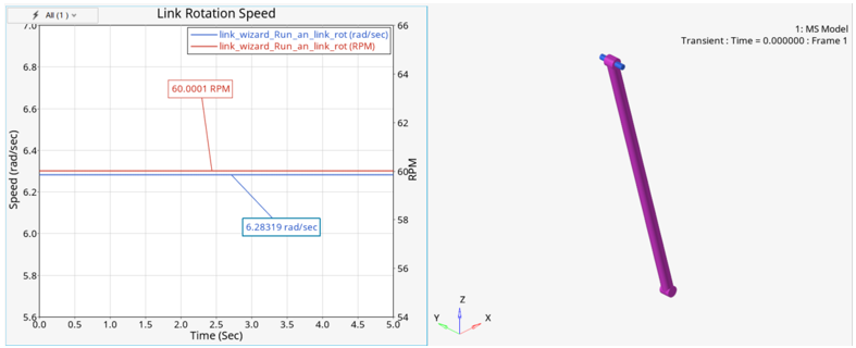

- Report – A report that plots the rotation speed in HyperGraph and animates the results in HyperView. The report refers to a definition in a report template and can be created by the following method.
Solve the model and create plots and animation on a separate page in the session.Figure 13. Results Plot for Rotation Analysis
Save the session () as a report template.

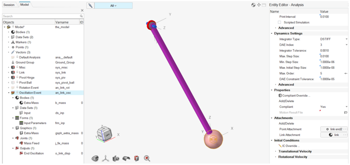

- Adds an extra mass to the link and lets the link
oscillate under gravity.
Figure 14. Link Model - Oscillation Analysis
This analysis contains:- Attachment Point Attachment and Link Attachment (Body) to add extra mass at the link end.
- Body and Graphics Extra mass.
- Dataset Input for mass of Extra Mass.
- Output to measure oscillation.
- Report – A report definition that plots the oscillation of the mass in HyperGraph and animates the results in HyperView.

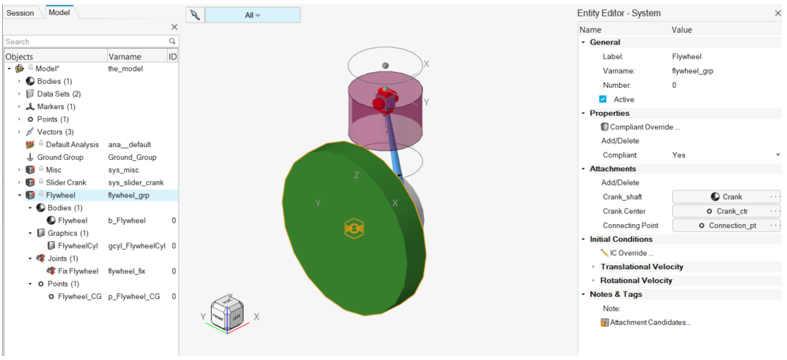

Flywheel system consists of:Figure 15. Slider Crank Model
- Attachments – Crank_shaft, Crank Center, and Connecting Point.
- Flywheel body with graphic.
- Joint – Fixed to Crank_shaft at Connecting Point.
- Flywheel CG at Crank_shaft.

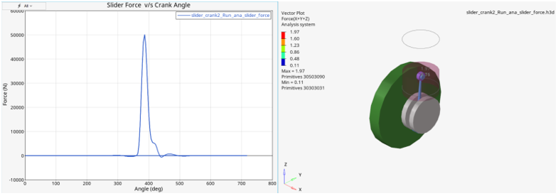

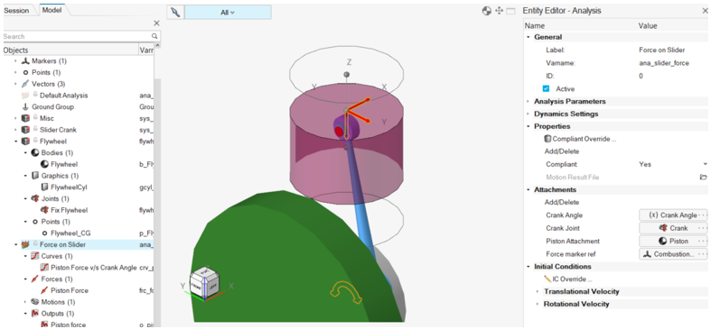

- Analysis – Force on slider
Figure 16. Slider Crank Model - Analysis Force on Slider
- Attachments – Crank Angle (SolverVariable), Crank Joint (Joint), Piston Attachment (Body), Force marker ref (Marker).
- Curve – Piston Force v/s Crank Angle.
- Piston Force – on Piston Attachment at Force marker ref-origin. Force is applied using the Curve Piston Force v/s Crank Angle with Crank Angle as the independent variable.
- Motion – Rotational Velocity Motion on Crank Joint.
- Output – Piston force on Piston Attachment.
- Report – A report that plots the Force on the piston against the Crank Angle along with an animation window by the side.
Figure 17. Results Plot for Force on Slider

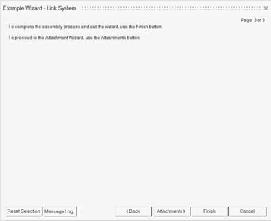

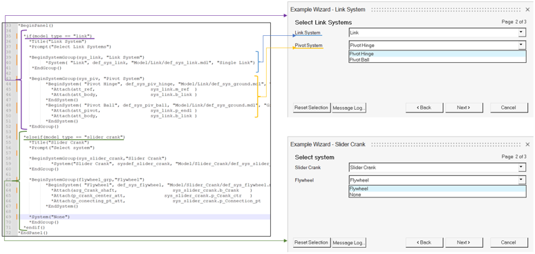

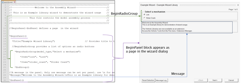

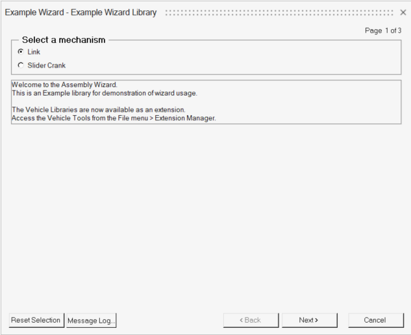

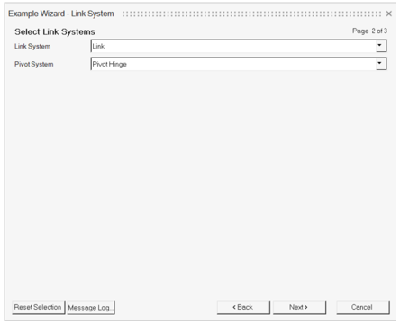

- Each panel that appears with options such as radio buttons or drop-down choices are defined within a *BeginPanel() - *EndPanel() block.
- *Title() can be used to specify a title for the panel.
- *BeginRadioGroup() - *EndGroup() defines a radio choice within the
panel.
Figure 18. Assembly Wizard Statements to Dialog Mapping
- Use the *if-elseif-else-endif() block to branch out further system selection
based on previous radio or system selections.
Figure 19. Assembly Wizard Statements to Dialog Mapping - Conditional Branching
- *BeginSystemGroup() - *EndGroup() is used to define a system selection
choice. This appears as a drop-down option in the dialog.

- *Message can be used to have a message at the bottom of the panel.
- Only one *Message is allowed on a panel.
- Message should appear in a single line entry. Use /n to display the message in multiple lines in the dialog.
The wizard can contain several BeginPanel blocks. At the finish, MotionView will instantiate the systems that are selected under each panel. It will also resolve the attachments.
The wizard selection choices are also saved in the model file.

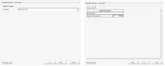

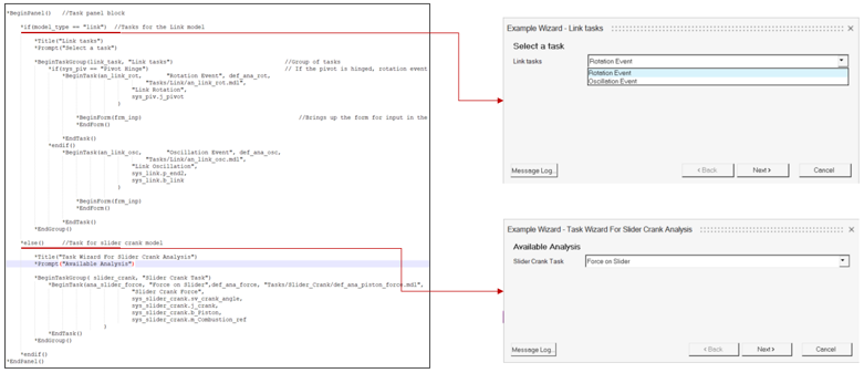

Author the Task Wizard File
- The tasks are listed using *BeginTaskGroup() within one *BeginPanel() block.
- Use *if-elseif-else-endif block to customize the task group based on model
or system selections. The if block can also be used within *BeginTaskGroup()
to customize the tasks.
Figure 20. Task Wizard Statements to Dialog Mapping

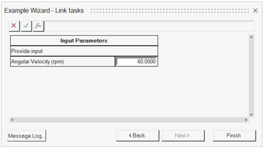

- Each task is defined using a *BeginTask() block that refers to an analysis definition within a definition file (mdl). Attachments to the analysis are also passed as arguments in this block.
- A *BeginForm() can be used to bring up a form that is defined in the
analysis once clicking Finish.
Figure 21. Form in Task Wizard

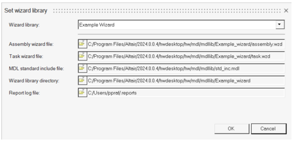

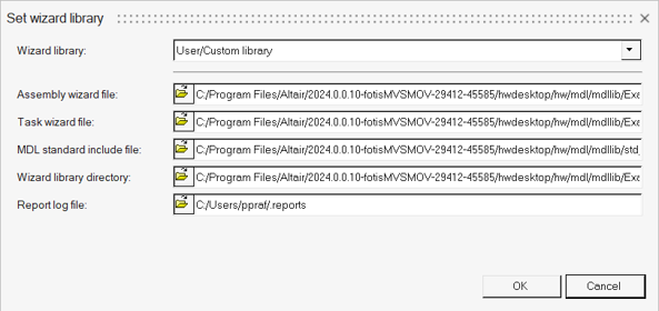

Once all the system definitions and wizard files are ready, it is time to register the wizard files, so that the wizards can be invoked through the graphical user interface.
| Assembly Wizard file | File containing Assembly Wizard code in the MDL Wizard language. |
| Task Wizard file | File containing Task Wizard code in the MDL Wizard language. |
| MDL standard include file | This file is read at the start up of MotionView. This file can contain any model defaults in the MDL language. It is recommended to use the std_inc.mdl which is part of standard include. If any additional defaults have to be provided, please include the std_inc.mdl using the *Include() statement and then followed by other statements. |
| Wizard library directory | Folder containing the system, analysis, report and any other reference files used in the wizards. |
| Report log file | Reports in the model are logged during the runs and are stored in this file. Information from this file appears in the dialog in the Analyze ribbon that can be used to plot automated reports for the run. |
- User/Custom library – in the
Settings dialog of the Wizard group in the Assembly
ribbon.Figure 22. Wizard Settings
This option allows registering only one library.
