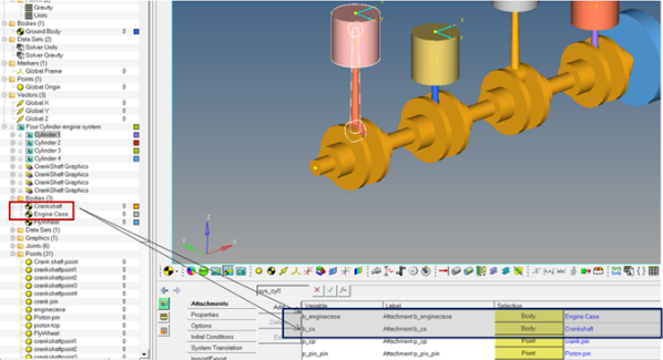

Example
The image below shows a Cylinder 1 system in a four cylinder engine model. The Crankshaft and Engine Case bodies are external to the Cylinder 1 system. To define joints or forces between any of these bodies and bodies inside the Cylinder 1 system: attachments with variable names b_crankshaft and b_enginecase are declared as attachments to the system, and these two bodies are referred to as the variable entity.
In the MDL, the attachment is defined by the *Attachment() statement in the container entity definition block.

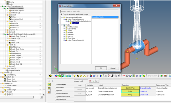

Shown below is the Cylinder 1 assembly which seeks a crank pin attachment point. This attachment (variable p_cp_att) has a “CrankPin” attachment tag. The crank pin point in the crank shaft assembly has a attachment candidate tag that has the value “CrankPin”.
Upon clicking the Point collector for this attachment, the Model Tree that is automatically displayed in the Select a Point dialog will have a Recommended Entities folder which lists the crank pin point in the crankshaft assembly.

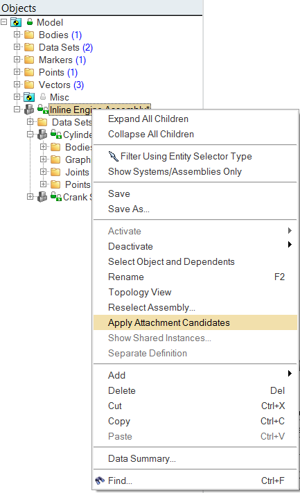

In addition, the right-click context menu for any container in the Model Browser also has an Apply Attachment Candidates option.
This option resolves all attachments for a container automatically, by finding entities with attachment candidates that have the same string as that of attachment tag on attachments. If there is more than one entity as candidate for an attachment, a dialog is displayed which allows you to resolve it manually.

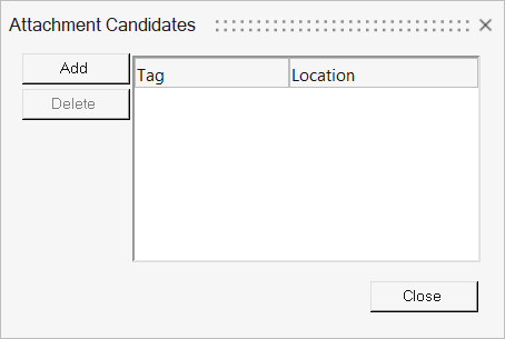

An entity is declared as an attachment candidate by using the Attachment Candidates button in the Entity panel.
- Select the entity to be declared as the attachment candidate.
From the entity panel, click
The Attachment Candidates dialog is displayed.Figure 5.
Click Add.

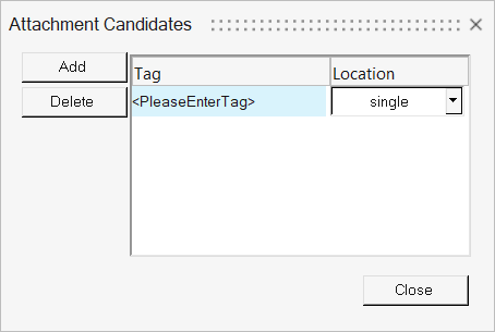

A tag entry is included in the dialog.
Click on the Tag field (indicated by
<PleaseEnterTag>) and input a string.
Figure 6.
Select an option from the Location drop-down menu.
For single entity types, single is the only option that is available. For pair entities, the tag can be applied for the pair, or left, or right.
Click Close to create the attachment candidate.
