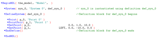

Container entities such as systems, assemblies, and analyses are referred to as definition based entities, along with others such as data sets and templates. These entities are created (called by instances) by an instantiation statement in the MDL that refers to a definition block (see an example below):

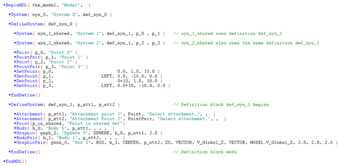

Accordingly, it is possible that multiple instances can be instantiated off of the same definition block. Such instances are referred to as shared instances or linked instances. Therefore, two or more systems instantiated by referring to the same definition block are said to be shared systems or linked systems. The sharing can only be established through authoring a model using the text editor in the MDL language. It is not possible currently to create shared instances using the MotionView graphical user interface. An example is show below:

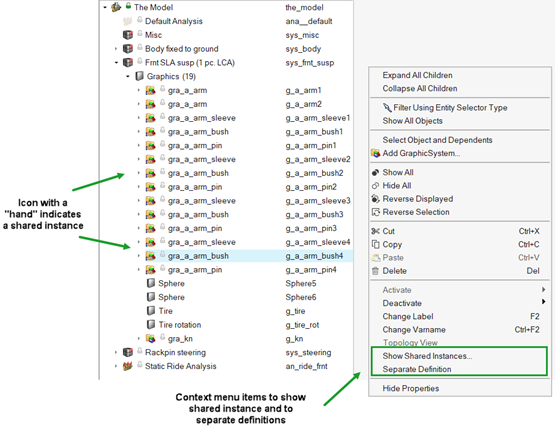

Improved support for shared instances has been provided in the MotionView graphical user interface:
- The Model Browser indicates the sharing between instances
with a separate hand icon appended to the standard icon of the entity. This
change is applicable to the following entities: systems, analysis (inline),
graphic systems, data sets, templates, command sets, and forms.
Figure 3.
- The Model Browser right-click context menu provides the
following options (shown in the image above):
Show Shared Instances Allows you to view information related to shared instances. Separate Definition Allows you to stop sharing the definition. See the Browser Context-Sensitive Menu topic for additional information.

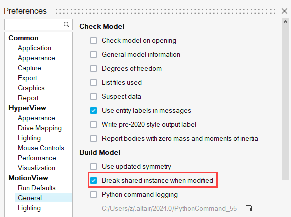

- You have the choice of retaining the linkage between shared instances as the individual instances get modified, or to break linkage.
- A Break shared instance when modified option is available in
the MotionView > Build Model section of the Preferences dialog (File > Preferences) which allows you to control how shared instances should be
handled while modifying them.
Figure 4.
By default, this option is turned on indicating that any modification to a shared instances will result in a separate definition. Turn this option off in the case where the sharing has to be retained and a change to one instance should be applied to other shared instances also.
With the above changes, it is now possible to control how shared instances will get affected when modifying instances. The above changes are applicable for all definition based entities except assembly and external analysis.
