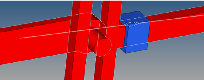

- Material Inside for a graphic indicates the
graphic has material within the closed volume. Consequently, the surface
normals of the geometry point outward of the graphic surface. When the
option is turned off, the surface normal of the geometry points inward.
This flag is useful for reversing the surface normal to simulate
internal contact.

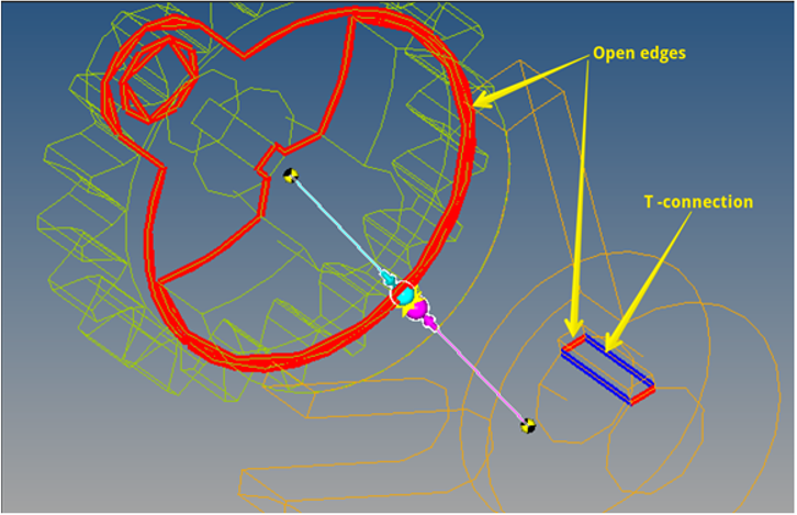

- The individual graphics involved in contact should form a closed volume.
In other words, the graphic mesh should not have any open edges or
T-connections. Use the Highlight mesh errors option to check for open
edges and T-connections. An open edge is highlighted through a red line,
while a T-connection is highlighted using a blue line. For better
visibility, the visualization of graphic components involved is changed
to a non-shaded mode.Note: If no mesh errors are found, this option will be disabled and will display No mesh errors.

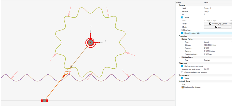

Note on 2D Contacts
- The individual curve graphics involved in 2D contact must use planar curves only. A planar curve has all its data points in a single plane.
- Currently, MotionView only supports 3D
Cartesian/parametric curves for creating curve graphics that can be used
in 2D contact. Below is an example of how the Highlight
contact side option works:
Figure 3.
The example above shows a rack and a pinion represented with curves and a 2D contact defined between them. The side of the pinion on which the arrows are pointing (which is outside) indicates the side the contact is expected. Similarly, the arrows on the pinion curve have arrows pointing on it from the outside.
In the case where the contact is expected from the opposite side, the Flip Contact Side option can be used.
