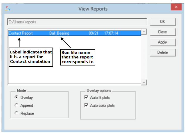

From the Analysis menu, click View Reports.
The View Reports dialog is displayed.Figure 2. The report item (Contact Report for the last submitted run) will be listed at the top.
Select the item and click OK.
