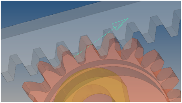

Inspect the results in the graphics area.
Figure 3.
By default the contact force results are displayed at each element (of the first body in the contact pair) in contact.

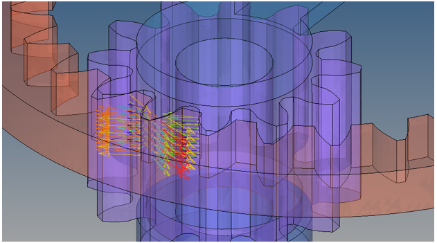

To visualize force as a sum at a particular region of contact, turn on the
component Contact Region Output, by clicking on it in the
browser. Next, turn off all other components with labels starting with
Contact Graphics.
Figure 4.
Use the above mentioned steps to apply a display of the forces in the graphics
area.
