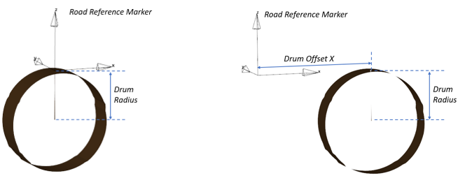

- Drum Positioning
- By default, the drum is automatically positioned at the tire contact patch of the
AutoTire it was specified. The Drum center is located below the tire patch with a
distance Z of the Drum radius.
Figure 1. Default Drum Position
The drum can be place at a different location by using the offset option in the road file .rdf. When this option is used, the drum road refers to the road reference marker.Figure 2.
The X, Y, Z offset must be given using the following terms in the .rdf file:DRUM_CENTER_X_OFFSET = -1500 $DRUM_CENTER_Y_OFFSET = -750 $DRUM_CENTER_Z_OFFSET = 0It is not necessary to give all the coordinates. The above example contains only the X location of the drum center (the Y and Z location has been commented out). In such case the value of Y and Z has no offset and will be the same as indicated in the default definition, that is, placing the drum’s surface below the tire.

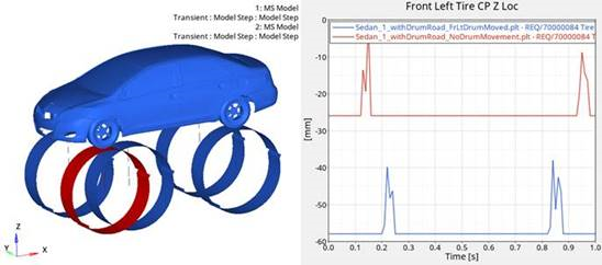

Each tire in the vehicle model can receive a drum road file, with this approach you can specify different movement and road irregularity for a particular drum.
To enter a different drum road at each tire in a pair defined entity, the left-right symmetry of the AutoTire entity panel must be removed to enable right and left road definition.Figure 3.
The image below shows the comparison of the front left tire's drum offset X -1500mm.Figure 4. Drum Movement
