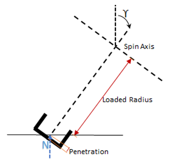

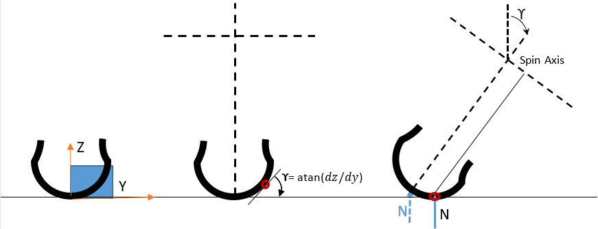

Single Point Contact
This is the default contact method that is used with the Fiala model. This model assumes the "disc" shape for the tire and rim and calculates the contact point at the intersection of the wheel plane with the road tangent.Motorbike tires have more curvature when compared with a car tire. At an inclination angle, the theoretical contact point shifts in the lateral direction. The geometry of the tire carcass is used to model this behavior.

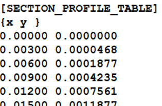

The SECTION_PROFILE_TABLE contains the data of the tire carcass. The table should contain two columns as shown below:
The {x y} in the above table represents the height variation of carcass (y) with respect to points along the carcass width (x). Data for only half of tire carcass is needed as the tire is assumed symmetric about XZ plane in the ISO system. The data points should be monotonically increasing otherwise they will be ignored and the tire contact with will be calculated assuming a rectangular section.
If the SECTION_PROFILE_TABLE is used, the WIDTH option representing the nominal section width of the tire is ignored.

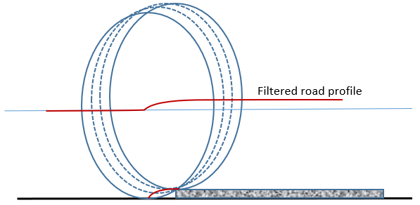

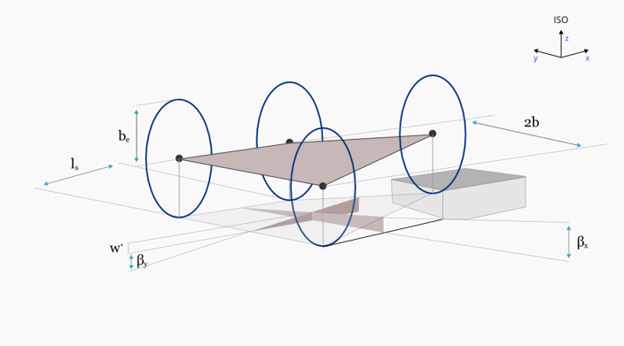

Elliptical Cam Contact Model
- Effective road height variation
- Effective slope variation
- Effective curvature
- Camber change

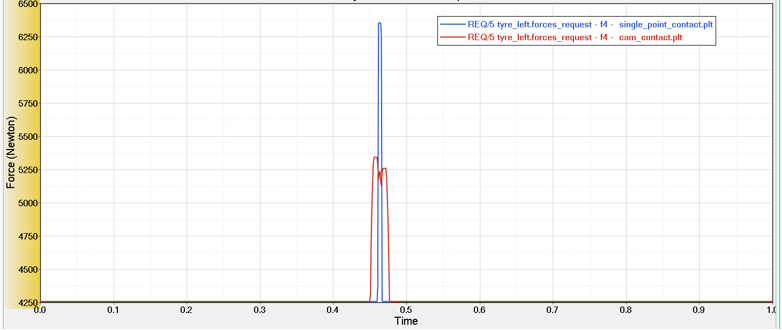

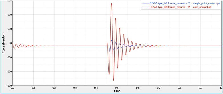

The results show that single point contact model predicts higher values of vertical force because it traces the obstacle, however the actual force experienced by the tire is less which is closely predicated using cam contact method.

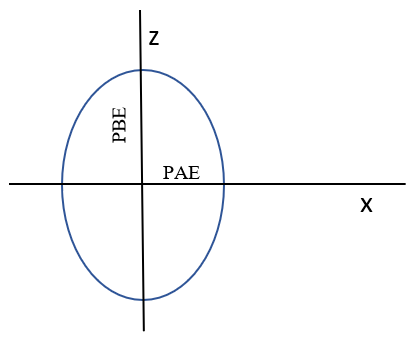

| PAE | Half of the ellipsoid length. | Length |
| PBE | Half of the ellipsoid height. | Length |
| PCE | Order of the ellipsoid. | - |

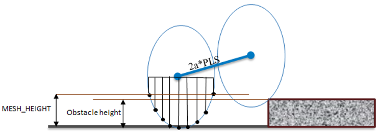

| MESH_HEIGHT | Height of the end points of the ellipse mesh. It should be greater than the obstacle height. |

The equation for the shape of cam can be written as:
In case no data is available, a good estimate of PAE and PBE is equal to tire radius. The ellipse dimension can be calculated by measuring the outside contour of tire when it touches the obstacle. For PLS a 0.8 is a good value to use. ROAD_INCREMENT decides the meshing size of road it directly affects the computation time of model.
