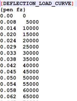

If a [DEFLECTION_LOAD_CURVE] block is present in tire property file, then the data inside the block is used to calculate the vertical force. In this case the VERTICAL_STIFFNESS value is ignored. The data in DEFLECTION_LOAD_CURVE should be monotonically increasing. An example of such table is given below:

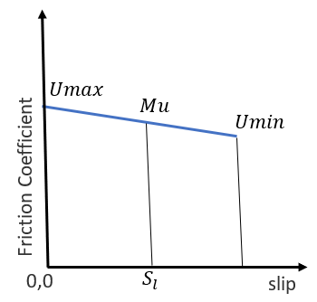

Friction Coefficient
The friction coefficient can be calculated in three ways:- Interpolating the Umax and Umin value using Comprehensive slip.
Figure 2. Friction Coefficient versus Slip

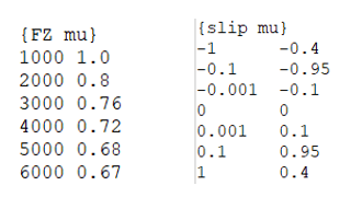

- Interpolating Mu using Vertical Force from a table.
- Interpolating Mu using Slip from a table.
Option 1 is the default option. Option 2 or 3 can be used when you have a table representing Mu versus Vertical Force or Mu versus Slip as shown below:
In such a case, the parameter Mu must be set accordingly to the name of the block containing this table in the [parameter] block.

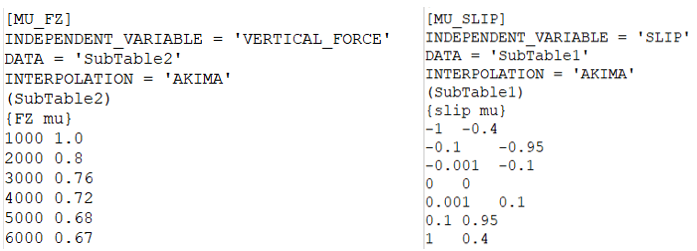

The table data must be provided within a block in the property file as shown below:
| INDEPENDENT_VARIABLE | The friction coefficient is a function of this variable. There are two options: VERTICAL_FORCE and SLIP. |
| DATA | The sub table within this block containing the table data. |
| INTERPOLATION | Scheme used for interpolating the curve. There are four options: LINEAR, CUBIC, AKIMA, QUINTIC. Default = AKIMA. |
To continue supporting previous versions, if the block [MU_SLIP_CURVE] is specified, it will be used without setting the Mu parameter block (MU_FZ or MU_SLIP). In such a case, the friction coefficient is calculated by interpolating the data in the table of the block [MU_SLIP_CURVE].
The data in [MU_SLIP] curve should be monotonically increasing. An example table is shown below:

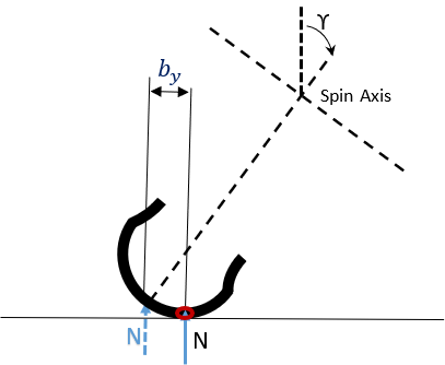

Overturning Moment
An overturning moment is caused by the shift of the contact point (at which the vertical force is applied) in the lateral direction.

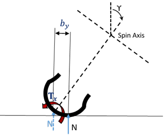

Aligning Torque
The same critical lateral slip used in the Fy calculation is also used in determining the condition of the tire.
In case of elastic deformation state
Where
is half of the contact patch length. The scaling factor here is half of the contact patch
length, however in a FIALA model; the tire width is used as a scaling factor.
