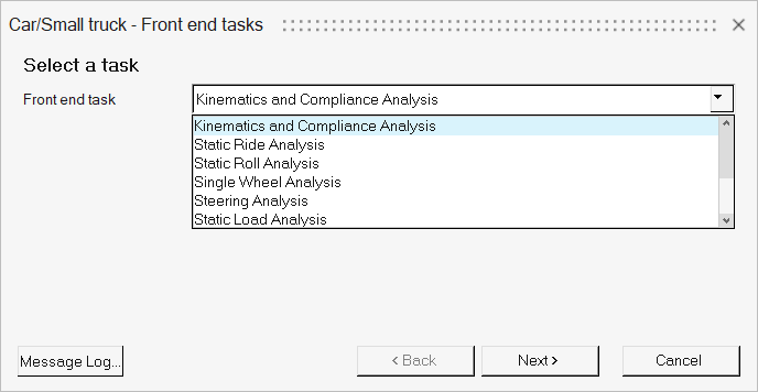

Front End Tasks

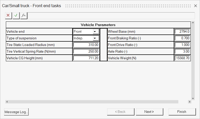

Vehicle Parameters

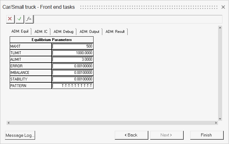

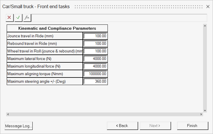

Kinematic and Compliance Parameters
Additional Options and Conditions

Add an Analysis
The analysis may present Forms, if existing, for inputs that configure the
analysis. Upon Finish, the analysis is imported into the
model.
