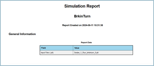

Jupyter reports in MotionView (for Vehicle Models) will take advantage of the interactivity and extensibility that the application offers and provide simulation reports that are created immediately after the solver execution, and are easily editable and sharable.
By using Jupyter reports in MotionView, you can now have one click generated simulation reports that can be easily modified and shared as a PDF or Jupyter Notebook (ipynb) files.

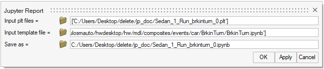

- Generate Jupyter Report
- Generate Jupyter Report satellite (lower) is used when you need to change the
default input parameters for the report creation. This includes the plt files
selection, the input template and the file name of the Jupyter report to be saved. By
clicking OK or Apply, a report with the
specified name will be created and launched.Note: You can plot multiple .plt files in the same report session as long as they follow the same report template.

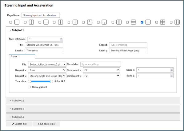

In the next section an Edit mode button is displayed followed by an Index containing a hyperlink to every page. By clicking the Edit mode button, new widgets and buttons will be added to the interface allowing more actions for you. These actions are described below.
User Interface for Interacting with the Plots
All these widgets are used to modify plotting parameters for every curve and every subplot of the page. This includes layout, names labels and titles, input file, request and component signals, scaling and time slicing. At the bottom are two important buttons. The first one, Update plot, is used to refresh any update that has been done to the input plotting values.
Note that if the current Notebook cell runs again, these changes will be removed unless the second button has been also clicked (Save page state). With Save page state, all the new changes can be saved into the report. Also note that when the document is saved from the Jupyter ribbons (File > Save and Checkpoint) all the pages automatically store the new states of the interface widgets. Autosave is disabled to avoid unexpected override.

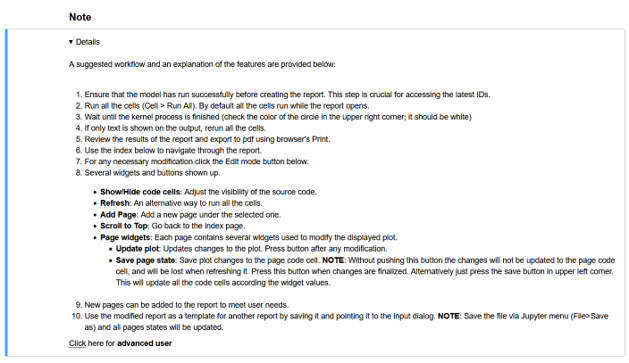

The Show/Hide code cells button will display the input code/markdown cell for the document. This can be used for understanding the report structure as well as to be able to extend the report with custom plots or calculations. Refer to () on how the you could use the data from the loaded .plt to plot custom results. To add new cell from the Jupyter Notebook ribbon click .
The Refresh button is just a shortcut of Run All cells of the Jupyter Notebook’s built-in function. Alternatively, you can use .
The Add Page button provides the option to add a new page above the selected page, including the interface widget for building the plot.
The Scroll to Top button scrolls the document to the index cell.
