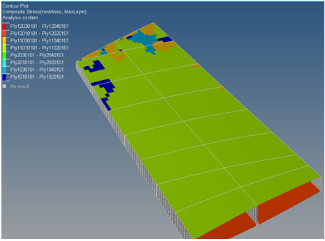

- MaxLayer
- Identifies and plots the layer by name that contributes to the maximum value for each entity.

Figure 1. MaxLayer Contour Plot - Example
Note: The maximum, minimum, or extreme value can be queried using Quick Query, Query Panel, Measures, or from the Notes entry fields (in addition to the layer name). A Category Legend appears for each of these contour plots.Only in the case of results based at the elemental centroid, would one layer per element be displayed. For corner bound or nodal bound results (in the case of averaging), different layers may contribute to the max/min/extreme value at each corner/node of the same element.
