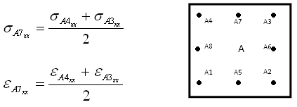

Mid-side nodes refers to the nodes in between the corner nodes of the 2nd order elements.
- The stress and strain tensor of the middle nodes are the average of the corner nodes
tensor.
Figure 1. Example
Note: The mid-side nodes in the example above are: A5, A6, A7, and A8. - Invariant values of the mid-side nodes (vonMises and principal) are calculated using their tensor values.
