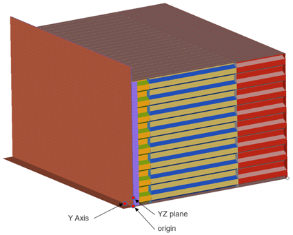

Use the Origin, Y-Axis, and
YZ plane node selectors to define the system at the
back of the barrier frontal block, which will be the reference system for the
projection calculation.

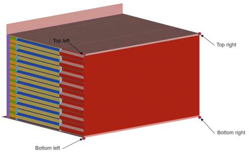

Use the Top right, Top left,
Bottom right, and Bottom left
node selectors to select the four corners of the front face of the
barrier.

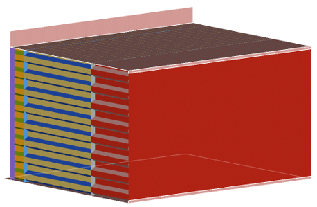

Select the whole components defining the full barrier block.
Figure 3.
Select the outer cladding components of the barrier block.
Figure 4.
