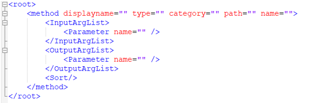

Method Entity Structure
To understand the required steps, you should be familiar with the structure of methods and libraries.
It requires a main block <root> which contains a list of
<method> tags.
You can optionally add attribute name=”user library name” at the
<root> level. The user name displays in the Method
Manager.
<method> tags.

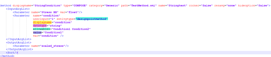

Method Attributes
The method tag, in xml, requires some mandatory attributes, see Figure 1.

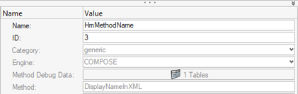

- displayname=" "
- The name displayed in the Method Manager dialog. It serves as an identifier key.
- type="DLL | PYTHON | COMPOSE | TCL"

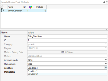

- The engine used to run the method. It is saved as dataname “Engine” in a HyperMesh designpointmethod entity (Figure 2).
- path=" "
- The file path of the Python/Compose/Tcl file where functions are defined. It can be either an absolute path or a relative path from the library file path.
- name=" "
- The true function name as defined in the Compose/Python/Tcl file.
- category="Rivet | Spring | Panel_metallic | Panel_composite | Generic"
- Used to filter the list of available methods in the UI. Category value is on par with designpointset config.
- corner= ”true |false” (def false)
- resavg=”none |simple |min |max |ext | sum” (def: none)
- hideoption=”true |false”
- Can be used to set the default for corner and resavg, but disables you from changing them.

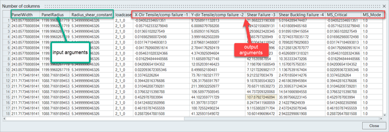

Then, two tags are mandatory to specify the input parameters and method outputs:
- InputArgList
- Defines mapping between method inputs and model/result/user keys to query from the engines. The list of parameters must be ordered in the same way as the method arguments.
- Metadata values
- When the engine runs a method with definition that uses user input parameters, it expects that the data exists at run-time. The engine always uses values defined at the entity level in the database no matter the value set in xml.
- OutputArgList
- Methods can output multiple (pre-defined) results.

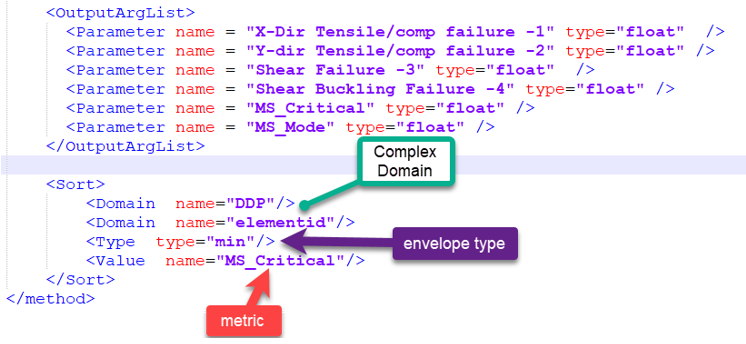

Sorting
Inside method registration, it is possible to add a Sort block. As a result, the method will still be evaluated for each entity inside a designpoint (element | layer) as well as each loadcase.
However, after method run, an aggregation is performed on a Domain using a metric and envelope type. The result of this aggregation is that table output by method will retain only aggregated values. The envelope type can be spatial and/or on loadcases depending on the domain (Figure 6).
- Type (of envelope)
- Valid types are:
- Min
- Max
- AbsMin
- AbsMax
- Value
- The value can be any float parameter either from InputArgList or OutputArgList. It is used as comparison metric.
- Domain
- Domain can be a combination of multiple keys in the following list:
- DDP
- entityid
- elementid
- nodeids
- layerindex
- loadcase
- DDP |entityid |elementid|layerindex |nodeids: Performs a loadcase envelop. If corners or nodal data was considered, they are kept after sorting.
- DDP |entityid |elementid|layerindex: Performs a loadcase envelop. If corners or nodal data was considered, they are aggregated.
- DDP |entityid |elementid|nodeids|loadcase: Performs aggregation across the element’s layers. Keep result per loadcase.
- DDP |entityid |elementid: Performs loadcase envelope. Spatial aggregation to retain critical value per element.
- DDP | entityid: Performs loadcase envelope. Spatial aggregation to retain critical entity (panel or freebody).
- DDP |nodeids |loadcase: Aggregate value on nodes of a given DDP (keep DDP boundaries). Per loadcase.
- Whenever there are critical values across loadcases, contour is available only for envelope loadcases and no more load case per load case.
- Whenever results across layers are aggregated, contour is available only at the element level.
- Whenever an aggregation is done across elements (on a designpoint) the table will have the following: DDP | elementid | loadcase | ..inputs | ..outputs | metric, where metric uses critical values. As a result, only one element ID is kept per designpoint in the table. However, the contour method feature has the ability to select DDP as an entity, which contours a constant value on all elements inside the structural element.
