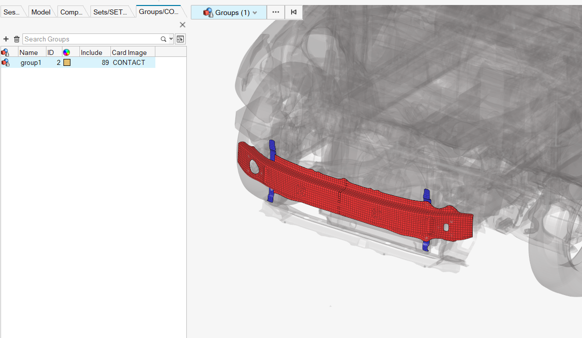

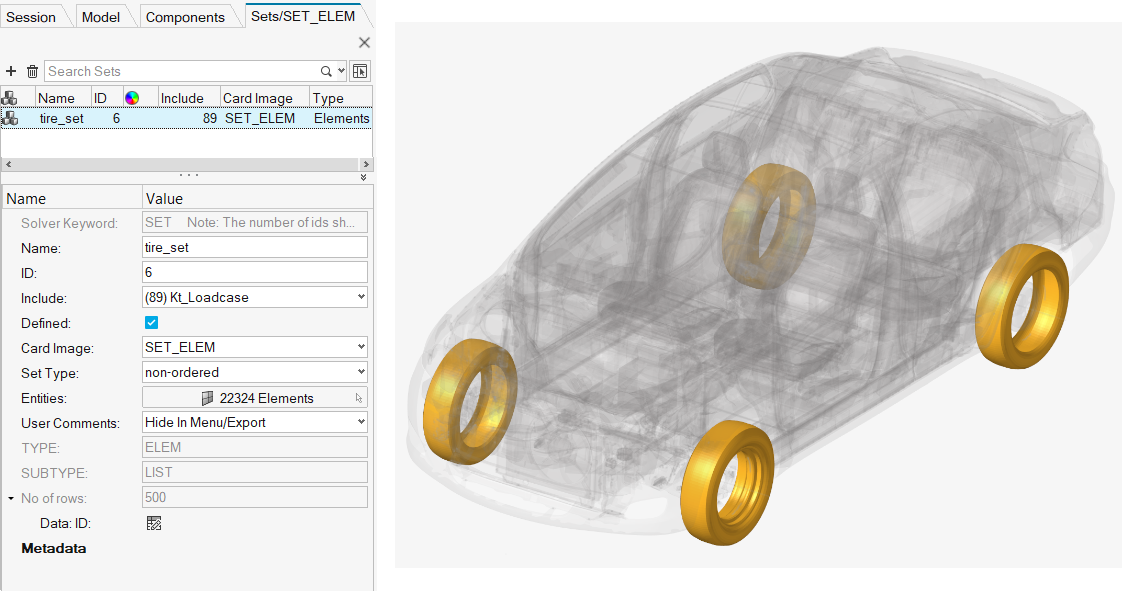

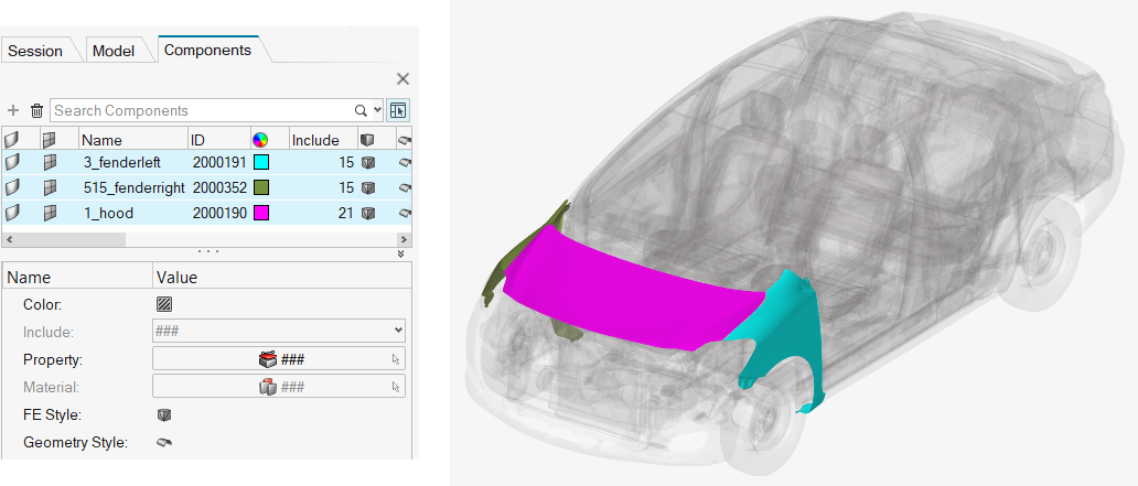

In Review mode, you can review selected entities irrespective of their display state.
Restriction: Only available in HyperMesh.
Select entities to review.
Note: You are only able to review one type of entity at a time.
