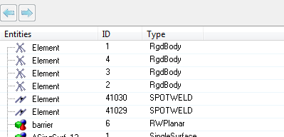

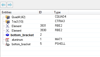

Simplified View
Cross referenced entities are shown in a flat list. If there is more than five instance of a given entity or element configuration, then entities will be displayed in a folder. For elements and nodes, the detailed content of the folders is not exposed, as the number of entities cannot be contained in a folder.

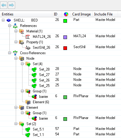

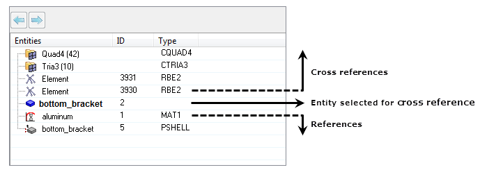

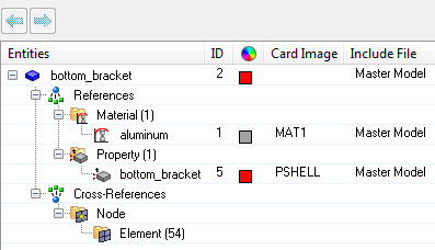

In the Detailed view, related entities are broadly classified into Reference and Cross-reference folders and listed accordingly.
References, represented by
, correspond to entities that are referenced by the
specified selection. The hierarchy is a view down from the selected entities within the model, listing the entities that are referred to by the selection. For
example, in the case of a component, the References folder lists the elements,
material, and property assigned to the component.
Cross-references, represented by
, correspond to entities that reference the
specified selection. The hierarchy is a view up from the selected entities within the model, listing the entities that refer to the selection. For example, in the
case of a component, the Cross-references folder lists the groups, sets, output
blocks, and so on that refer to the selected component. For components, the
Cross-reference folder contains sub folders named Node (
) and Element (
), which lists the entities where the selected component’s node or element is
referred.
