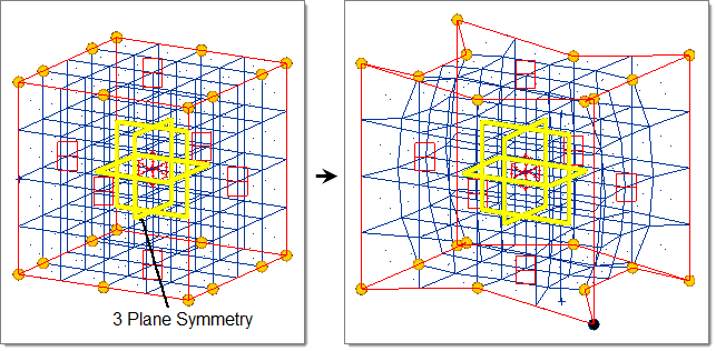

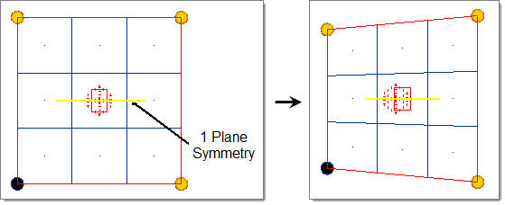

- One Plane
- A mirror is placed at the origin perpendicular to the selected axis (default = x-axis).

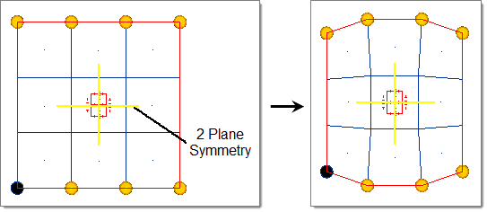

- Two Plane
- Two mirrors are placed at the origin perpendicular to the selected axis and the subsequent axis (that is x and y, y and z, z and x) (default = x and y-axis).
- Three Plane
- Three mirrors are placed at the origin perpendicular to all three axes.

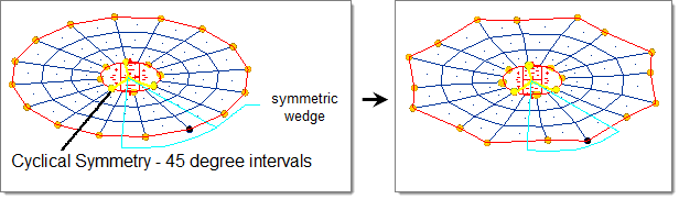

- Cyclical
- Two mirrors are placed along the selected axis (default = z-axis) and running through the origin with a given angle in between that is a factor of 360. The result is a wedge that is reflected a certain number of times about the selected axis.

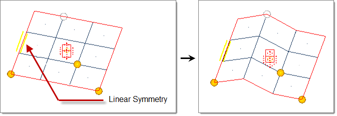

- Linear
- Handle acts as a line drawn through the handle location parallel to the selected axis (default = x-axis).

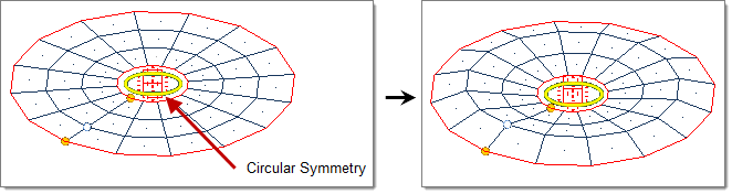

- Circular
- Handle acts as a circle drawn through the handle position about the selected axis (default = z-axis).

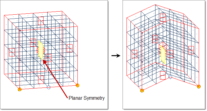

- Planar
- Handle acts as a plane drawn through the handle location perpendicular to the selected axis (default = x-axis).

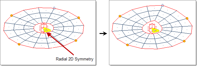

- Radial 2D
- Handle acts as a ray drawn through the handle position originating from and extending perpendicular to the selected axis (default = z-axis).

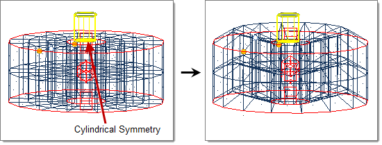

- Cylindrical
- Handle acts as a cylinder drawn through the handle position about the selected axis (default = z-axis).

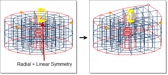

- Radial + Linear
- Handle acts as a plane drawn through the handle position extending from the selected axis (default = z-axis).

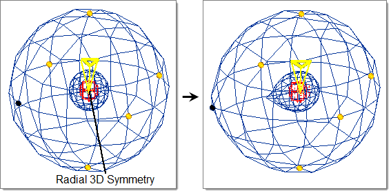

- Radial 3D
- Handle acts as a ray drawn through the handle position originating from origin.

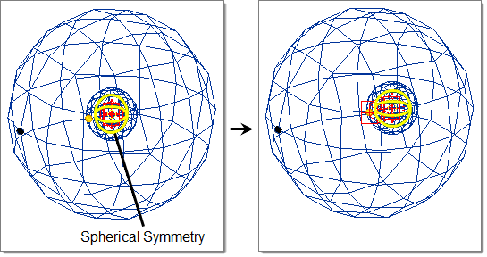

- Spherical
- Handle acts as a sphere drawn through the handle position centered on the origin.
