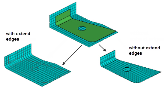

- Toggle
extended surface edges- Extend the edges of the surfaces or mesh in a direction perpendicular to the normal at the closest point on the surfaces or mesh. If this option is selected, the moving nodes will be projected on to an extended representation of the surfaces or mesh, enabling you to project nodes beyond the edge of the surfaces or mesh as well as within any holes. If this option is not selected, the moving nodes will be projected on to the interior or edges of the surfaces or mesh, which may end up distorting the morphed mesh.

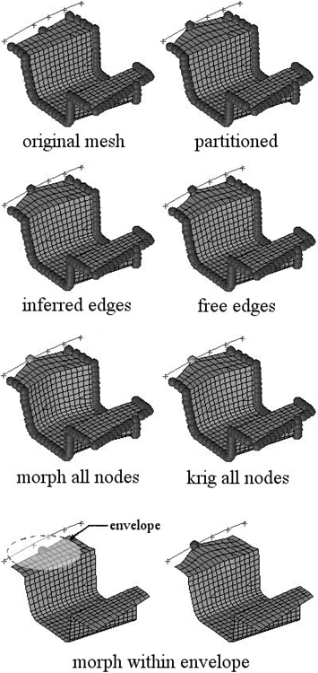

Morph Methods
Choose from the following morph methods when using the Free tool.
These options are accessed by clicking
on
the guide bar.
- Free edges
- Create a general domain for the affected elements for the purpose of applying the morphing. The movement of nodes along the boundaries of the affected elements is unregulated.
- Domain edges
- If you have already created domains via a panel or loaded a model with domains, those domains will be used to determine the way the morphing is applied to the model. Any morph area elements which aren't in existing domains are placed in a general domain. Thus, if you use this option with no domains in the model, it's the same as using free edges where a general domain is created for the entire morph area.
- Inferred edges
- Create local domains for the affected elements for the purpose of applying the morphing.
- Morph all nodes
- Using a proximity based algorithm, potentially morph every node in the model relative to the distances between the nearest moving node and the nearest anchor node.
- Partitioned edges
- Partition all of the affected elements before applying morphing.
- Krig all nodes
- Using the kriging algorithm, potentially morph every node in the model
except for the anchor nodes. Note: A practical upper limit on the number of moving nodes you can have is 3000. Computers with above average memory and CPU available may be able to support larger number of moving nodes comfortably.
- Morph within envelope
- Using a proximity based algorithm, potentially morph every node in the model relative to the distances between the nearest moving node and to either the edge of the envelope or the nearest anchor node (if selected). The envelope can either be defined as a discrete distance using the Distance option, or as a multiple of the magnitude of the perturbation applied to the nearest moving node using the Perturbation multiple option. If the Distance option is selected, this method will act identically to Morph all nodes.
