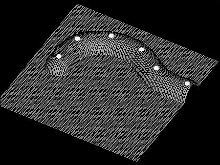

Tool shapes include ball, cone, cylinder, node list, line, plane, surface, and mesh. Use different tools to simplify the creation of different types of deformation. For example, use the ball along a node list or line list to create a curved channel with a rounded bottom and ends, but use the cone to create a channel with a V-shaped bottom. Similarly, the ball can create a hemispherical divot or protrusion, while the cone can create a conical pit or spike. The following images illustrate use of the "ball" tool to create a raised ridge along a node list.

Figure 3. Ball
In Figure 3, the ball tool has been applied to a node list.

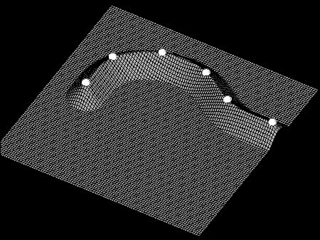

Figure 4. Cone
In Figure 4, the cone tool has been applied to a node list with an offset. The tip of the cone is moved along the node list, which, if the node list was selected along the mesh to be sculpted, will not result in any morphing. Use an offset to push the cone past the surface of the mesh as shown in the example.

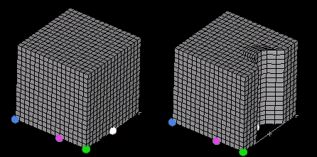

Figure 5. Cylinder
In Figure 5, a cube has been sculpted with a cylinder tool at a single point. Notice the mesh compression extending into the body of the mesh.

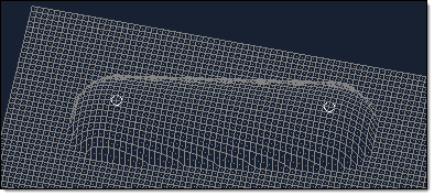

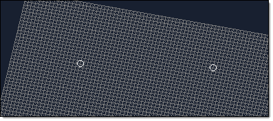

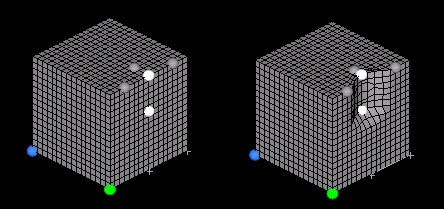

Figure 6. Node List
In Figure 6, a cube has been sculpting with a node list (gray circles) along a path (white circles).

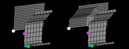

Figure 7. Line
In Figure 7, a line tool is used to sculpt a mesh. Notice how the base point (purple circle) is used to locate the line relative to the path (white circles).

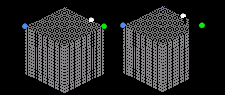

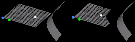

Figure 8. Plane
In Figure 8, a plane tool is used to sculpt a solid cube. A single node is used for the path and mesh compression of 0.5 is selected. Notice that the sculpt direction is different from the plane normal.

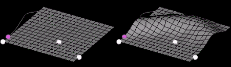

Figure 9. Surface
In Figure 9, a surface is used to sculpt a mesh. A single node is used for the path (which ends up getting morphed due to the mesh compression). Notice the effect of the taper angle (45 degrees) on either side of the tool and how it prevents large mesh distortions at the tool edge.

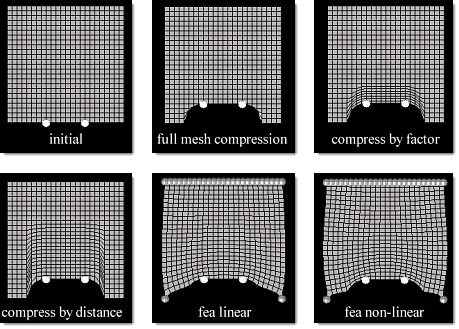

Affected Elements Select the elements you wish to be subject to the sculpting. In this way, you can preserve parts of the mesh during sculpting (by simply not picking them). Compression - By Distance
- Set a value for the distance around the tool
where mesh compression (or expansion) is
performed. If elements are compressed by the tool,
the compression will be spread out away from the
tool but only through the specified distance. In
other words, if you set a value of 30 for the
compression distance, all the mesh compression
will occur within 30 units away from the
tool.Note: Compress by factor and compress by distance work in the same way, uniformly compressing the mesh, but they differ in what they allow you to control. Compress by factor allows you to control the amount of compression per element while compress by distance allows you to control the area within which compression takes place.
- By Factor
- Set a value between 0 and 1. The relative amount of compression (or expansion) which can be applied to the affected elements before the sculpting is "passed on" to neighboring elements.
- Full Mesh Compression
- Do not preserve the spacing between the nodes for any affected element. Elements may end up getting squashed flat.
- Use FEA linear or Use FEA Nonlinear
- Choose either auto props or user props. Select
user props if you have added properties and
materials to your model appropriate for the type
of analysis to be performed ( OptiStruct or Radioss) and want to use those
instead, otherwise select auto props. Then select
the fixed nodes for the sculpting. HyperMorph will perform an FEA
solution using either OptiStruct or Radioss to determine the
deformation of the affected elements using the
nodes affected by the tool and the fixed nodes as
enforced displacements.Note: Non-linear analysis, while more time consuming, is more appropriate for extreme mesh compression conditions and generally results in better element quality compared to linear analysis.
