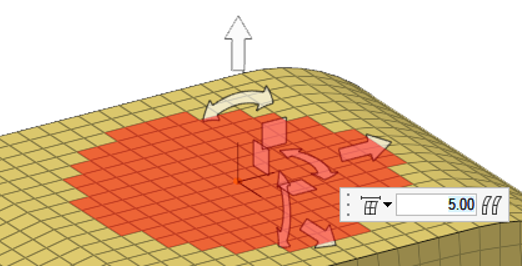

Review the proximity-based morph area around the moving entities (red colored
mesh), and use the microdialog to adjust it as
needed.

- When selecting nodes, faces, or edges: Move entities freely using the
Move tool (see manipulator options below).
- The position of the Move tool is set at the center of the selected entities. Selecting new entities updates the position of the Move tool. Double-click the Move tool to reposition it manually.
- The position of the normal offset arrow is set at the center of the selected entities. Click anywhere on the selected entities to reposition the offset arrow to that location.
