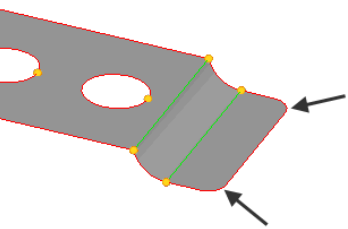

An edge fillet is a part of the trimming loop of a surface that can be roughly equivalenced to a circular arc.Figure 2. Edge Fillets
