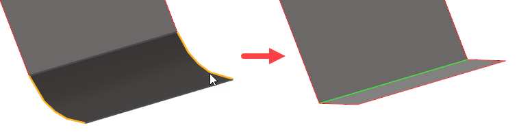

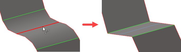

Tip: You can also select surfaces manually without using automatic detection. If you have already used the Features tool to detect fillets, you can change the entity selector on the guide bar and select them directly as well. - Optional:
Select lines that a fillet should ignore.
- Optional:
Select lines which make up the end of a fillet.
